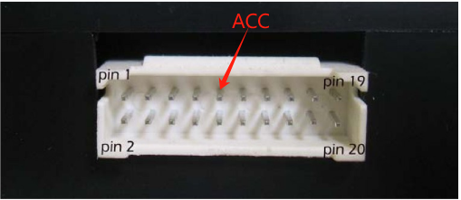

                VishBK You can try to update the MCU. You need to connect the ACC line of the CANBUS box to the AMP CONT of the A connector.

                          dudu-lai My harness did not come with an exposed ACC wire.
