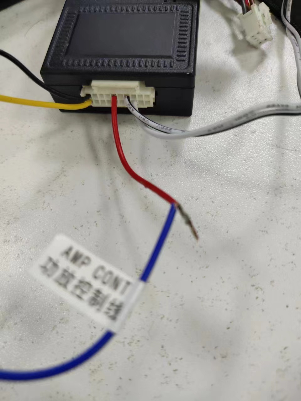

VishBK Have you connected PIN9 on the CANBUS terminal to the AMPC cable?
Do you have a photo?
    dudu-lai Yes, but I put it back into the CANBUS harness because I needed sound.

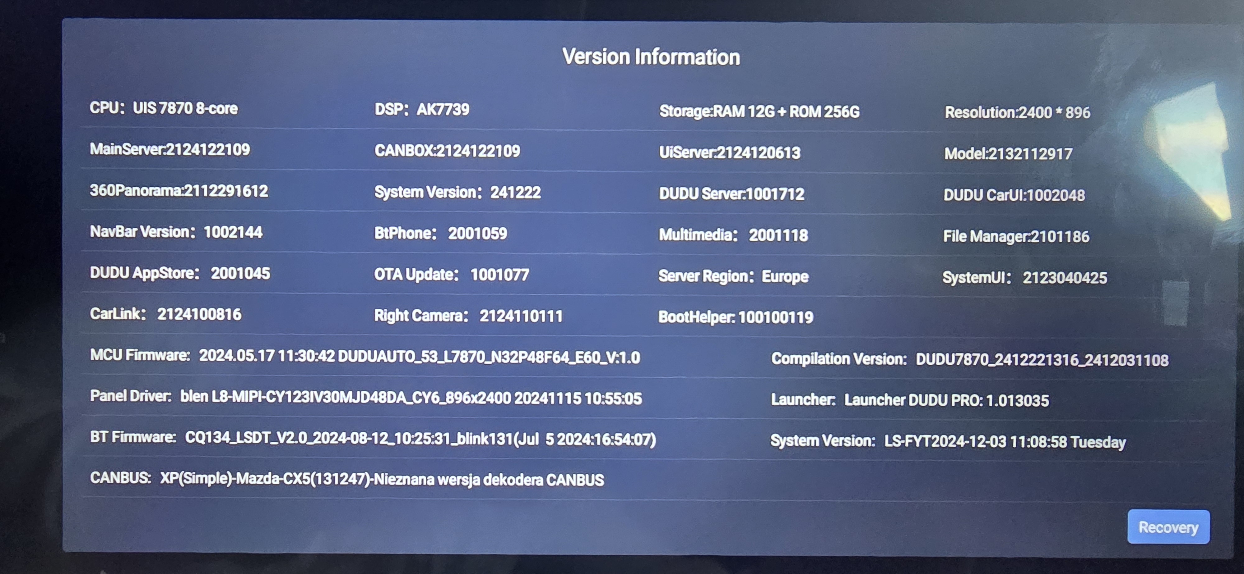

        I am using a DUDU7 head unit in a Mazda 6 GJ with BOSE amplifier. I experience a "click/pop" sound in the speakers (especially the center speaker) during device startup and reboot. This issue happens regardless of power or wiring configuration (AMP CTRL wire is stable at 11.2V). I have tried several grounding methods, RCA rewiring and filtering, but the click persists.
        I saw on the DUDU forum that some users had similar problems and received a new MCU firmware version which helped eliminate the click/pop.
        Could you please help me with that as well?
        Here are my MCU/firmware details:
        Let me know if you need any additional information. Thank you in advance!

          dudu-lai Yeah I have it connected directly into the connector without cutting the existing wire.

              Nestoranto You need to upgrade the MCU, please check the solution mentioned in the appeal
                VishBK After the MCU is upgraded, the AMP C cable releases voltage to the system after 5 seconds to allow the CANBUS junction box to operate.
                If PIN 9 controls sound. Then it should take effect when the AMP C cable is plugged in.

                        dudu-lai Ok, I updated the MCU. The click only appears when restarting dudu. Thx.
                          Nestoranto Is the problem solved?
                            dudu-lai Yes, thank you. The click remains only when restarting the radio, but I understand that you will fix it in the future.

                              dudu-lai After trying again to connect the AMP C cable to PIN 9, the sound works and I can hear a longer delay before the amplifier kicks on. (Anything above level 40 on the amplifier volume white noise can be heard from the speakers). However, the popping sound is still heard if the device wakes up from a shutdown (like setting the shutdown instead of sleep option in start settings).
