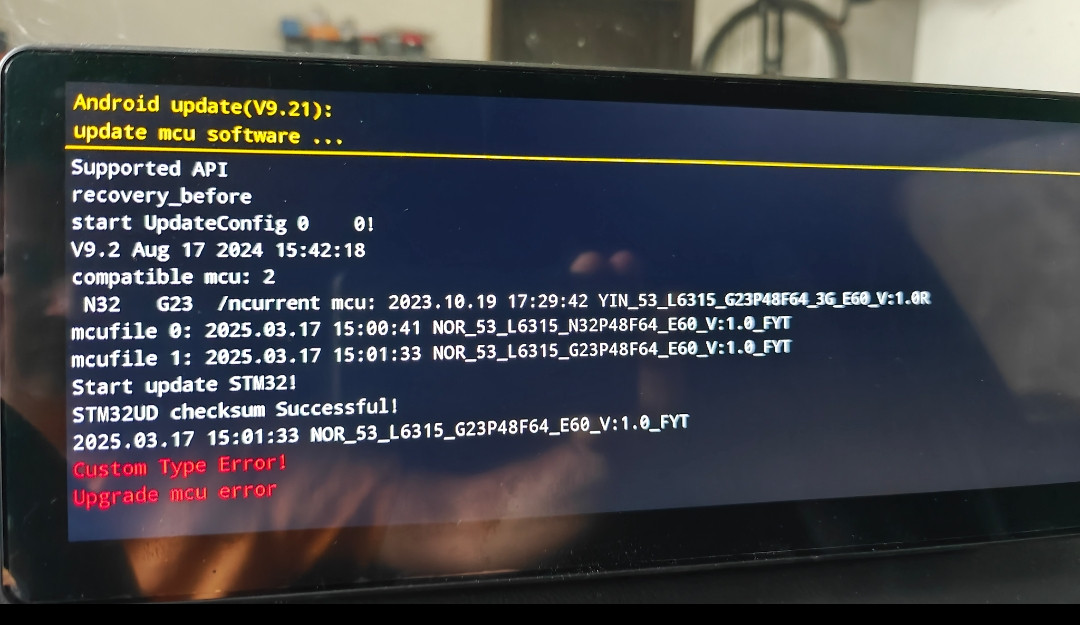

                  I also have this popping sound on a Mazda CX5 2019. My unit is specific to my car which I have DuduOS3.6 beta 5 installed and the original Mazda OS.
                  Is it save to update with the Dudu MCU in this thread so I can give it a try?
                  My MCU
                  2023.10.19 17:29:42 YIN_53_L6315_G23P48F64_3G_E60_V1.0R
                  Are there any other improvements to this MCU besides the 5 sec amp delay?

                      Thanks for the support. Unfortunately I am unable to update the MCU with the provided one in this thread. And yes, I am using the correct Dudu 4/5/6 version as my unit is a 7862 based unit running official DuduOS 3.6 250515

                        jpapadami Did you purchase the device from the official DUDU or did you install DUDUOS on the 7862 public release?
                          dudu-lai
                          I installed the public release.
                            jpapadami The public version cannot update MCUs belonging to DUDU.
                              dudu-lai
                              Thank you for the info.
