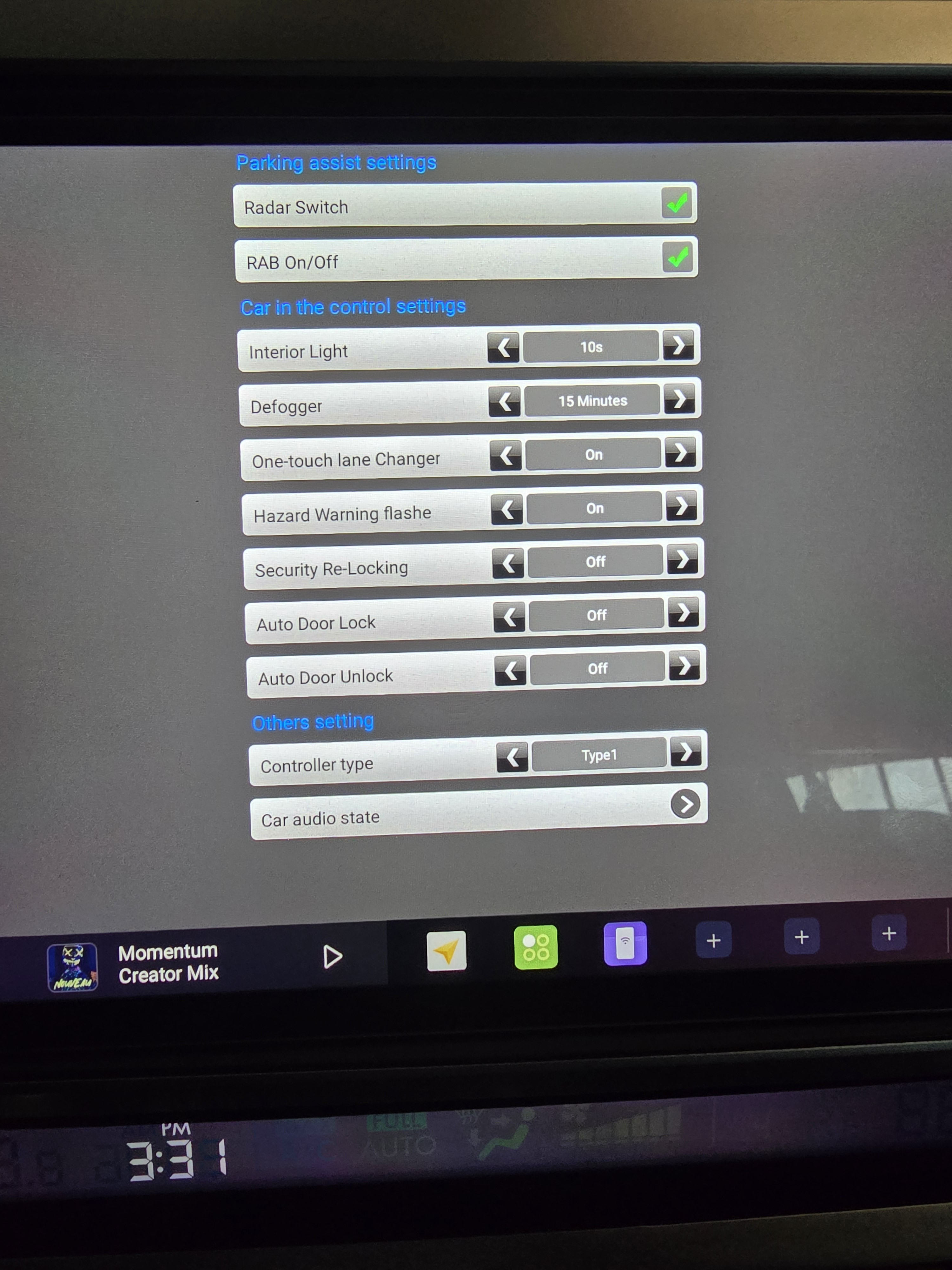

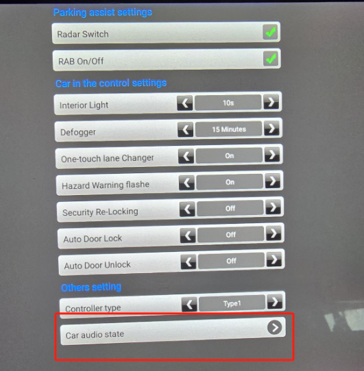

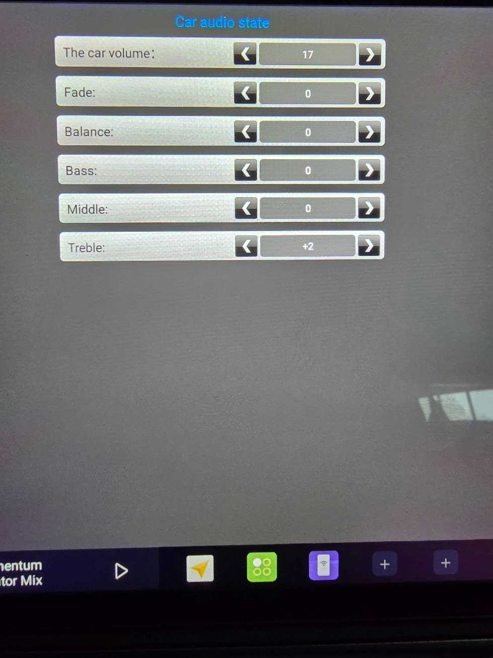

                              so you are basically trying to control the powering of the oem amplifier using the C control cable. my CANBUS options do not show this power management control for the amplifier. see attached pictures. the hardware i am using is simple soft xp. I will have to take the headunit apart again to try this, please confirm . (side note , since i lasted posted , I updated the headunit to 3.5 beta 3. did not solve any of my issues. so i factory reverted back to 3.5 december release. so right now the unit is in clean state no mods.

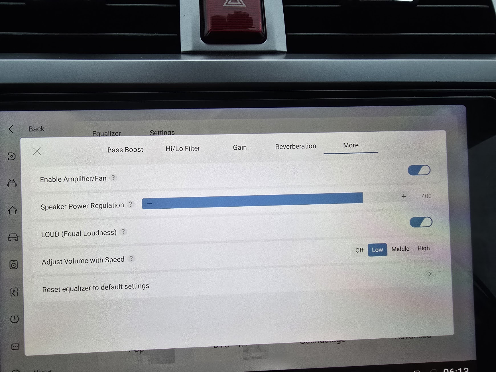

                                Bradha333 Same issue with my subaru 2017, you have to keep the volume super low or your speakers start crackling, and they can get damaged. This is definitely an issue with double amplification. i have lowered the power output dudu7 amp is using but then then issue is the sound is too low. and some songs with different audio levels come at a ok level, others you cant hear and then you get one that blows your speakers. This also creates additional issues if you enable sound profiles. or have the road noise based audio correction features on. I think the answer here would be to be able to disable the Dudu7 internal amp. This is something i have done with other android based headunits in the past which has solve this issues, allowing you to still use equalization and pass the signal to the OEM harman kardon amplifier without pre amplification on it. but i have not found any way to disable the internal dudu7 amp. just lower its sound output which is still pre amped.
                                Maybe someone here knows if there is a way to disable the internal amplifier, and another benefit of that is lower temperatures on the dudu7 itself which is a plus.
