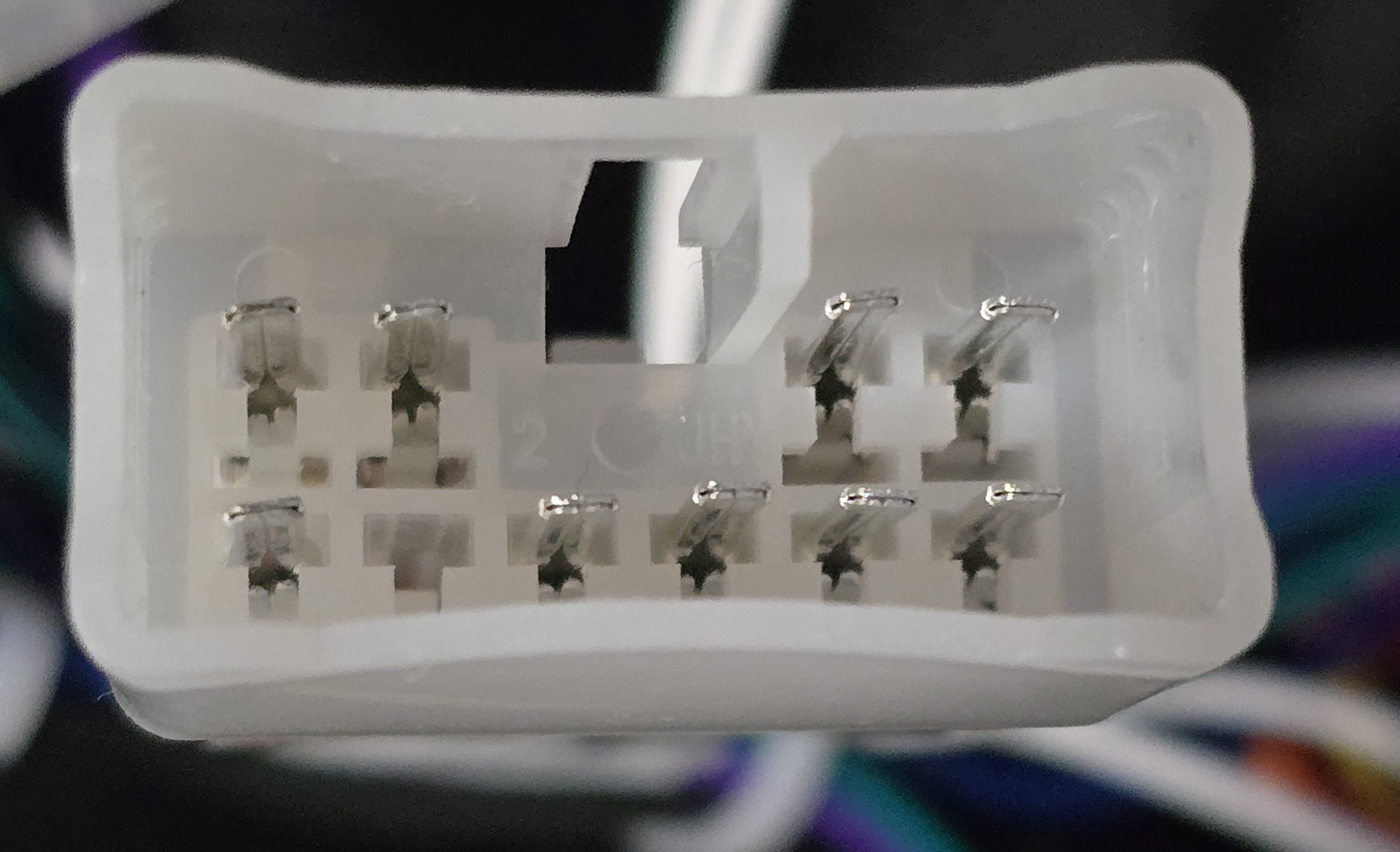

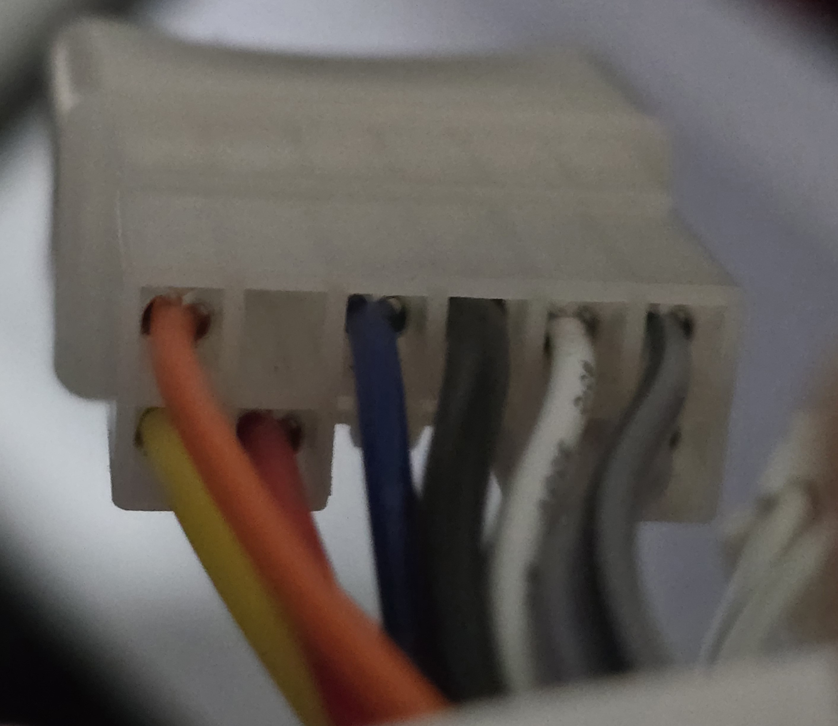

                    dudu-lai I have connected the Amp control cable to the AMP C harness cable on my subaru outback 2017 with OEM harman kardon amplifier. and also applied the MCU Updates from here. https://drive.google.com/drive/folders/1QHfKsoY7tsgg4Bls8ezOjKWCTBwZ5NNy?usp=sharing
                    The noise still happening during Dudu OS boot. do i need to also install the APK for jeep. or can you provide me with the one compatible with subaru? sharing here my dudu info. and a picture showing the connected amp cont cables
                    Thanks for your support!
