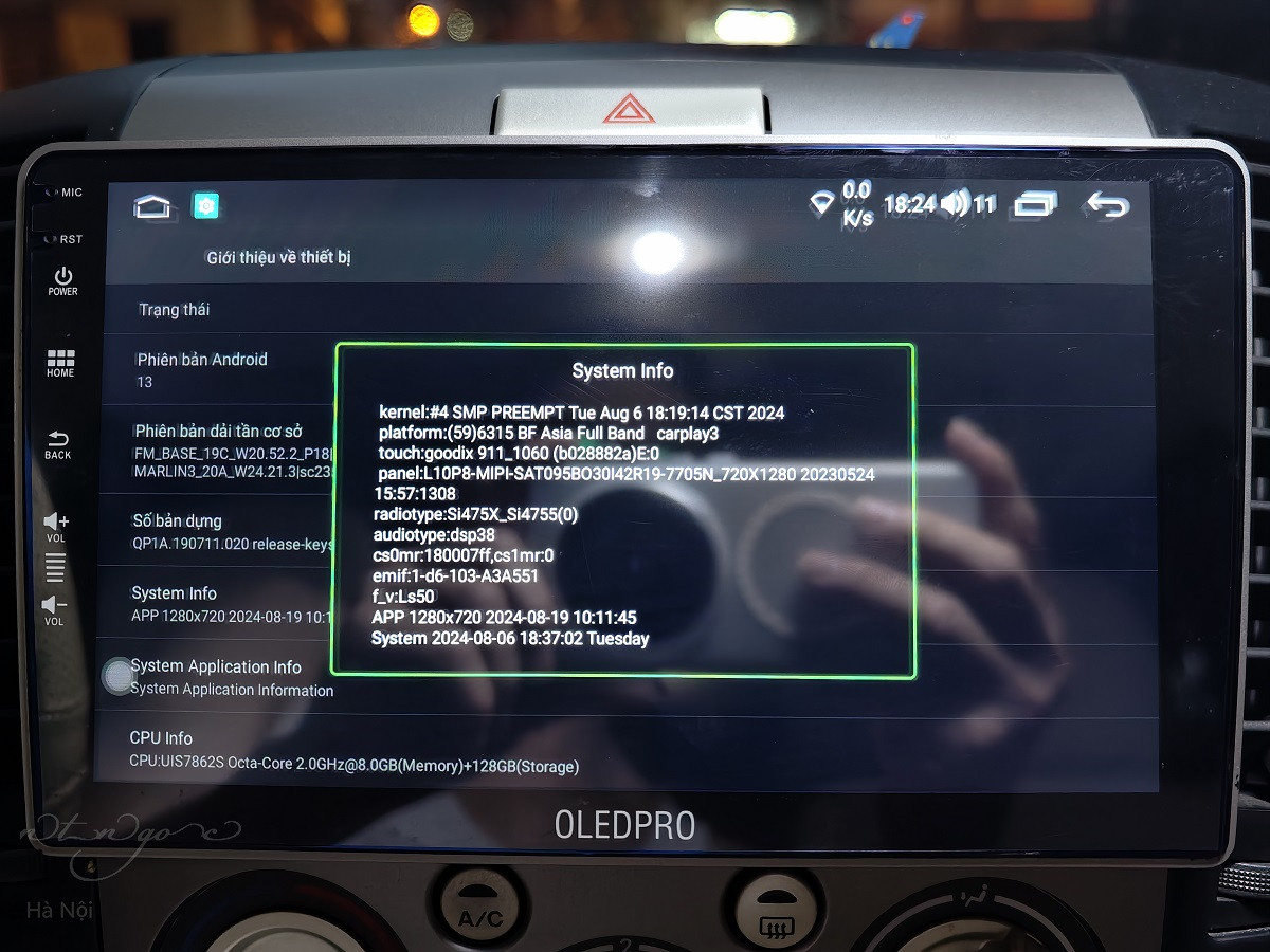

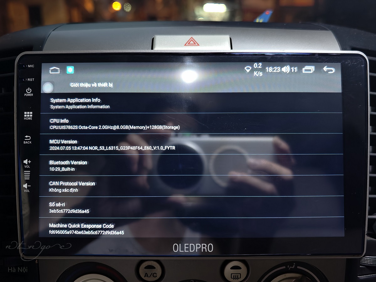

ledinhson da2001 Me too. And I have a minor bug more, my screen is 10.1 inch, but DUDUOS UI is not fit all my screen, there's a blank at the bottom of my screen. I have also this problem with 3.6 beta 2 version.
MihaiFlorin ledinhson If you don't provide your details as in here https://forum.dudu-auto.com/d/14-how-to-give-correct-feedback-on-bugs will be very difficult for anybody to help you.
Christian_S ledinhson Hello,go to settings, vehicle settings, factory settings, pwd 108, touch, adjust display area, drag bottom seting to right and back to left and confirm. Leave here a reply if this helps. Regards,
DUDU-Meng ledinhson You should have the 7862 model, which is designed this way, with the bottom reserved for the
