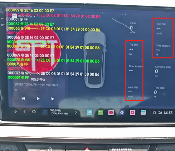

Popescu dudu-lai I Install apk, ac work whitout problem, the only issue is with trip info. Is the same problem, appear and disapear. Thank you for your support and patience. https://www.transfernow.net/dl/20250701sz9cg86z
Popescu dudu-lai Hi! Today appear error. I made a video if helps. Thanks https://www.transfernow.net/dl/20250702nhxclMGC

Popescu dudu-lai 1. Regarding the trip info, is any solution? I sent the video few days ago I noticed the theme doesn't change by lights. The unit not recieve information from canbus regard lights, Park brake. Thanks!
dudu-lai Popescu Is this what you call traveling? The issue with the lights switching between day and night modes will be fixed in the next release
