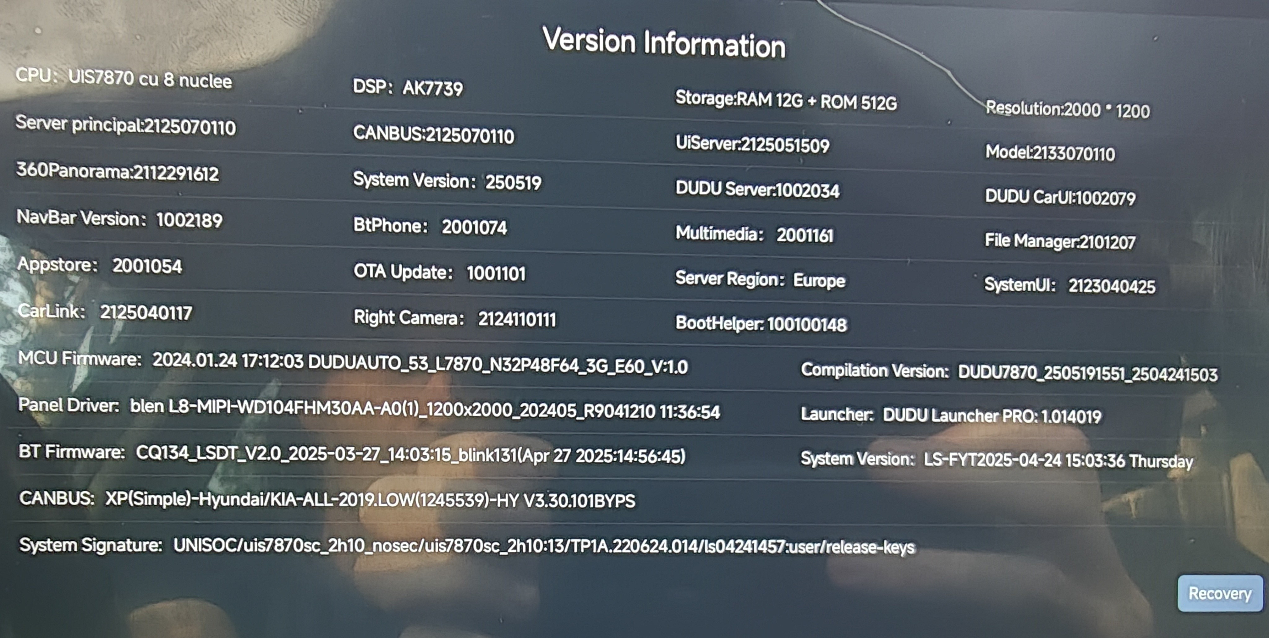

dudu-lai Popescu Sorry, I'm on vacation for two days. Brother, please provide the version information of DUDU, I want to confirm whether the apk I provided is installed successfully.
dudu-lai Popescu https://drive.google.com/file/d/14rLVjAnCHX5nJ_ywc2GRErLqkNmJrhx4/view?usp=sharing New software, if the problem is not solved after installing APK Canbuslog txt file is required
