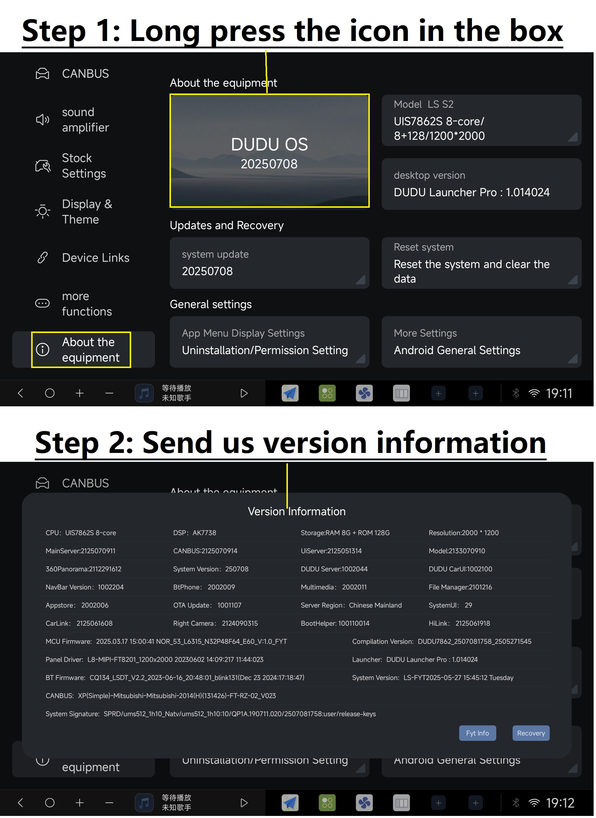

3: To provide system information, Settings - About - long press the top left corner of the image - send us a screenshot of the popup message!

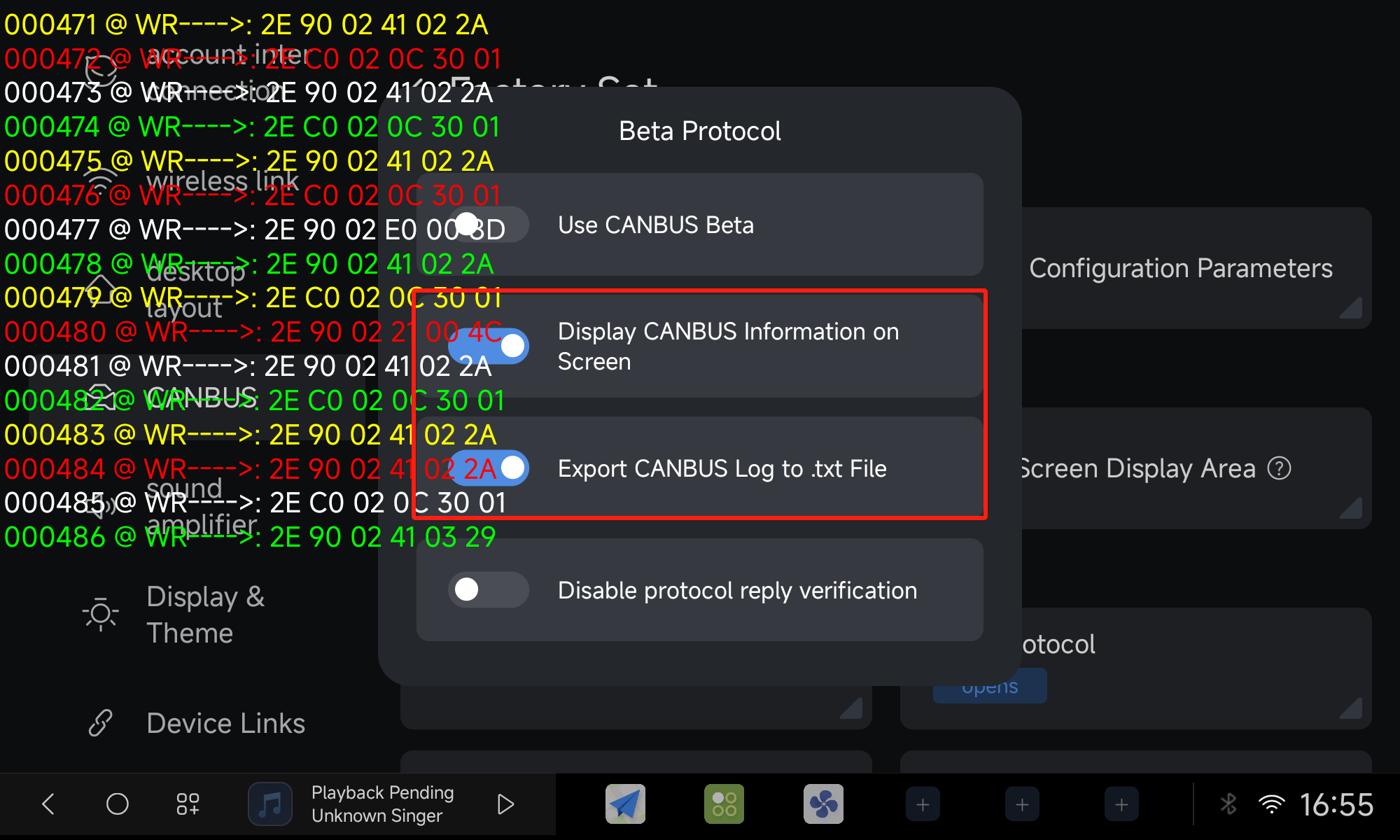

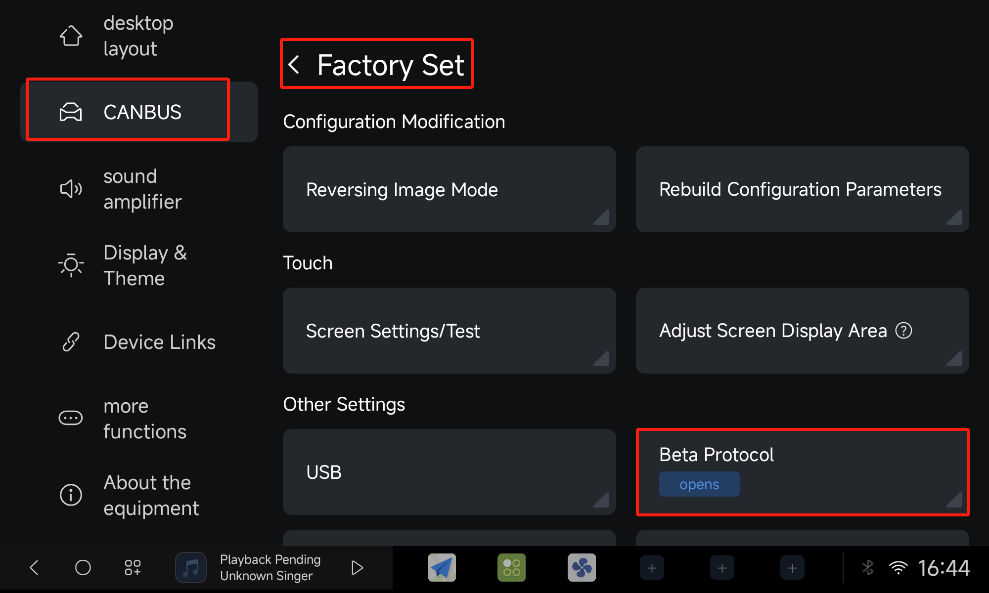

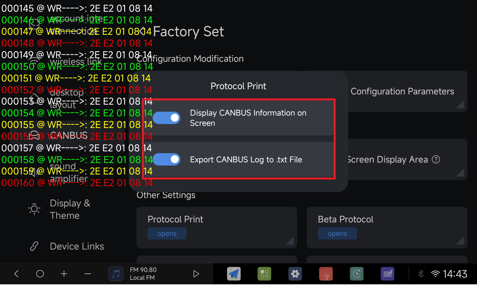

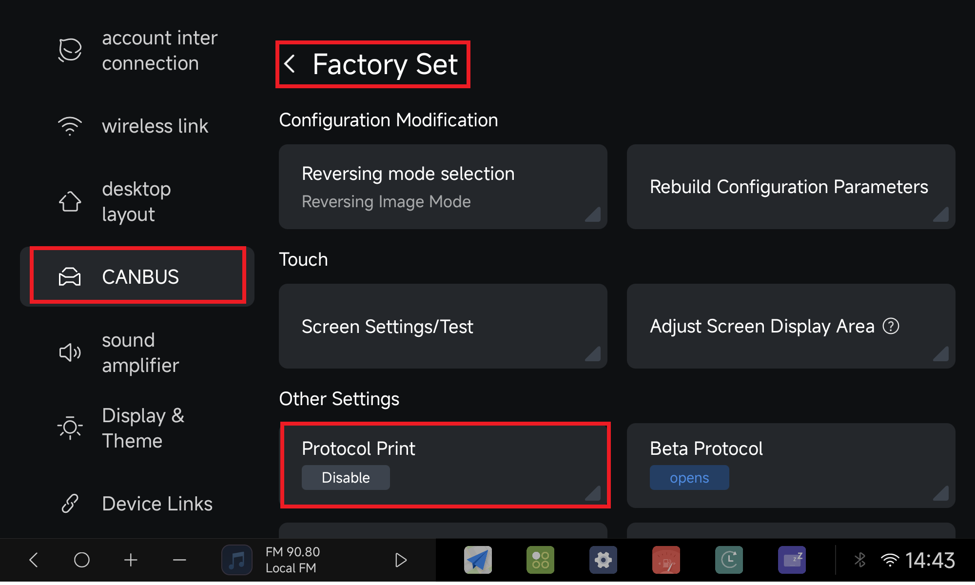

1: Settings - CANBUS - Factory settings - Password 108 - Beta protocol
Turn on displaying CANBUS information on the screen and exporting CANBUS logs to .txt files
give an example
