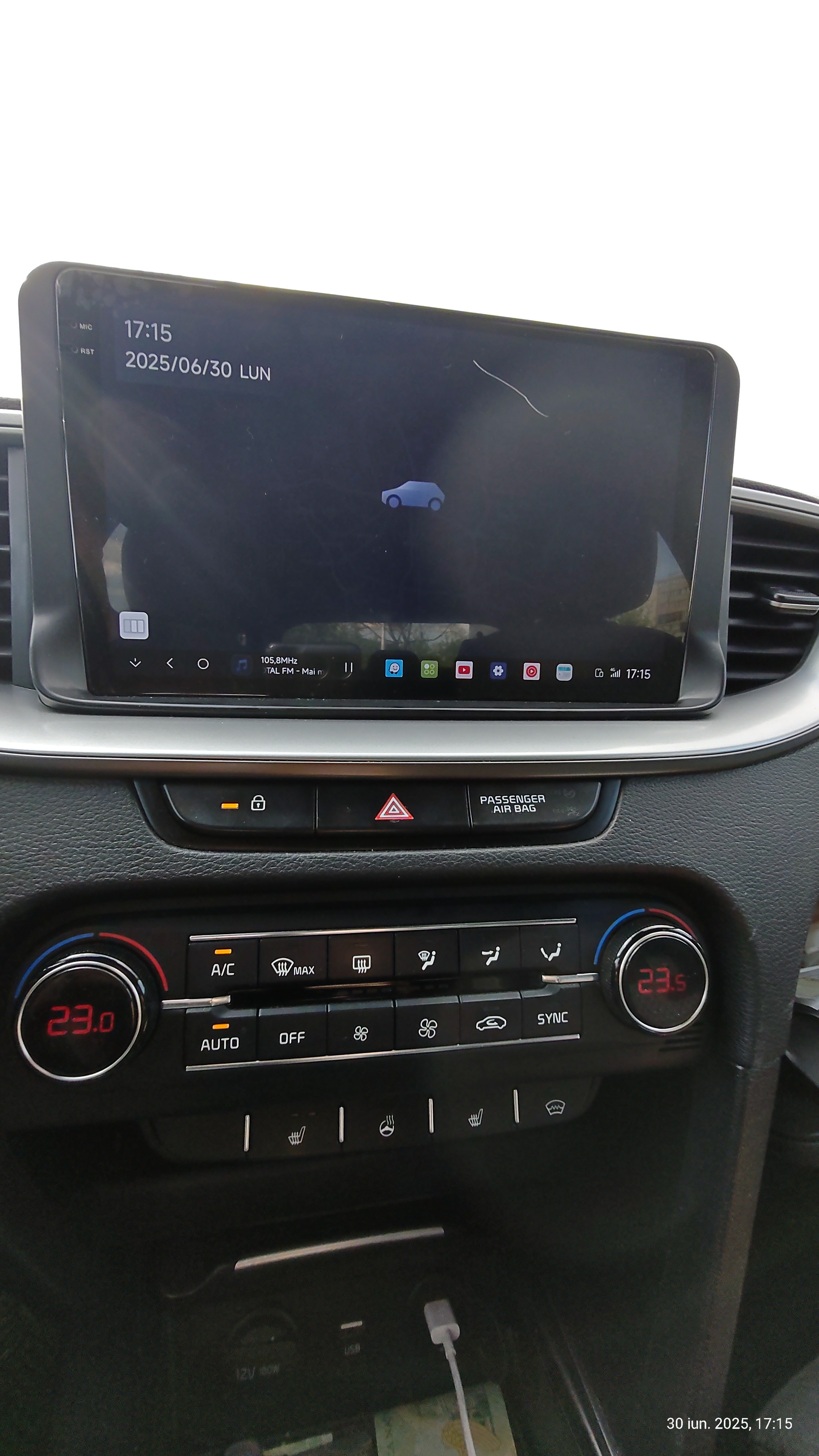

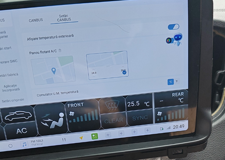

Popescu Hello! I have Dudu 7 and there is a diference of temperature on ac system and unit display by 2 degrees. I s something i can do? Thanks!
Popescu The car is Kia Xcced 2020, can box is Simple Soft HY-SS-04. I select different kind of cars from list. All the same, 2 degrees diffrence. Now i have select XP/kia/all models/low 2019. Thanks!
Popescu I try, it was check, i uncheck and check again with restart, same thing. Otherwise everything work, i just want to anounce this.

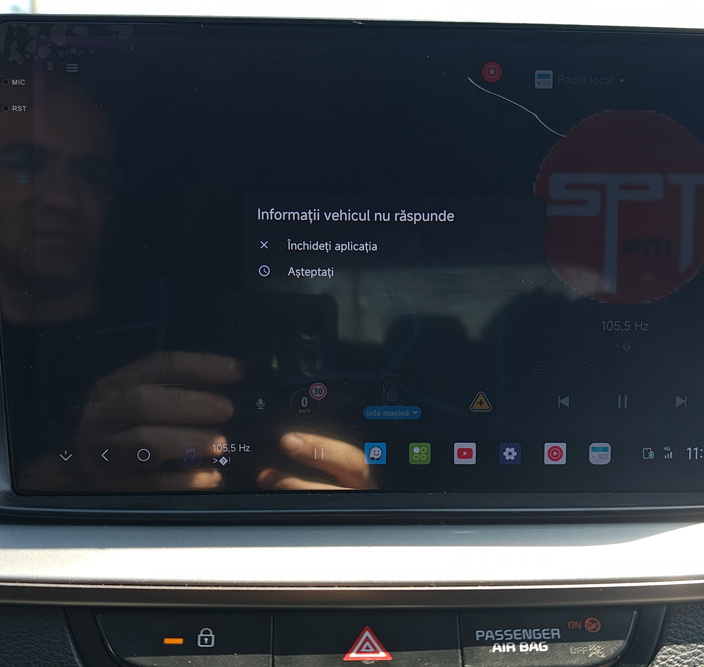

Popescu dudu-lai I record the video and i noticed another issue. Trouble with diffrence of 2 degrees The information in the "trip info" menu is intermittently displayed https://www.transfernow.net/dl/20250630ZjbPS9Ob https://www.transfernow.net/dl/20250630BrJGBL34
Popescu And i noticed on screensaver it don't appears 3d car. I don't know of is a problem or this is the image. Thanks.

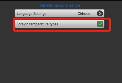

dudu-lai https://drive.google.com/drive/folders/1g4ZD9gSC-SK-xywMbgG5IWYi7Y9t9j9j?usp=sharing Hello, the temperature problem has been fixed, please install the 3 APKs in the link

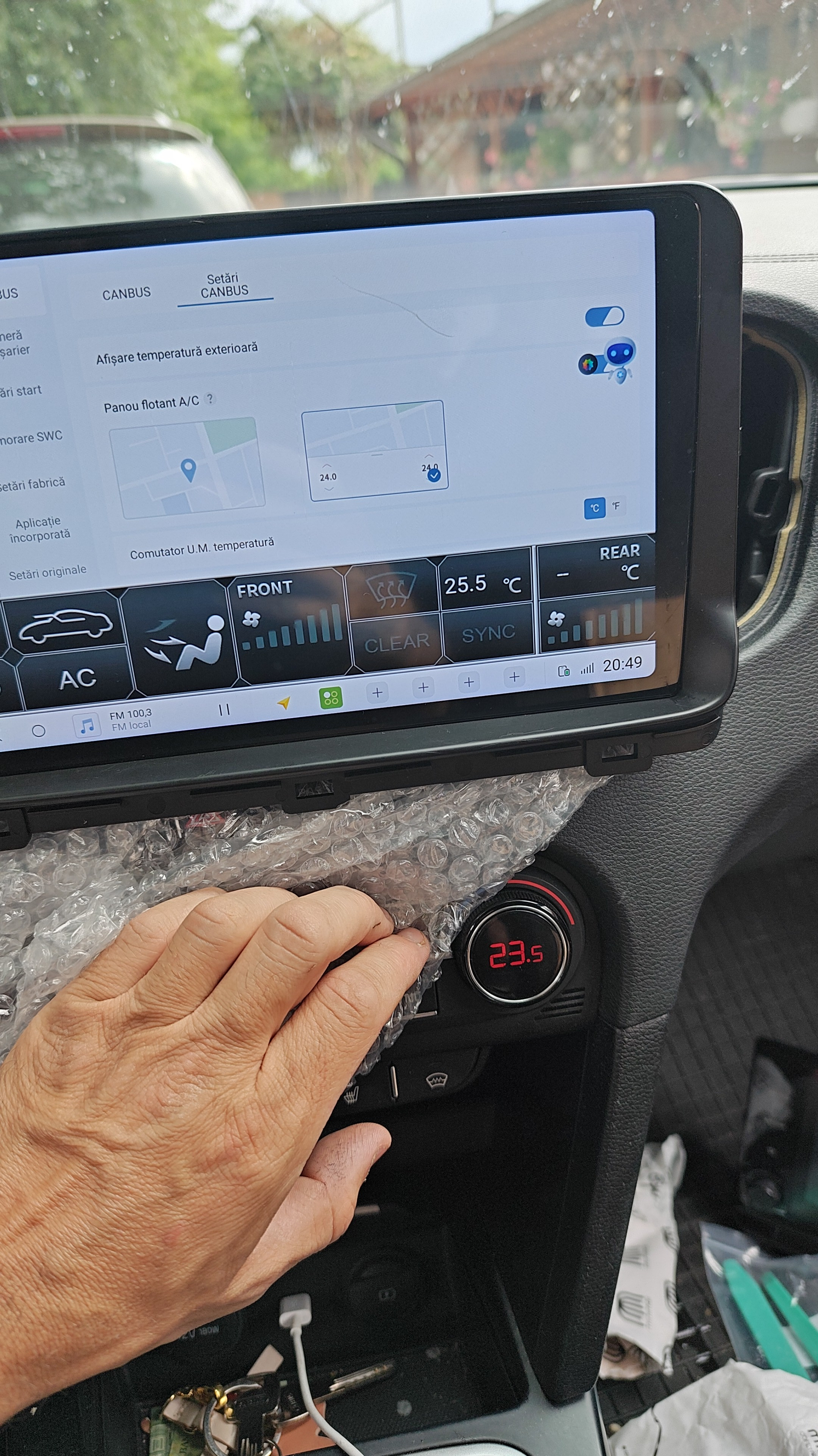

Popescu I have Install the apk's, the 3 model car is solved, the diffrence temperature is the same 2 degrees. I restarted head unit 2 times. Thanks! With the information on trip info appear/desepaer is any solution?
dudu-lai Popescu Temperature issue not resolved? Try again using this air conditioning interface and turning on this setting. Itinerary issue is being analyzed
dudu-lai Popescu Hi, I have uploaded a new APK, after installing it please set the temperature difference to -4. This APK also fixes the trip issue, please try it! https://drive.google.com/file/d/1M7KT8DeDGsMdAyXsbFtxGnRpkaQ3VzgS/view?usp=sharing

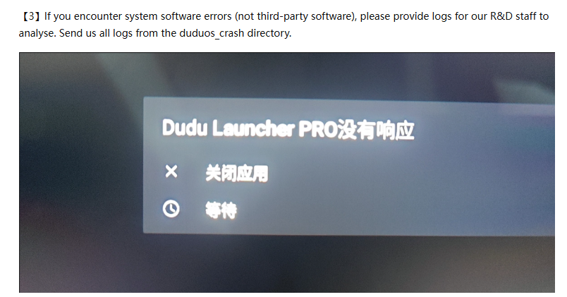

dudu-lai Popescu Please refer to this thread for feedback methods and provide us with error logs. https://forum.dudu-auto.com/d/14-how-to-give-correct-feedback-on-bugs
Popescu dudu-lai I Install apk, ac work whitout problem, the only issue is with trip info. Is the same problem, appear and disapear. Thank you for your support and patience. https://www.transfernow.net/dl/20250701sz9cg86z
Popescu dudu-lai Hi! Today appear error. I made a video if helps. Thanks https://www.transfernow.net/dl/20250702nhxclMGC
