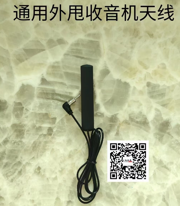

                          You can purchase an external antenna to use with the DUDU radio
                            dudu-lai Thanks, where would this plug in?
