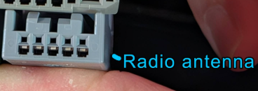

    Thank you for the information on FM radio. These are the unused connections from my stock head unit. The green one might be the radio though I am not 100% sure.

              Finally I did some testing for the unused cables...
              • When I unplugged the big grey one it removed power from the OEM head unit.
              • When I had the radio on I unplugged the small grey one and lost signal. Plugging it back in restored FM radio.
              • The green cable might be the OEM microphone, but I didn't test a phone call because it doesn't matter.

                      dudu-lai the radio does not work. Please see a previous post where I mentioned one of the unused cables good to the radio antenna.

                          The radio app does not do anything. This unused connector is what goes to the radio antenna.
