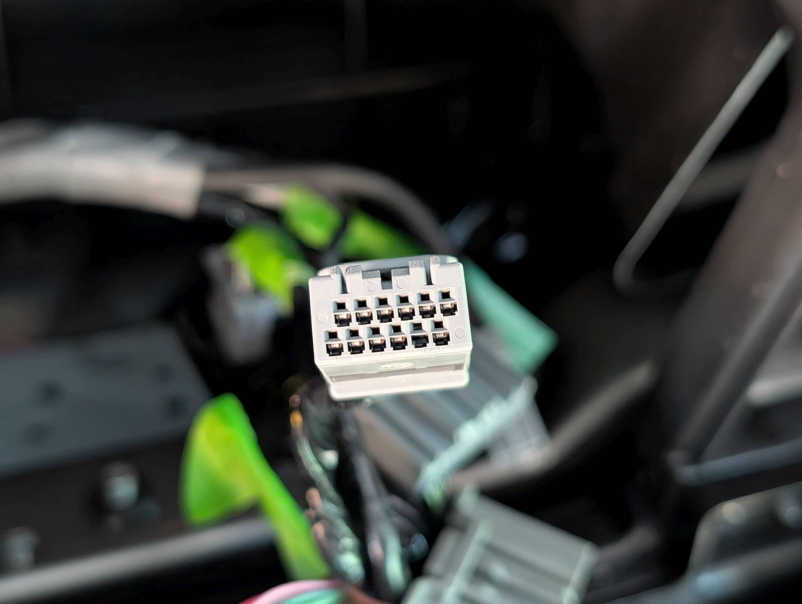

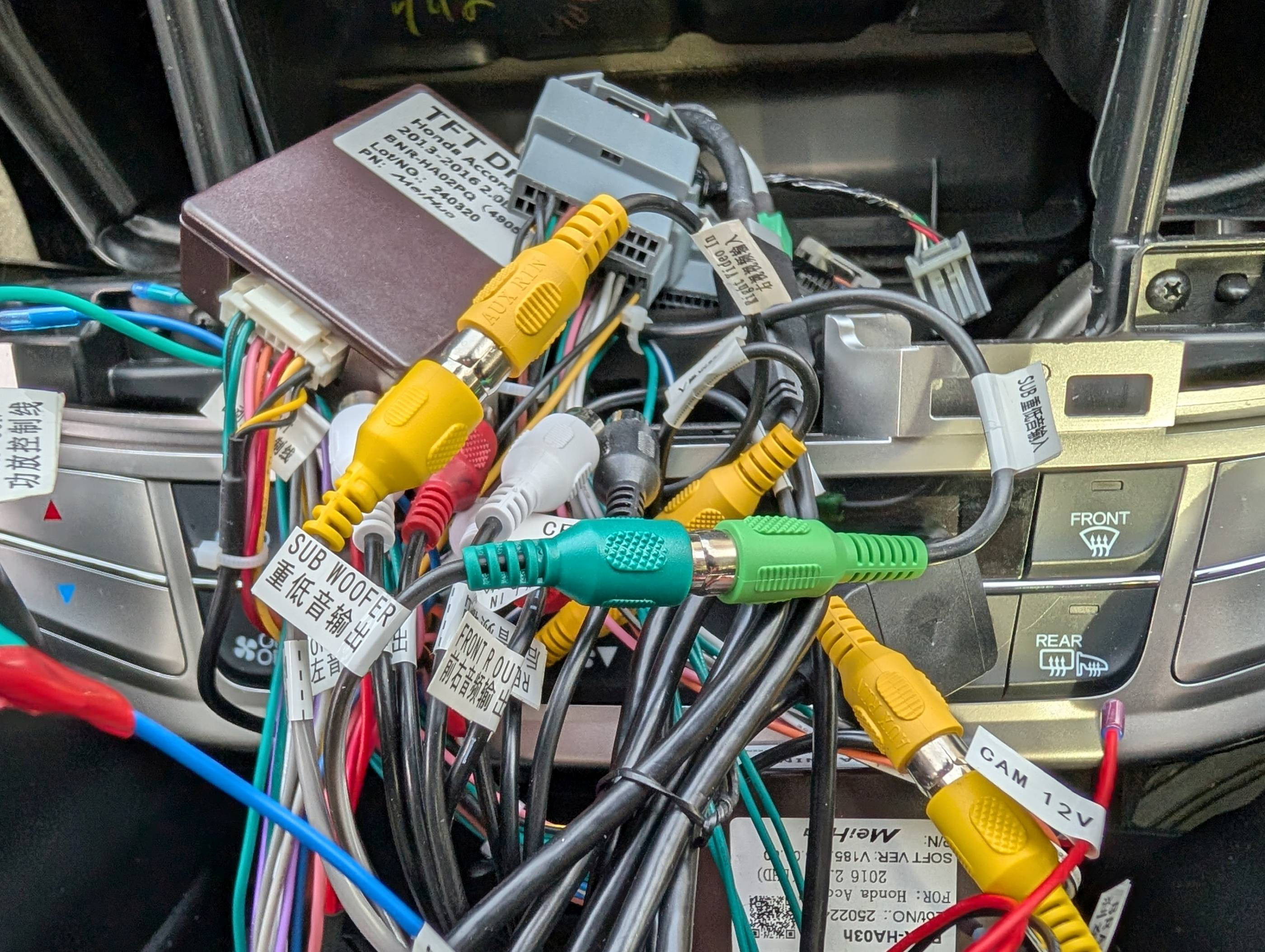

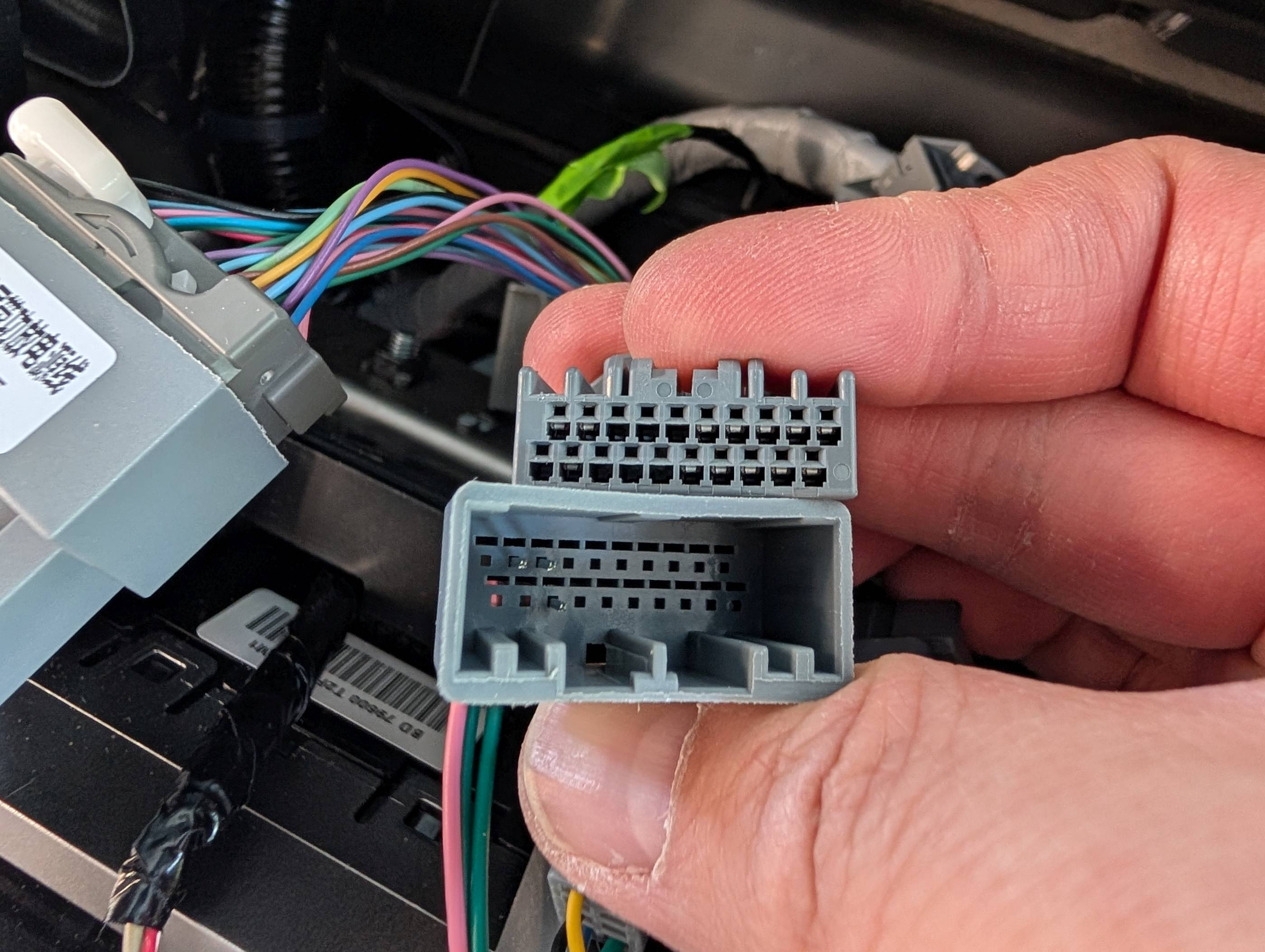

I've run into a few issues since installing my Dudu7 for my 2015 Honda Accord EX-L V6.

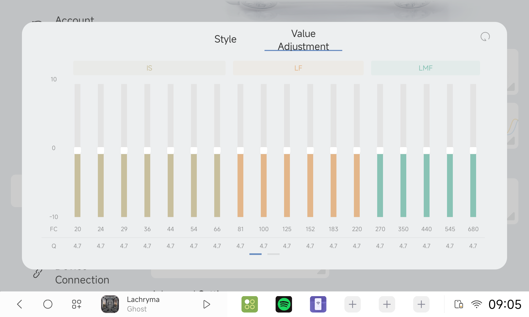

- Subwoofer does not work

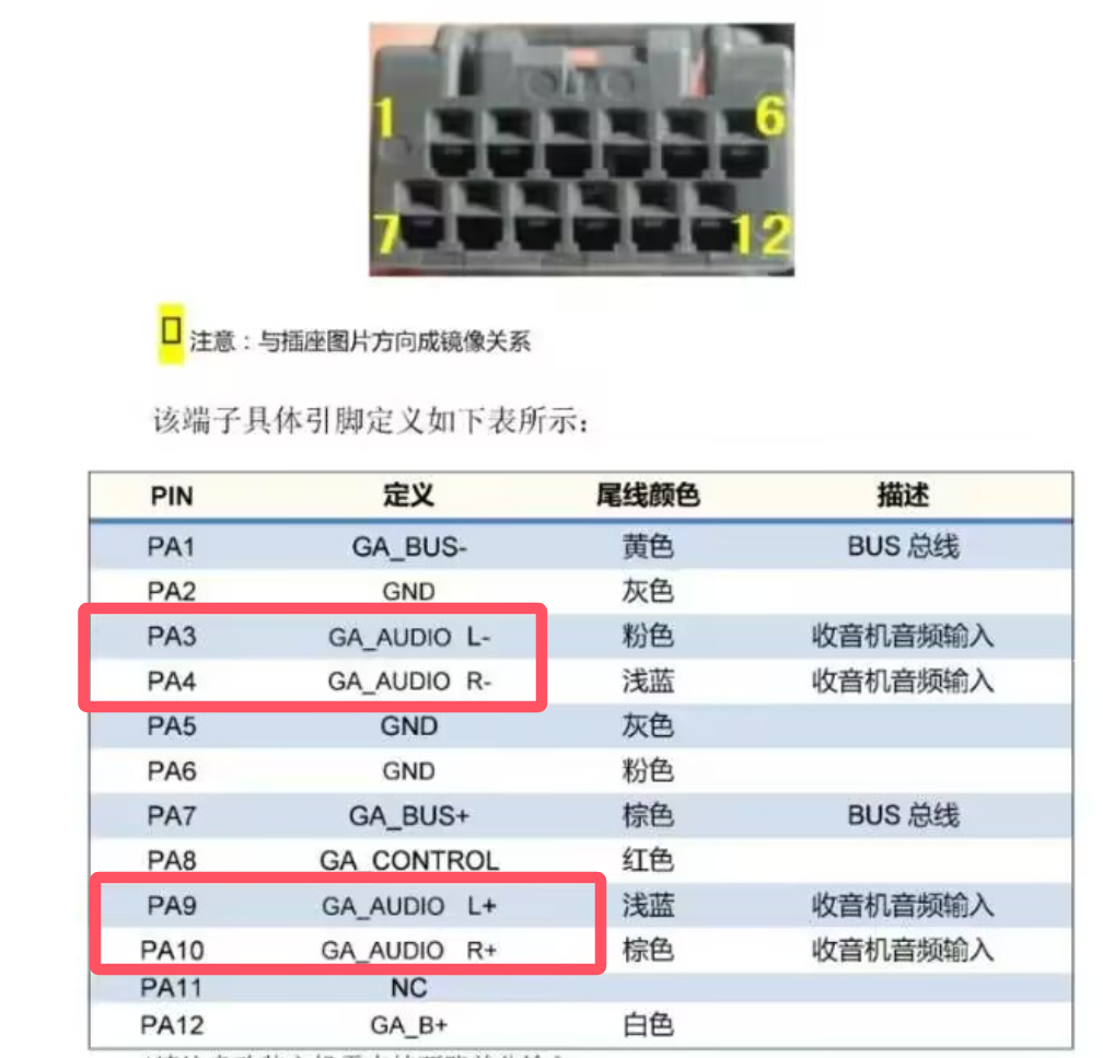

- FM radio does not work
- Bluetooth connection on my phone constantly disconnects/reconnects causing audio stuttering in Car Link

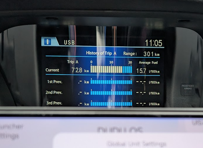

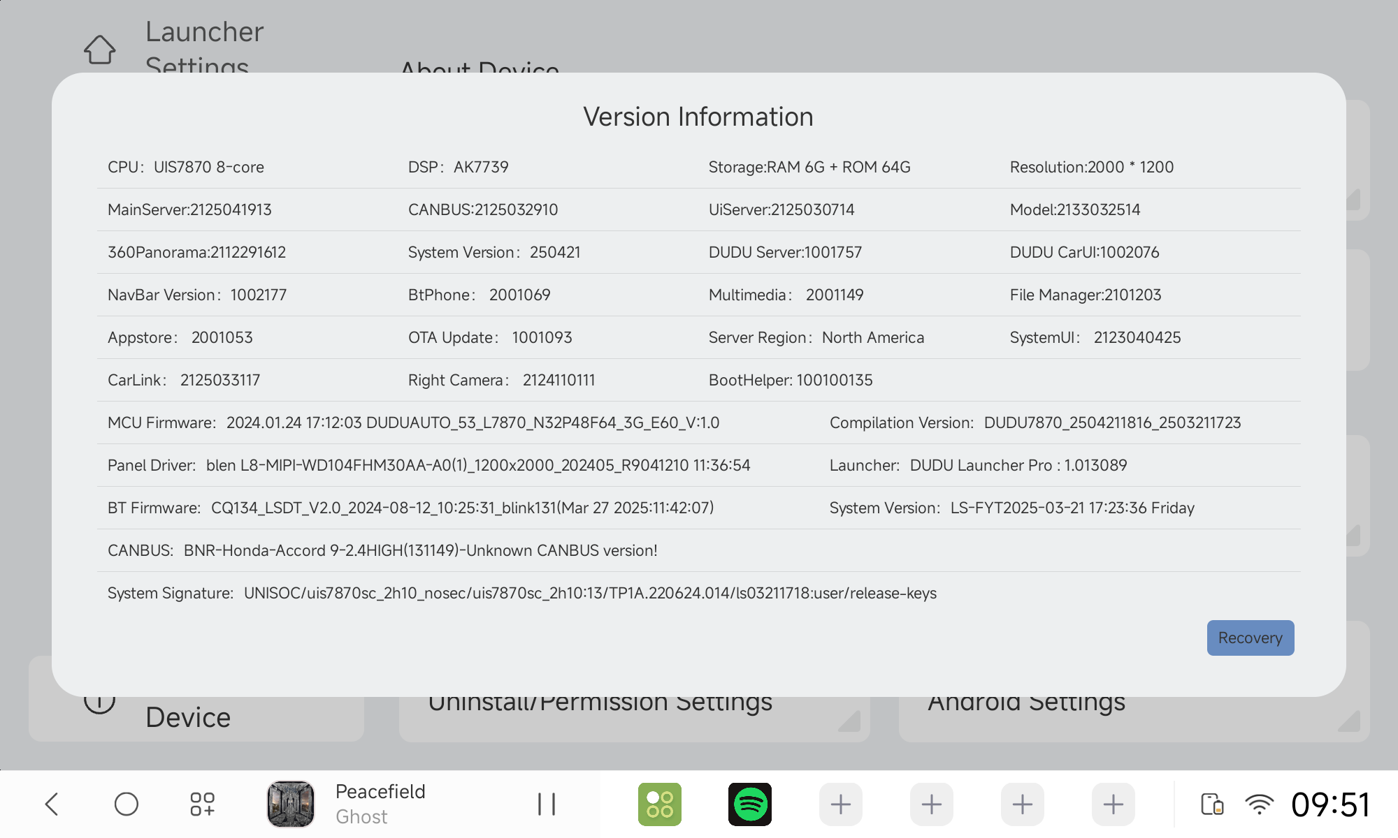

- The top screen measures length via kilometers instead of miles

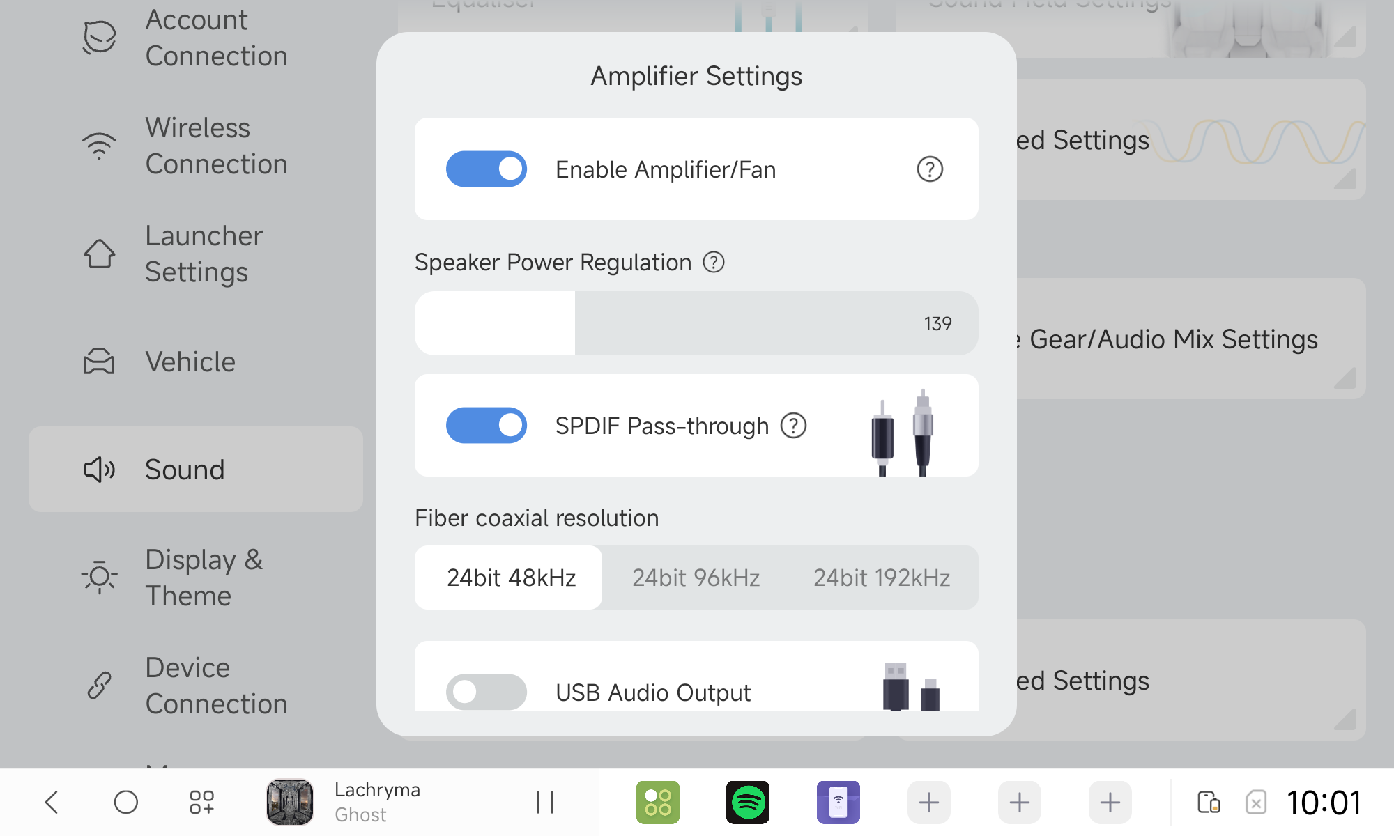

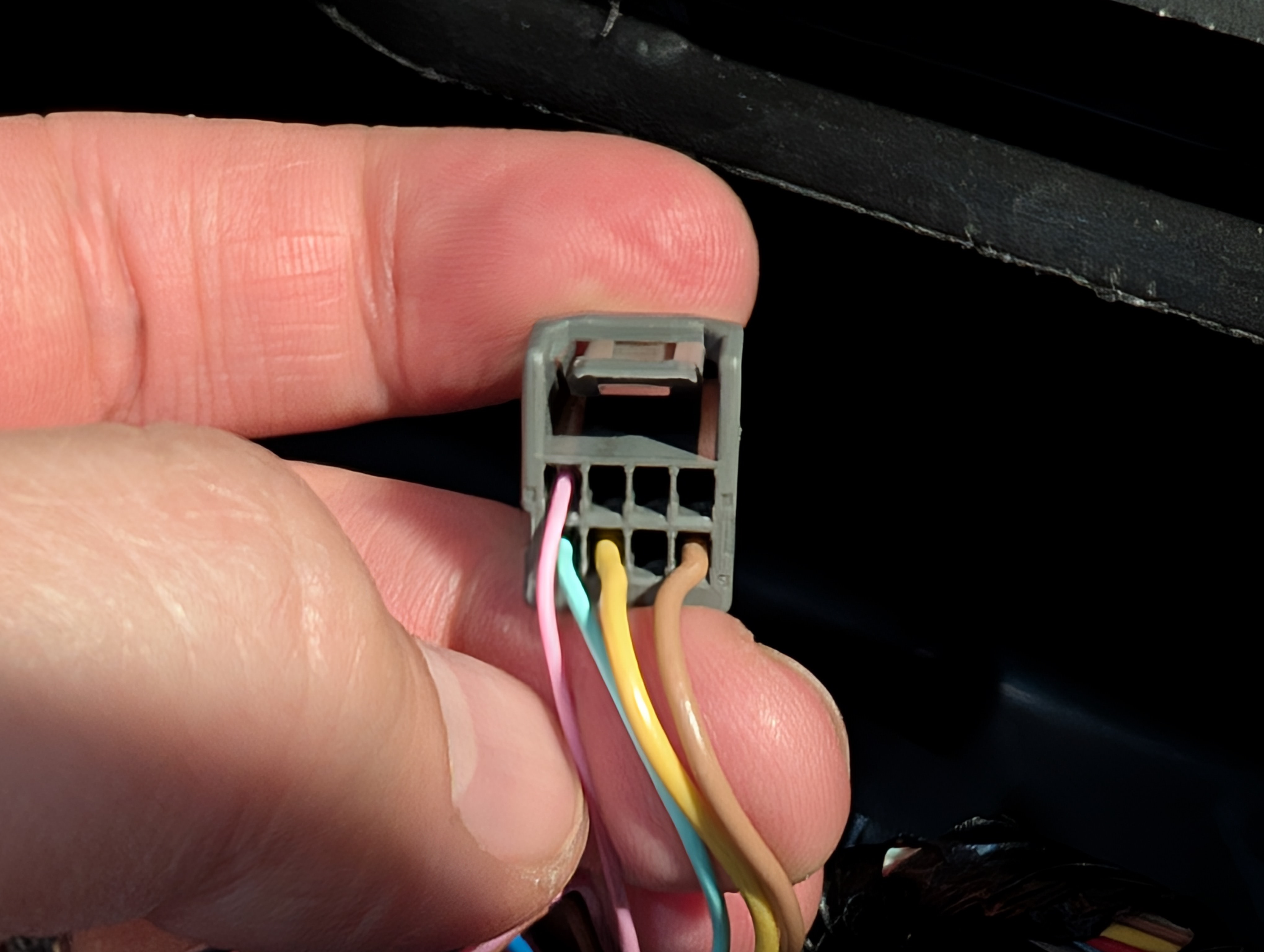

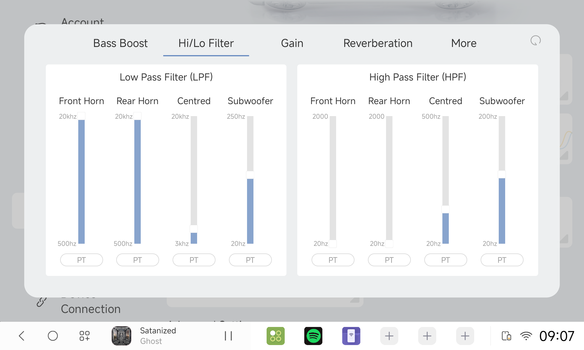

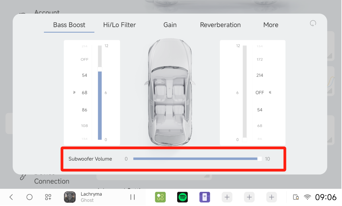

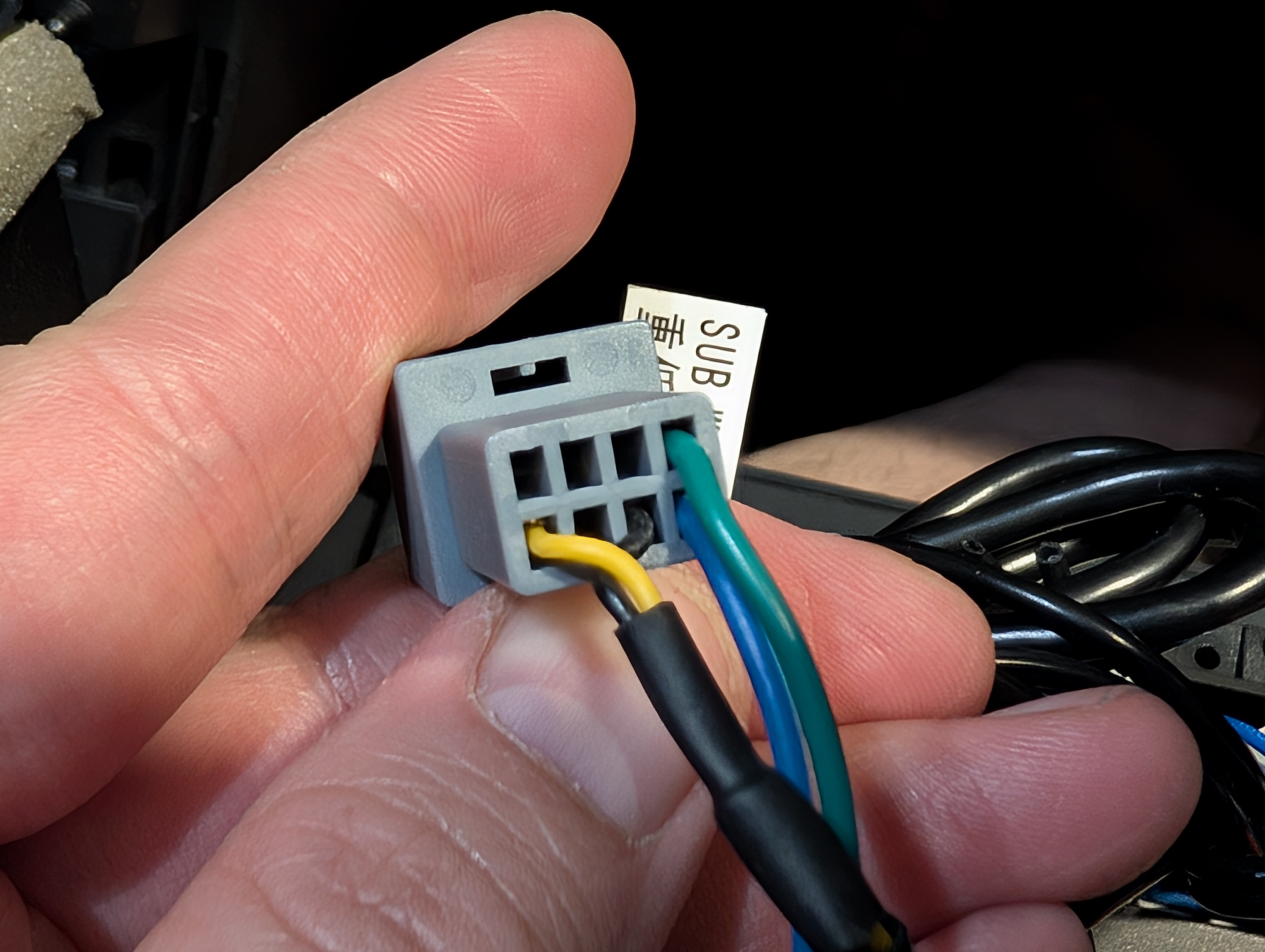

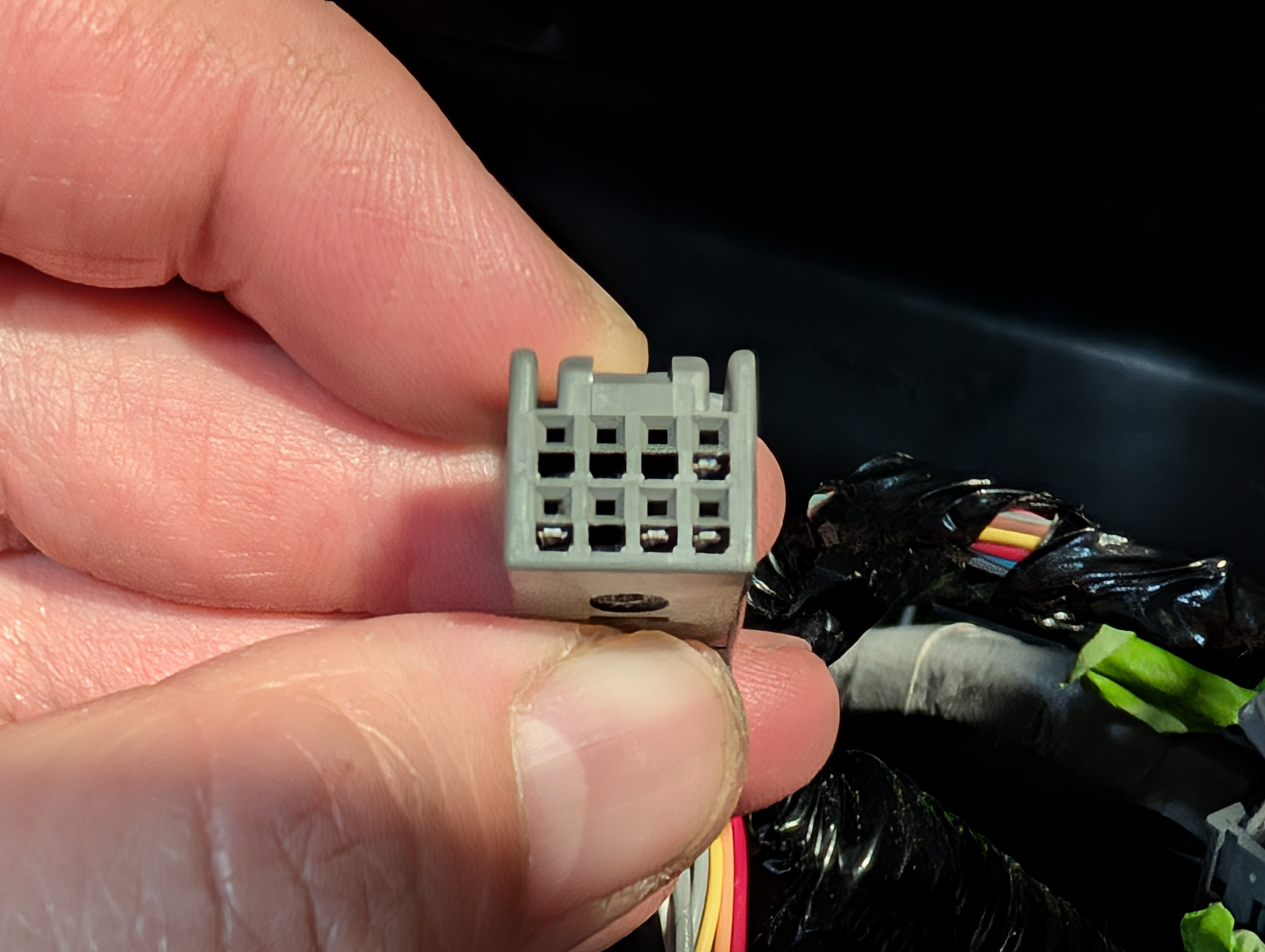

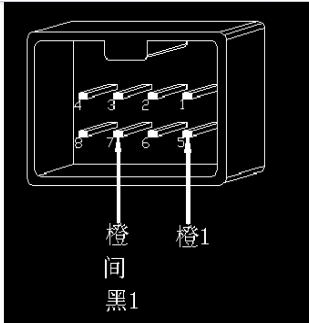

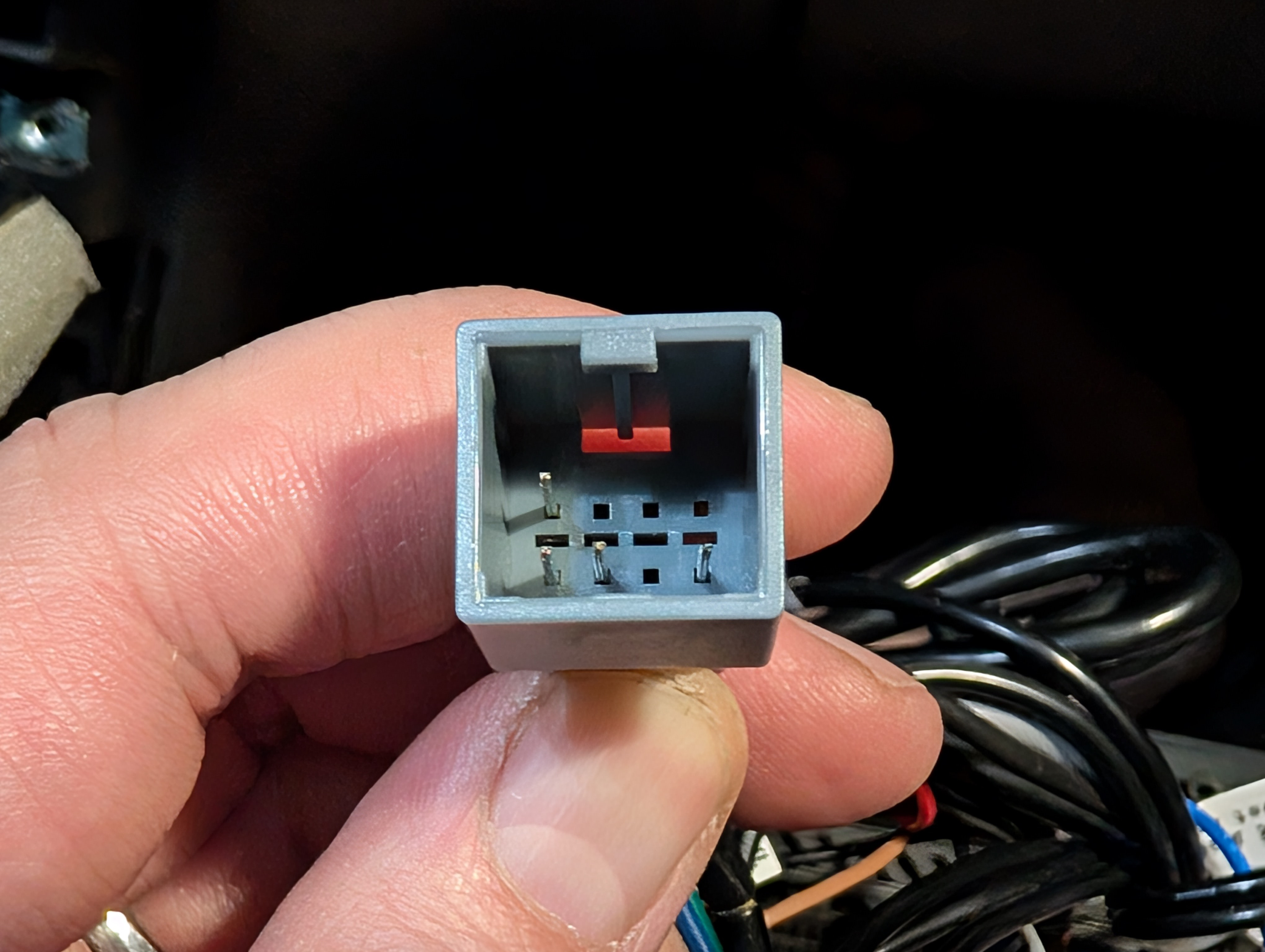

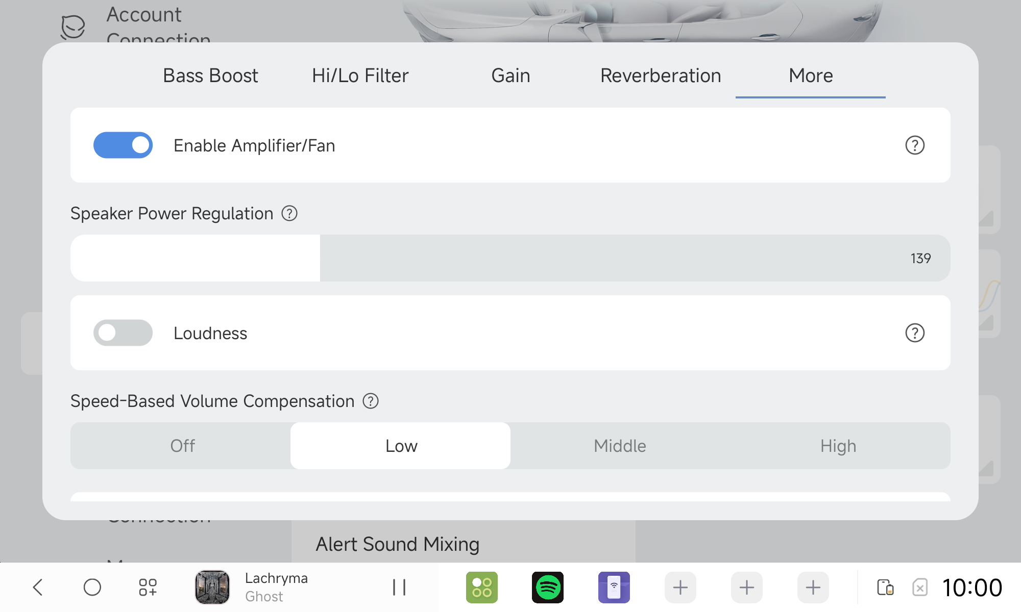

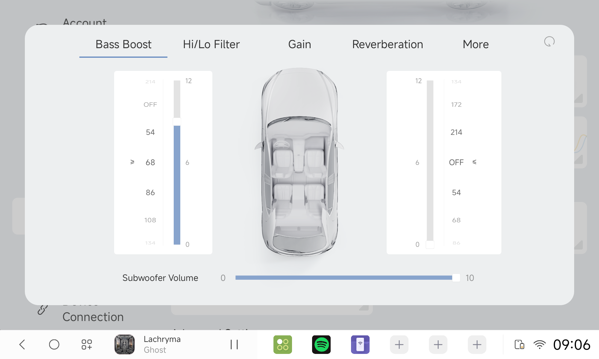

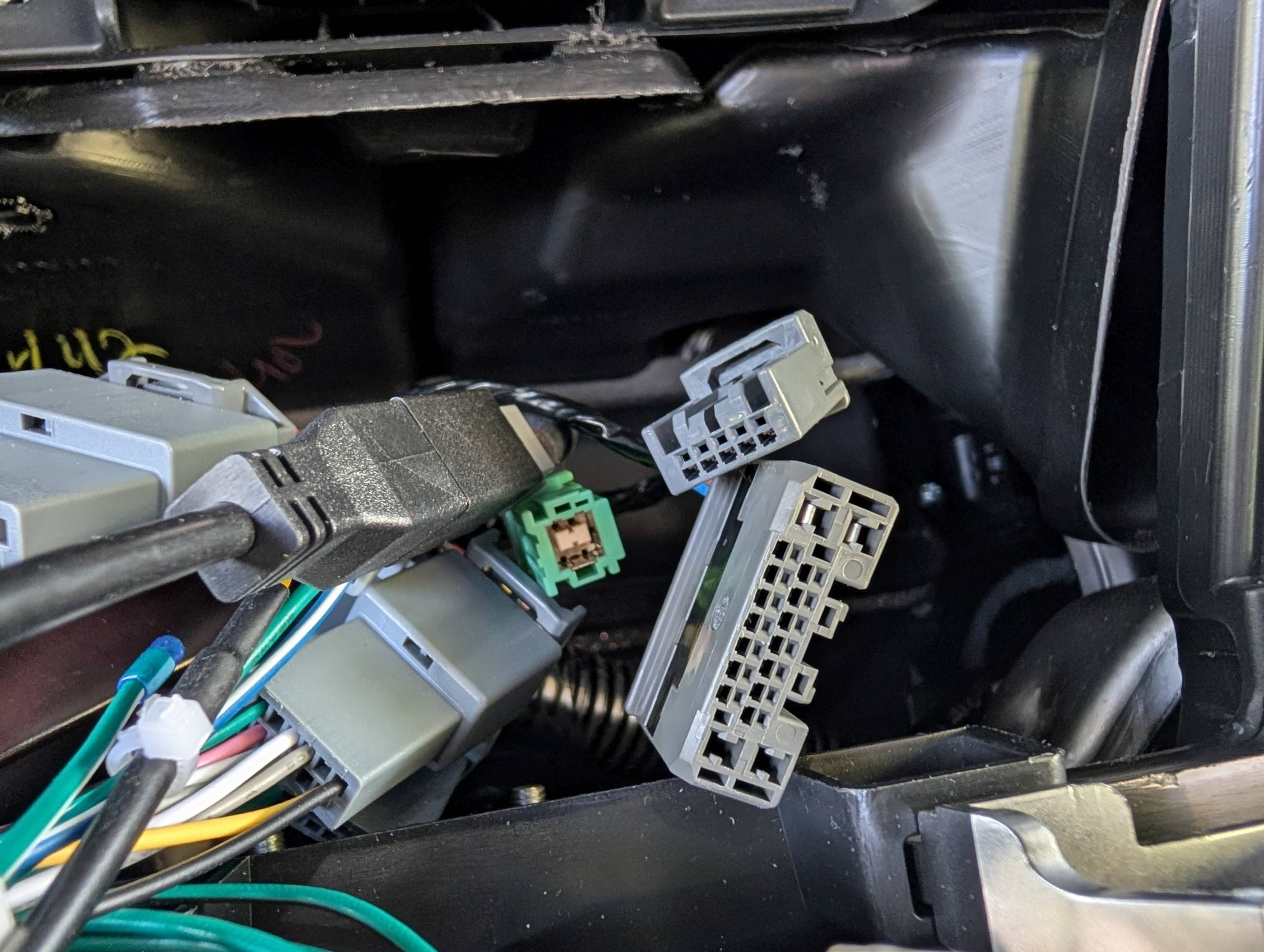

Item 1: I've worked with Mekede Customer Service and have not come to a solution. They suggest it's a software setting which I am not convinced of. The sound did not originally work until I combined the teal AMP-CON to the blue AMP-CONT blue wire. I have not found anything that could be useful in getting the subwoofer to work. You cannot feel any sort of vibration from the subwoofer at all when music is playing.

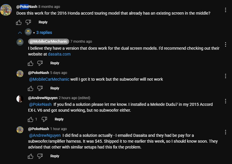

I did find a Dasaita customer (2016 Accord Touring) with a similar subwoofer issue and they're sending him a subwoofer/amplifier harness. I'm curious if this is the fix.
Item 2: No suggestions to get this working yet
Item 3: I have a Pixel 9 and I tried various Android Developer changes such as setting Bluetooth AVRCP to 1.4 and Bluetooth MAP to 1.3 which did not help. I also tested with my wife's Pixel 8a and it does exactly the same thing. If you go into the Bluetooth menu for the phones you will see DUDUAUTO disconnect and reconnect. For the time being I have removed the phone parings and resorted to using my phone's hotspot.

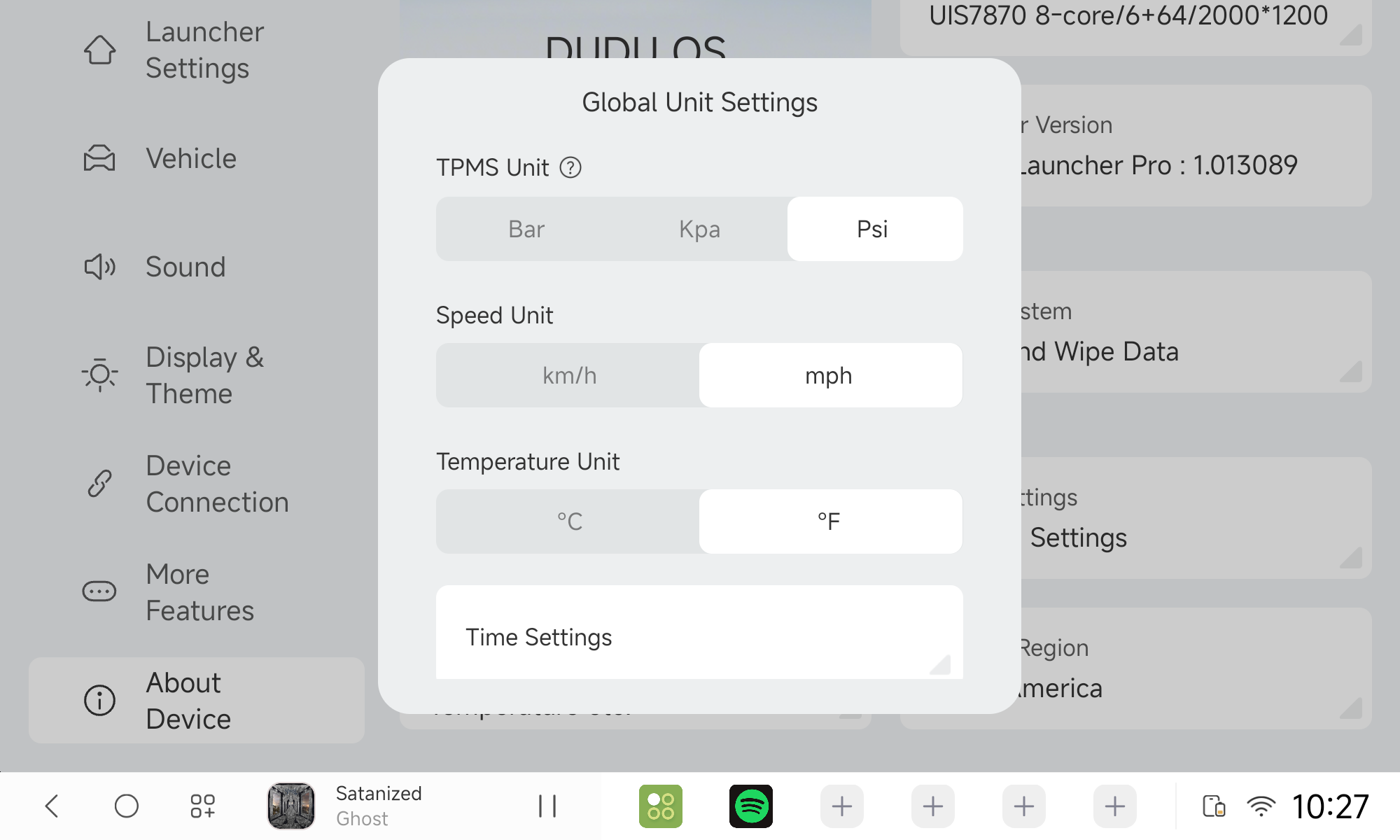

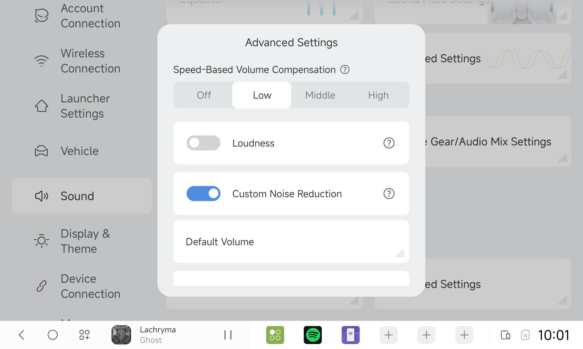

Item 4: It was suggested this is a software setting and I did change the Global Unit Settings to mph but that did not affect the top screen. I think it may be programmed into the TFT Driver box.
