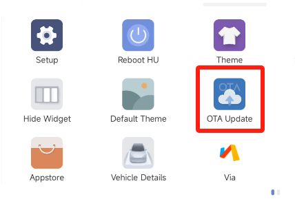

                          Cannot find “system update” in the menu….can you give me a hint please?
                            Vitosgromo
                            OTA Update, is an application
                            Thanks a lot
