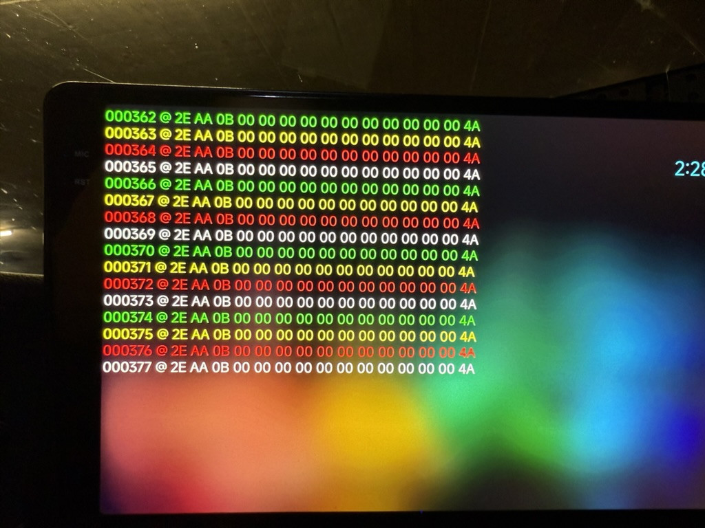

                      2Pac
                      Please record the CANBUS log that appears muted for a few seconds while playing music.
                      • 2Pac replied to this.
