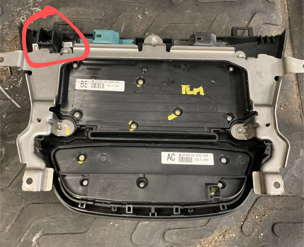

          I don't know how it is in the Insignia, but in my Meriva B I had to connect the cable coming from the original display to the socket marked in red in this photo.
          • Bury replied to this.

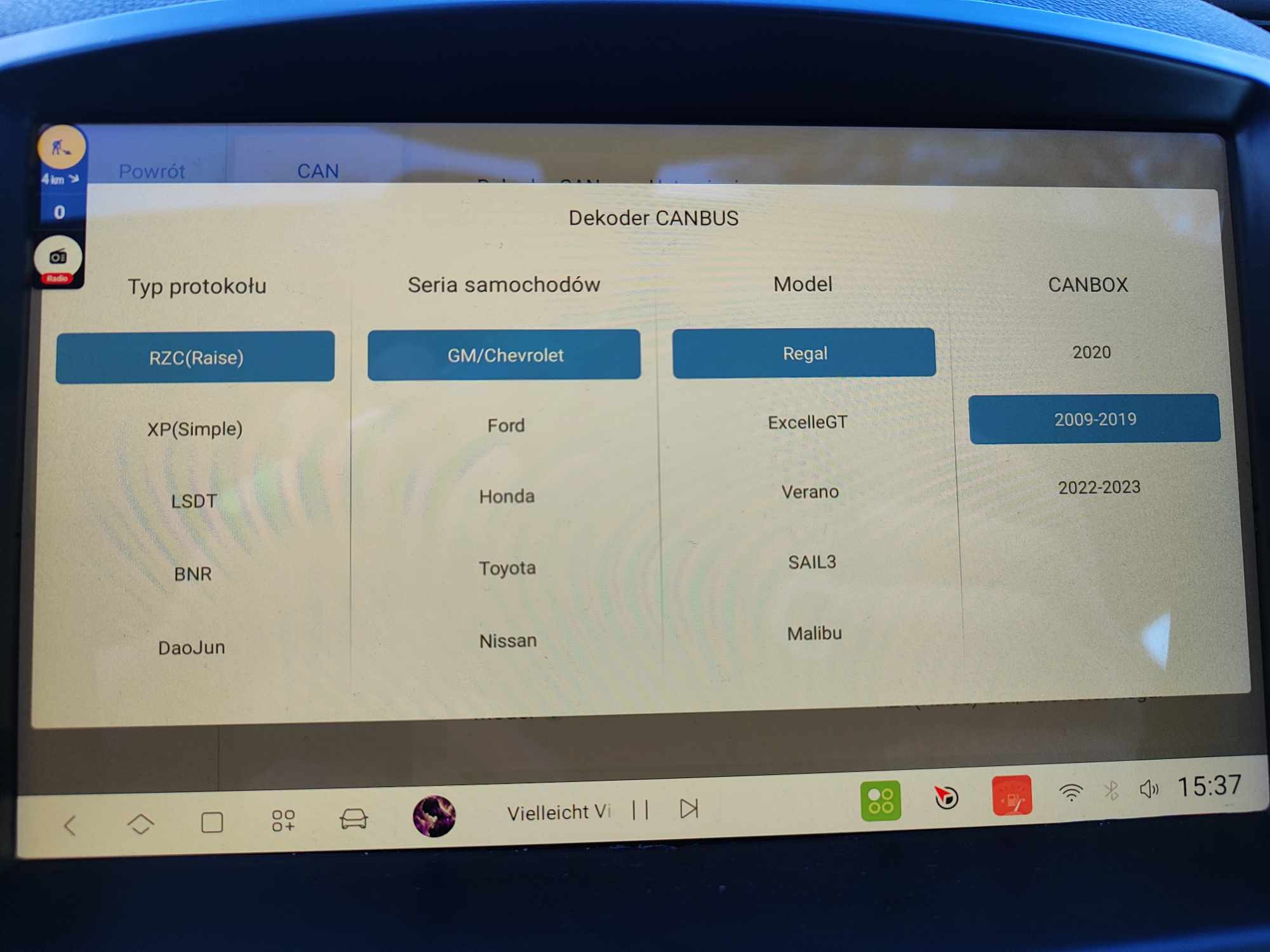

              Bury Don't change the control panel - with the correct settings I think it can work. What Canbus adapter did you get and what profile is selected in DuduOS?

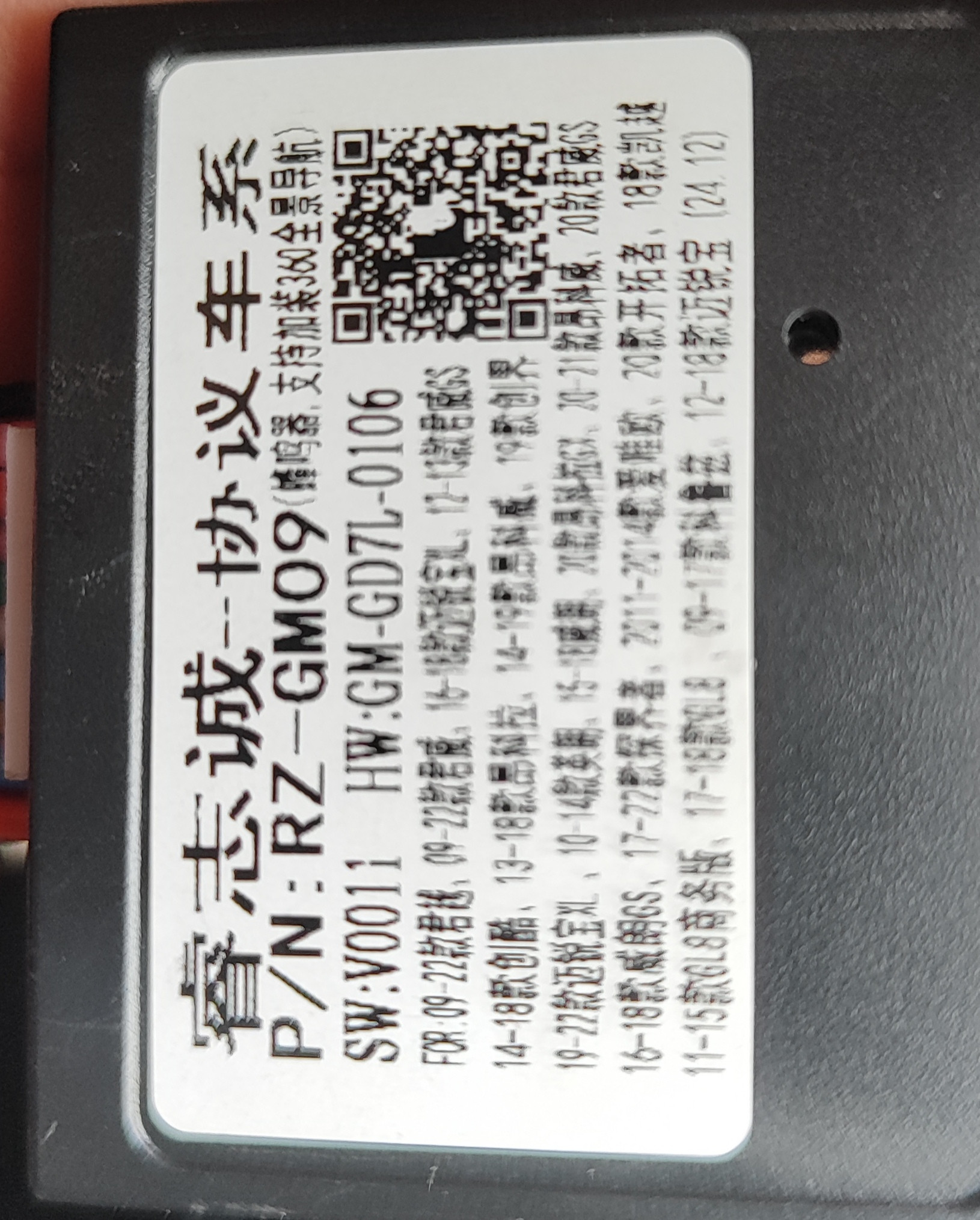

                What model of the radio? Any link to where you bought it? Photos of the wiring harness and CAN decoder with the model label clearly visible? Maybe it's enough to change the car model in the CAN settings of the radio to something else? Maybe Astra J, Buick, Regal? Try different settings and restart the device each time.

                  I tried every car model that made sense.

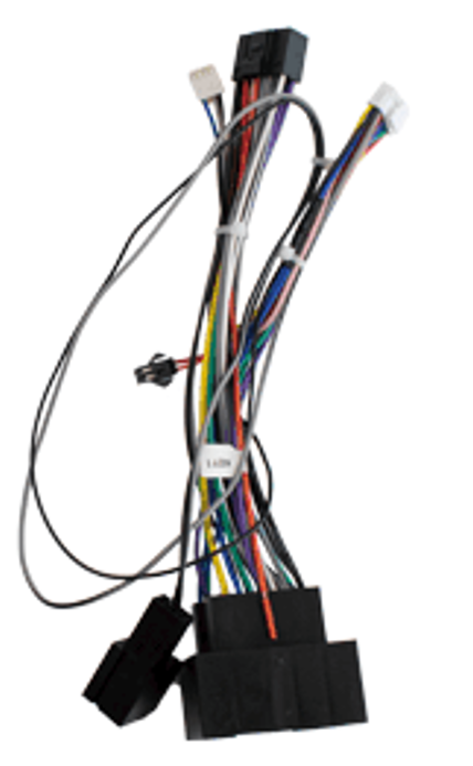

                  I'll take out the radio and take the photos tomorrow ,but the harness looks like this one.
                    Bury First of all, take a photo of the CAN box you received and check if all available plugs are properly connected to the sockets on the button panel.

                        The control from the button panel only started working for me after I connected the plug I previously mentioned to the cable that was originally connected to the factory display

                          Bury The canbus adapter is also very important. Do you have a photo of it? If not, it shows the model in Settings->About->Model series
                          Bury Scroll further down the list of manufacturers - Opel models are in there, further down from GM.

                            UK_Matt I'll take the radio out and take the photo, just bit busy with work. I tried most of the Opel models in canbus. And the thing is there is no power going into the buttons because they dont eve light up.
                              Bury I found a picture of your interface and there appears to be three connectors on the back. The black vertical connector on the top left is the important one for the volume and rotary control. If this is connected then I'm stumped. This should be the power and CANbus connector.
