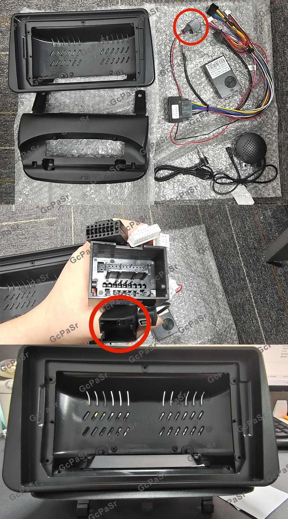

                    Confirmed working on my Dudu7 in my Meriva B (same generation car). I can adjust volume using the rotary controller and select FM radio playback.
                    @surfer63 Have you connected all the connectors on the CD400 panel (the important one is the black connector on the middle position on the right) and which CANBUS profile have you selected?
                      UK_Matt
                      Hi. I don't have an opel. 🙂
                      @Bury is the opel owner
                        Bury
                        I don't know how it is in the Insignia, but in my Meriva B I had to connect the cable coming from the original display to the socket marked in red in this photo.
                        • Bury replied to this.
                          • Edited
                          steefl86 UK_Matt I did that but with no effect. I have Dvd 800 panel, mb if i buy dvd 400 it would work ?
