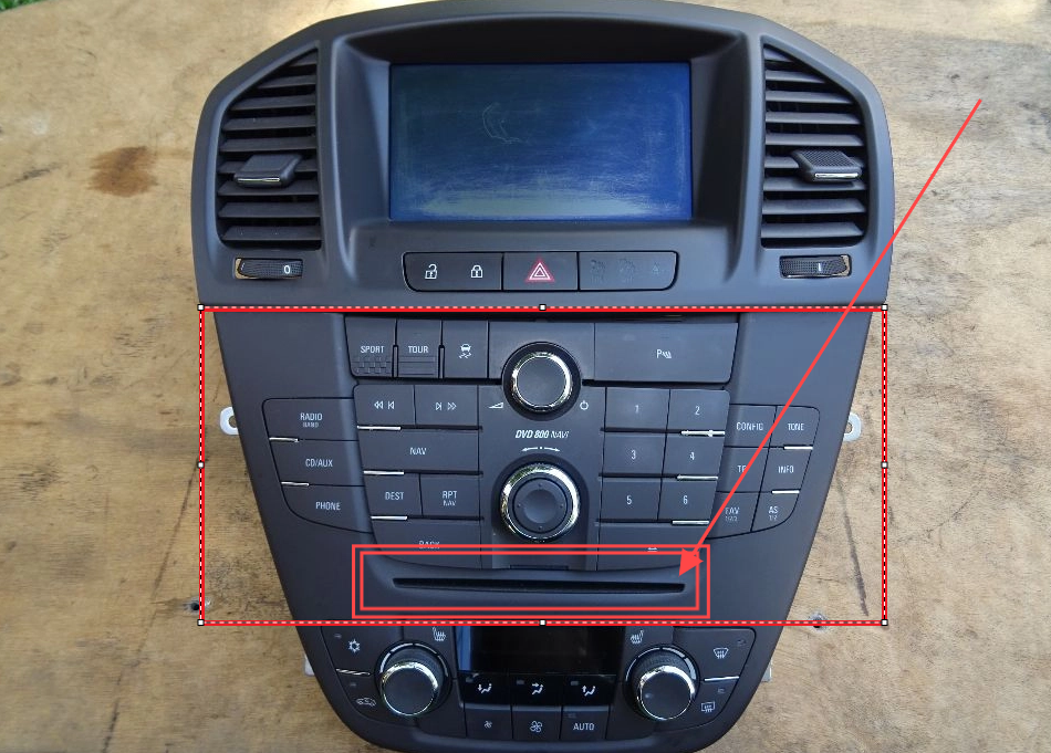

surfer63 i'm mainly talking about volume knob
    Bury Any pictures? Steering wheel buttons?

      dudu-lai What do you need me to take picture of ,and what about steering wheel buttons ? As i said they work.

        "i'm mainly talking about volume knob". Which volume knob? where? somewhere in the center of your dashboard? Somewhere in the middle console before or after your (automatic) gear shift?
        sorry for slow replies and not specifying what im talking about. Nothing inside that red square does not work.
          And i got that photo from google
          Bury These buttons usually control the factory CD, does the factory CD still work?

            dudu-lai I had to take out factory CD entirely cuz the cables that I had plugged into the cables that originally went into the CD.
            Bury The buttons here need to be wired to the canbox in order to work properly.

                Bury I just learned that these buttons are used to control the original cd player. You have chosen not to retain the original car host an turn dudu
                These buttons are definitely not available

                  DUDU-Meng So is there a way to keep originall CD player and still use Dudu ? With the wires that I had there was no way to connect Dudu and CD player together.
                  There are multiple modifications for your model.
                  1. Vertical screen Will remove the physical buttons in its entirety
                  2. horizontal screen retain cd host installation is more complex sound or by the original cd host sound, dudu for entertainment.
                  3. Horizontal screen retains the faceplate does not retain the cd host Advantage is that the sound is completely controlled by the new host

                    DUDU-Meng so there's no way to connect just the volume knob with Dudu ? and if I'll choose the 2nd option how can I set it up ?
                    No, the second way Your original cd host is still working fine.
                    Dudu is for entertainment only.

                      DUDU-Meng Can I ask for instructions how i'm supposed to wire eferything ?
                      Asked the tech. You can't keep the original cd on this model.
                      That's why this button doesn't work.

                        DUDU-Meng And what if I swapp CD player for a different model, would that change anything?
                        You have a CD player and the physical buttons are the CD player's own buttons which only control the CD player.
                        When you change the big screen car machine, the power supply and speaker cable to the CD host are disconnected, so the CD does not work, and the physical buttons that come with the CD player will not work.
                        If you want to keep the original CD host, it is estimated that you need to enter in the case of not unplugging the CD cable to modify their own flywire out to connect to the big screen car machine alone to be able to. This we do not have the technical conditions, you can study by yourself if necessary.
