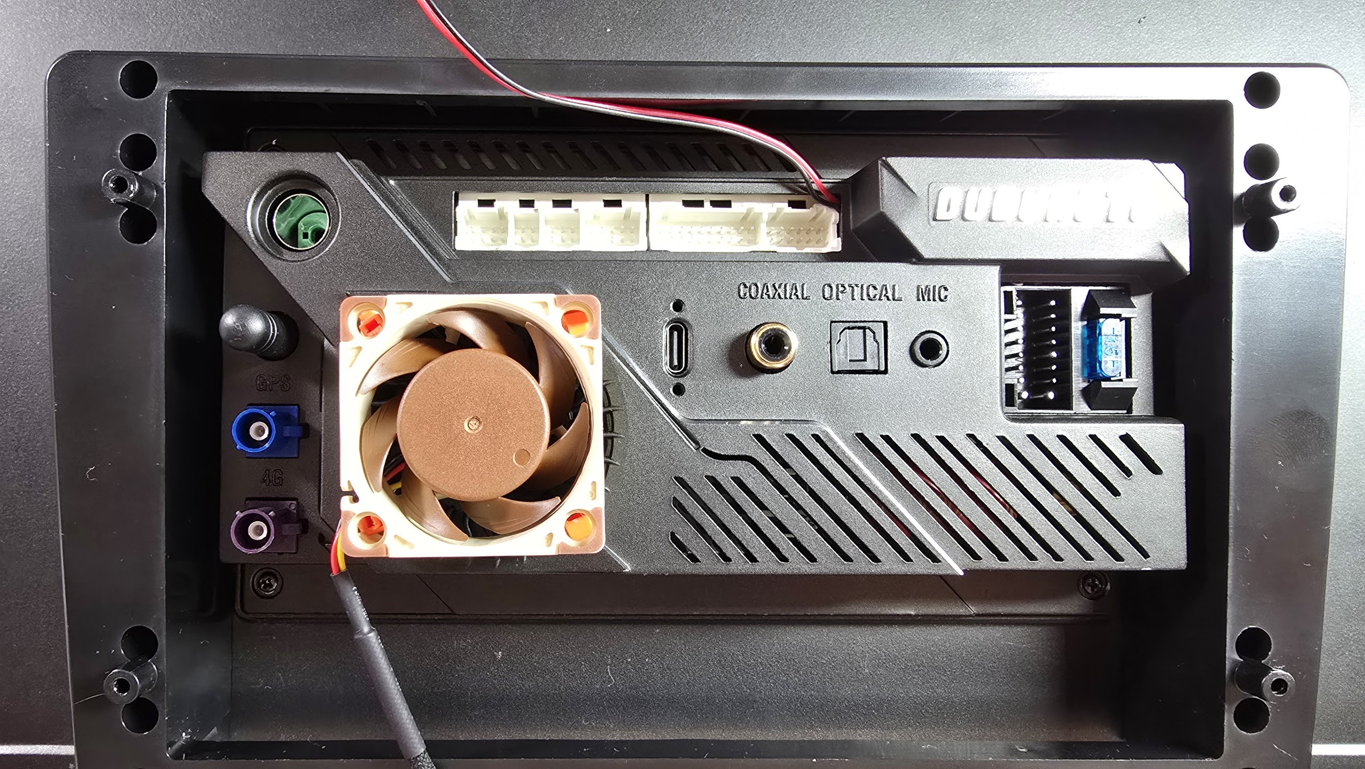

              tsbrewers Hi. Is 12 Volts. I've already made the modification. I removed the factory fan and installed a 40 x 40 x 20 mm external one. Now the aluminum casing above the CPU cools much better. Previously, the entire casing would heat up due to the heat generated by the amplifier chip, and the factory fan is very small.

                    JhonnyD The fan I used is actually quieter than the original factory one. It's much more efficient because it has much greater height and pitch of the blades. The original one is only 7 mm thick. The impeller of the one I installed is 17 mm thick. It actually cools the aluminum and it seems to be sufficient to keep the CPU from exceeding operating temperature.. The factory one doesn't generate any cooling effect on the aluminum.

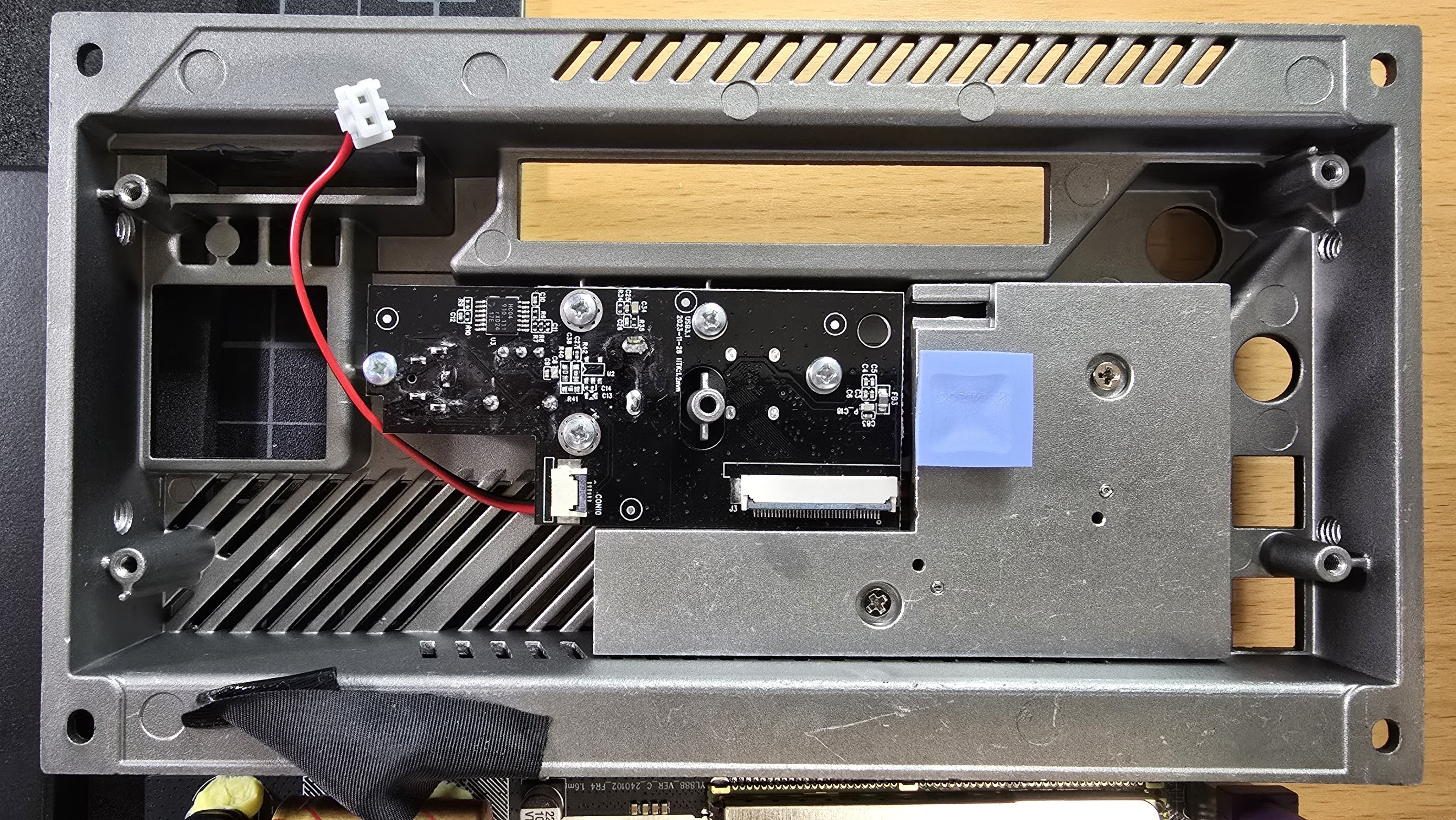

                          abidali Hi. The factory fan spins correctly, but it doesn't generate enough airflow to prevent the aluminum from continuing to rise. I replaced the thermal solution with a 1mm-thick aluminum plate and thermal paste on both sides. It's much better than a thermal pad. It still wasn't enough until I replaced the fan. Wait until summer, when ambient temperatures are higher, to see if you start having problems.

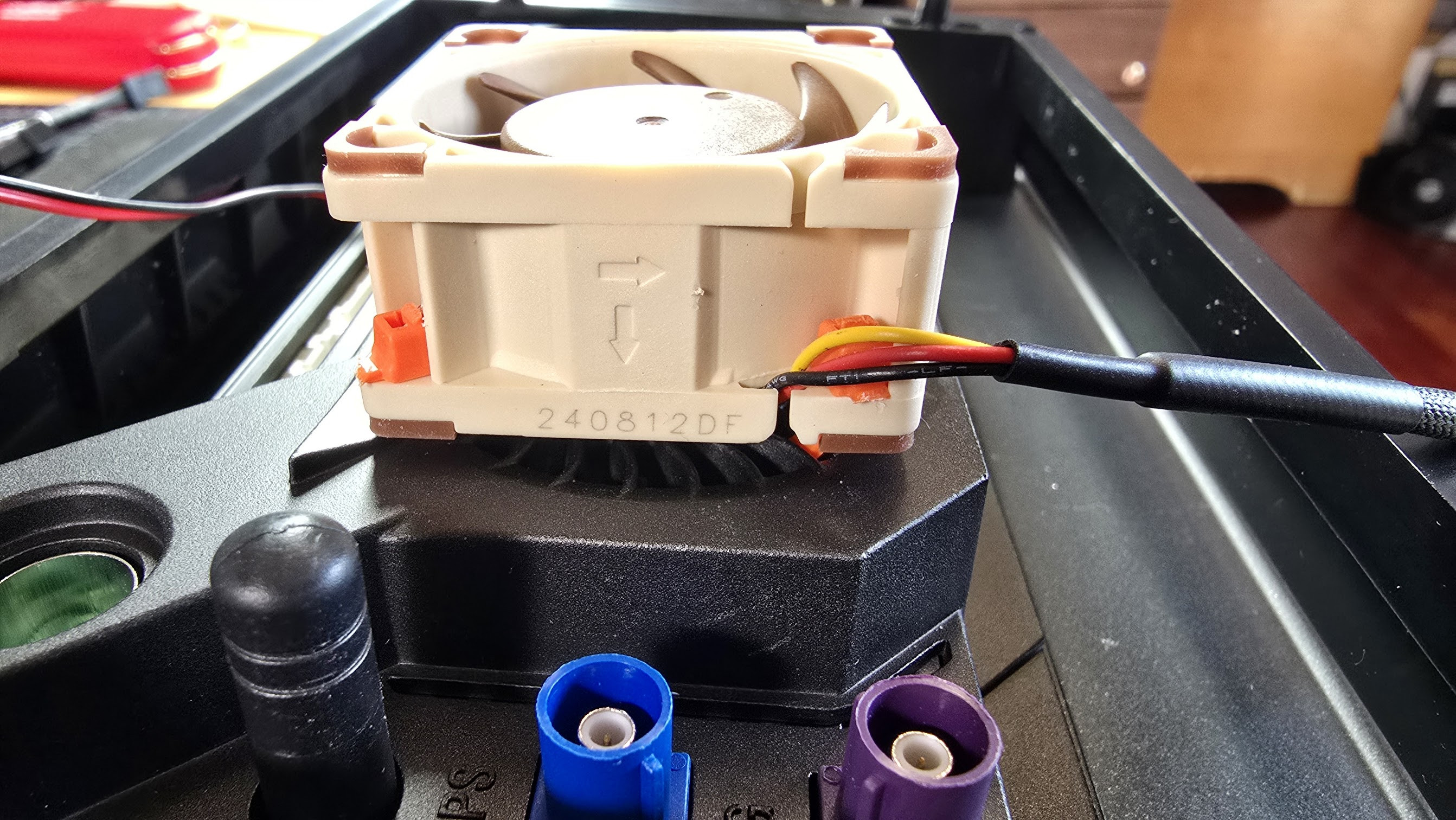

                          I ordered this fan and will take photos of the internals when I have everything apart.

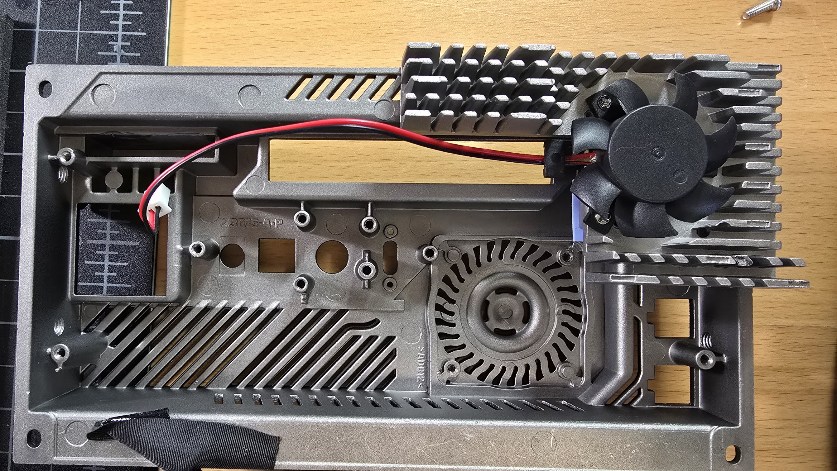

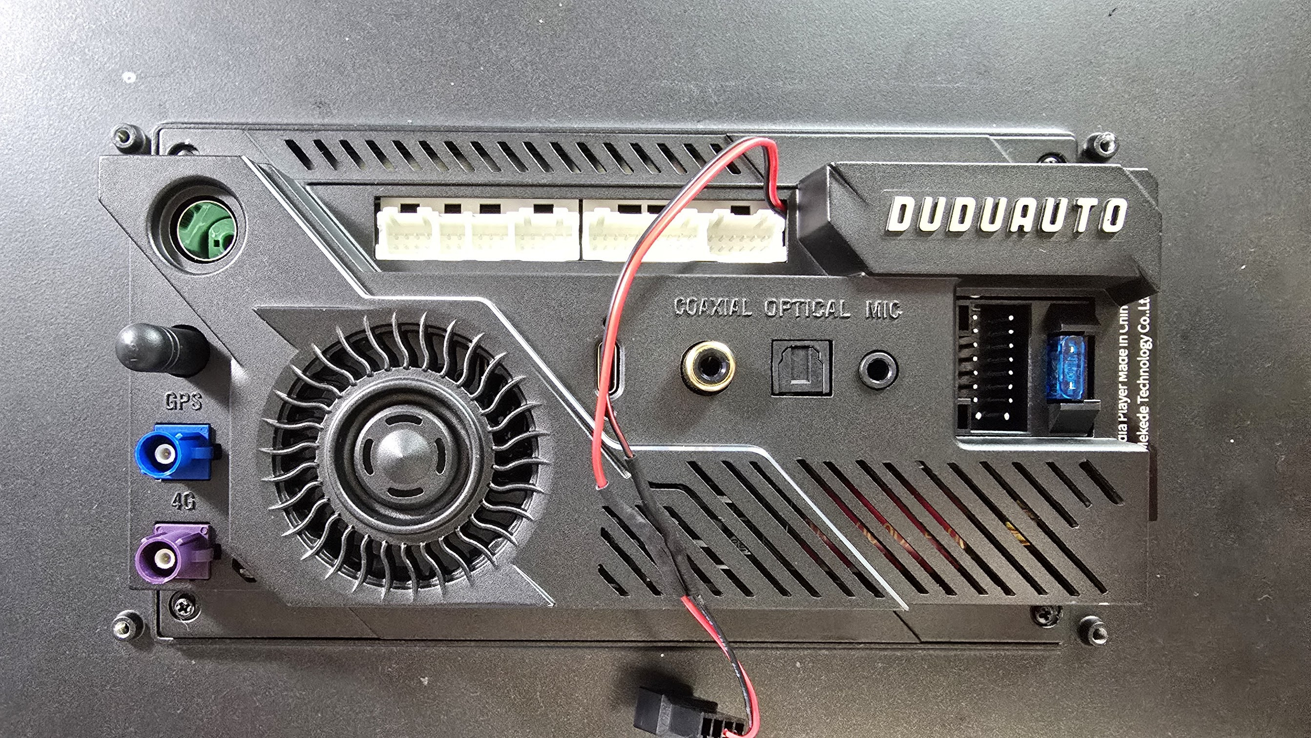

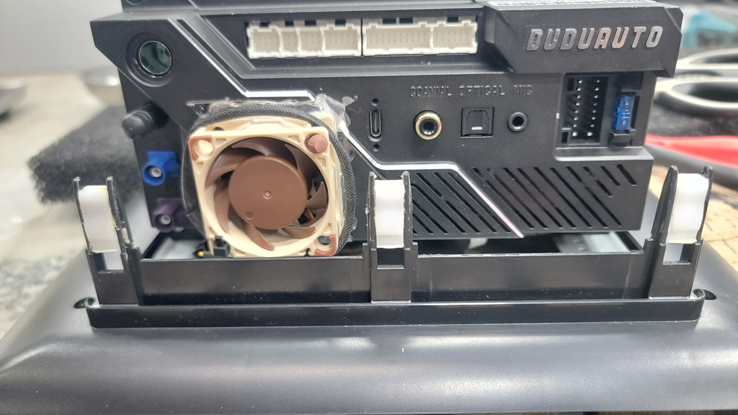

                          For those that are interested in the internals and what it will look like when replacing the fan in this manner.
                          Here is mine,
