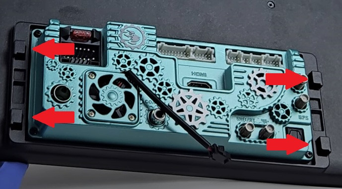

For those that are interested in the internals and what it will look like when replacing the fan in this manner.
I ordered this fan and will take photos of the internals when I have everything apart.

Arielnac Any reboot issues since the fan swap?

Arielnac Only reason I asked was because of what you stated above. "The unit booted normally, reaching 100°C without rebooting or shutting down."
Arielnac Could you provide photos with the backplate off? Could the backplate be trapping heat against the circuit board and maybe affecting other chips possibly causing the reboots? Maybe the SOC overheating isn't the issue.
This makes me wonder how the thermal transfer material is applied, if any, to the SOC and heatsink. Is it a pad, adhesive or is it a paste being used and how much.
