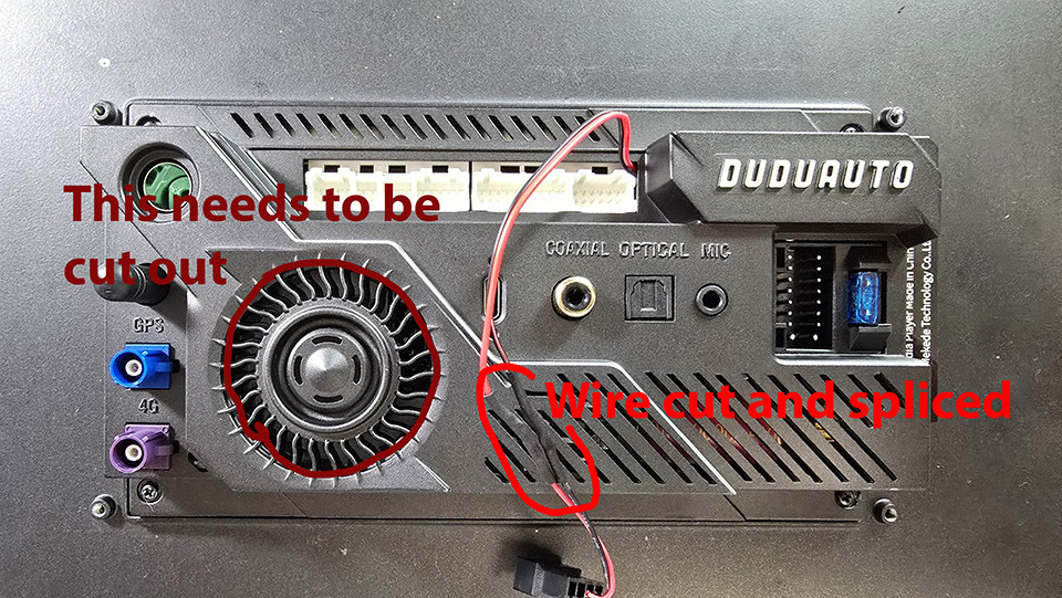

                Quick question, did changing the fan needed some kind of soldering? And I cant figure out how you guys screwed it; looks like colored plastiky screws. Do i need special screws or the noctua fan comes with it?
                The stock fan is quite noisy, my screen gets quite hot to the touch after 30min drives. Im looking to lower fan noise and keep my unit a bit cooler. Tx for any input @IamDefiler and @Arielnac and @tsbrewers and anybody else
                Yes, I believe I had to do some soldering. That wasn't a big deal really, but I did have to cut away some of the aluminum grill that was covering the old fan, this was probably the worst part. From there, it took some tinkering to mount the fan, I believe in my picture I used zip ties and then hot glue to seal up the fan so the air would all be directed in to the head unit. Overall it was a little bit of a pain to do, but I would do again in a heartbeat. the fan is much quieter, I am assuming it pushes much more air too. I only hear it if the radio is muted. I now also have it running anytime the radio is on since it is much quieter.

                  In my perfect world, I would have everything needed to do the mod before taking the unit out. Could you tell more about the "cut away some of the aluminum grill" part, tools needed etc? ¶Seems like @Arielnac used some kind of string to hold it, not zip ties vs strings..
                  Did you put some kind of dampnening material between the fan and the casing? I was thinking some rubber, or maybe some foam. For the soldering, I will use Solder Seal Wire Connectors from aliexpress. Will be my first time soldering some connection 🙂

                  this is a picture from above to show what we mean. The housing is aluminum and should be fairly easy to cut, a dremel with a cutout wheel and a grinder would do a nice job. Then the soldering is just the wires for the fan. I would use an iron and heat shrink tubing, I have never used the solder seal connectors, though if they work, that's fine.
                  Mounting the fan is up to you. I got a little carried away cutting away the aluminum grill so I didn't have much meat left to use screws or the rubber mounts that came with my fan. if it is tight, no need to use any dampner material, I used the hot glue to simply seal up the airflow.
                    tsbrewers Ok, now I "see" better how you did it, removed the round central part. Thats a bit scary from my inexperienced pt of view. I think I will have to remove the unit 1st and evaluate if I could do it.

                      FreeSpoutti no problem, there are a few tricky things too like undoing the ribbon cables when you taking it apart, but it is doable if you take your time and be careful. Looking at the pictures above, I am not sure if anyone else cut the fan grill out or not. They might have left it, but to me it would really cut down on the air flow if you left it.
