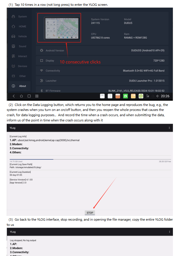

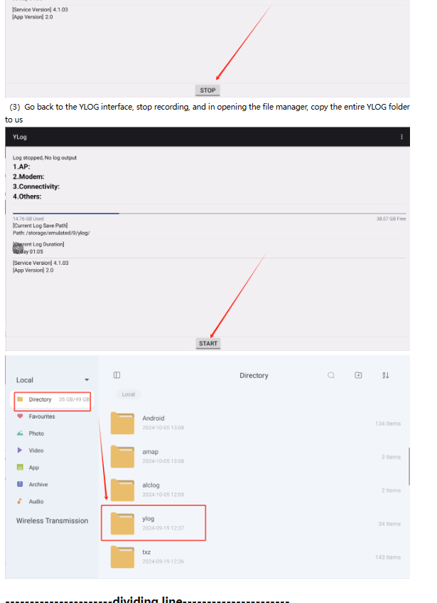

mircondini DUDU-Meng Please help me grab the ylog Hello, your collegue told me that pics I sent are not the ylog. Could you please show me the right procedure, as the one I found on the forum show me the two pics I sent? Thank you
DUDU-Meng mircondini This is the method for capturing ylog. https://forum.dudu-auto.com/d/1674-important-notice-feedback-on-bugs-must-be-prepared-system-information https://forum.dudu-auto.com/d/14-how-to-give-correct-feedback-on-bugs
mircondini DUDU-Meng sorry, but the first pics I sent it's exactly the one shown in the first link :😕
DUDU-Meng mircondini Please try the second connection method to grab YLOG. Which version did this problem start appearing in?
mircondini DUDU-Meng Which version did this problem start appearing in? with the latest OTA vesrion (3.6?)
mircondini DUDU-Meng Please try the second connection method to grab YLOG. I did the first 2 steps of the secon link and the pics I sent are what I found. Could you please tell me exaclty the procedure?

mircondini DUDU-Meng I downloaded ylog folder, but I'm not able tu upload it (to heavy). Any different system?
