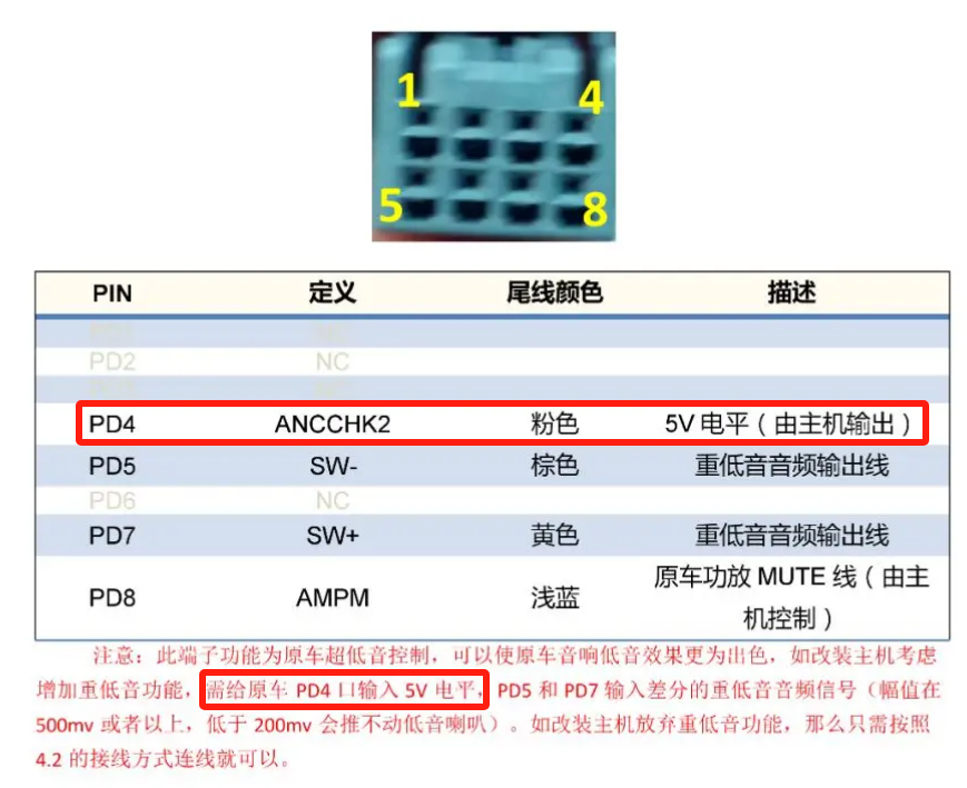

    Is there 5V at PIN4 and where is the PIN8 cable connected?
    Will I get sound when I connect the subwoofer RCA connector to the left front audio output on Zone A?

          Also I have not checked Pin 4 of the 8-pin connector yet because I do not have a multimeter.

                dudu-lai I do not get 5V from any of these pins while the car is on and music is playing. I confirmed my car battery shows 12.46V when the car is off and 14.29V when on so I know the multimeter works.
                  adnguyen23
                  PIN4 input 5V level
                    dudu-lai Could you please clarify? I checked Pin 4 and do not get 5V from it.

                          adnguyen23 PD4 inputs 5V voltage to test whether the subwoofer works

                            dudu-lai Is there something you would like me to test? I put the OEM head unit back in and the subwoofer works.

                              adnguyen23 PD4 inputs 5V,Have you ever tested it like this?
                                dudu-lai Could you please confirm if this is how you would like me to test this? https://www.youtube.com/watch?v=xIMHGkxw72o

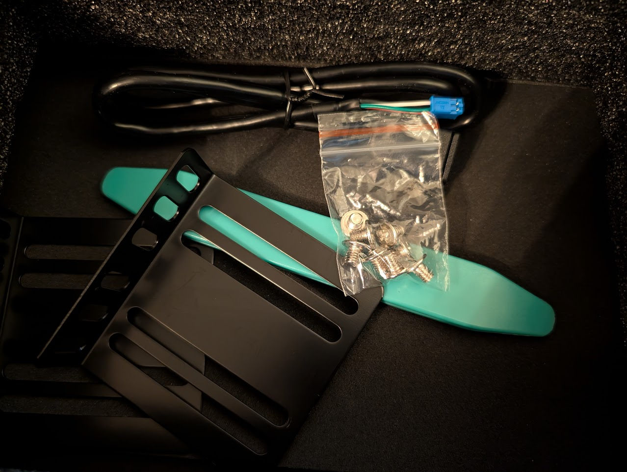

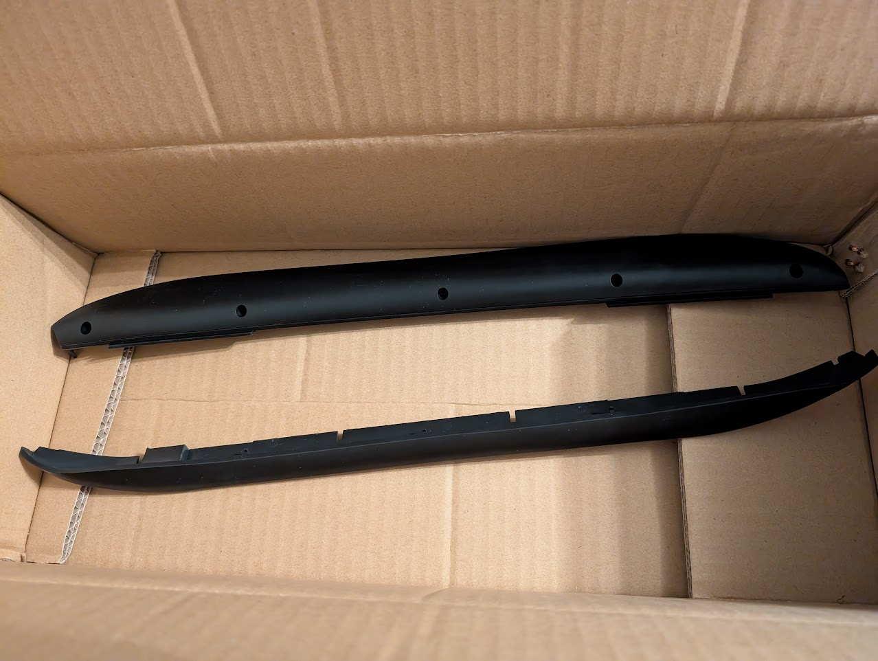

                                I don't have any screws for these trim pieces. Please let me know what size is best
                                These are the only screws I received.
