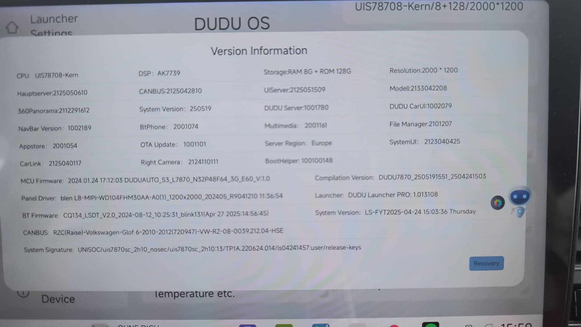

When trying to update, CANBUS operation is blocked, no response to pressing the steering wheel buttons. The attempt was unsuccessful, as I wrote earlier, additionally, after updating to version 3.6 beta3, the device cannot be restarted, this can only be done via the "recovery" button on the system information screen. I also tried updating Canbus on Mekede M600s, the effect is the same, i.e. no effect 😉 below is a link with a recording of the update attempt

    Slavus Are the air conditioning controls and door messages working?
      dudu-lai Everything works, CANBUS is blocked only when the update application is enabled. Then you can't even reset the HU, except the way you see in the video. After restarting it's fine again.
      Slavus finally i bought another Raise G-RZ-VW58 with 2402 production date and upgrade ends succesful, Voice Commands starts with SWC buttton
