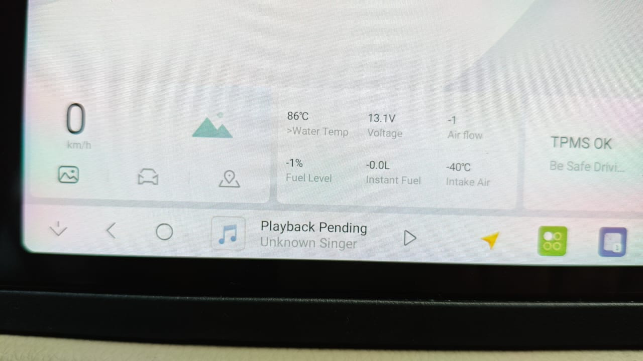

      This one works with DUDU7 and shows me coolant watertemp and fuel amount in the statusbar:

      No special setup required, paired in DUDUOS Settings.
      And for a good price.
        It just should have the name OBDII in the list of Bluetooth devices.
        You can get all those adapters to work with DUDU OS.

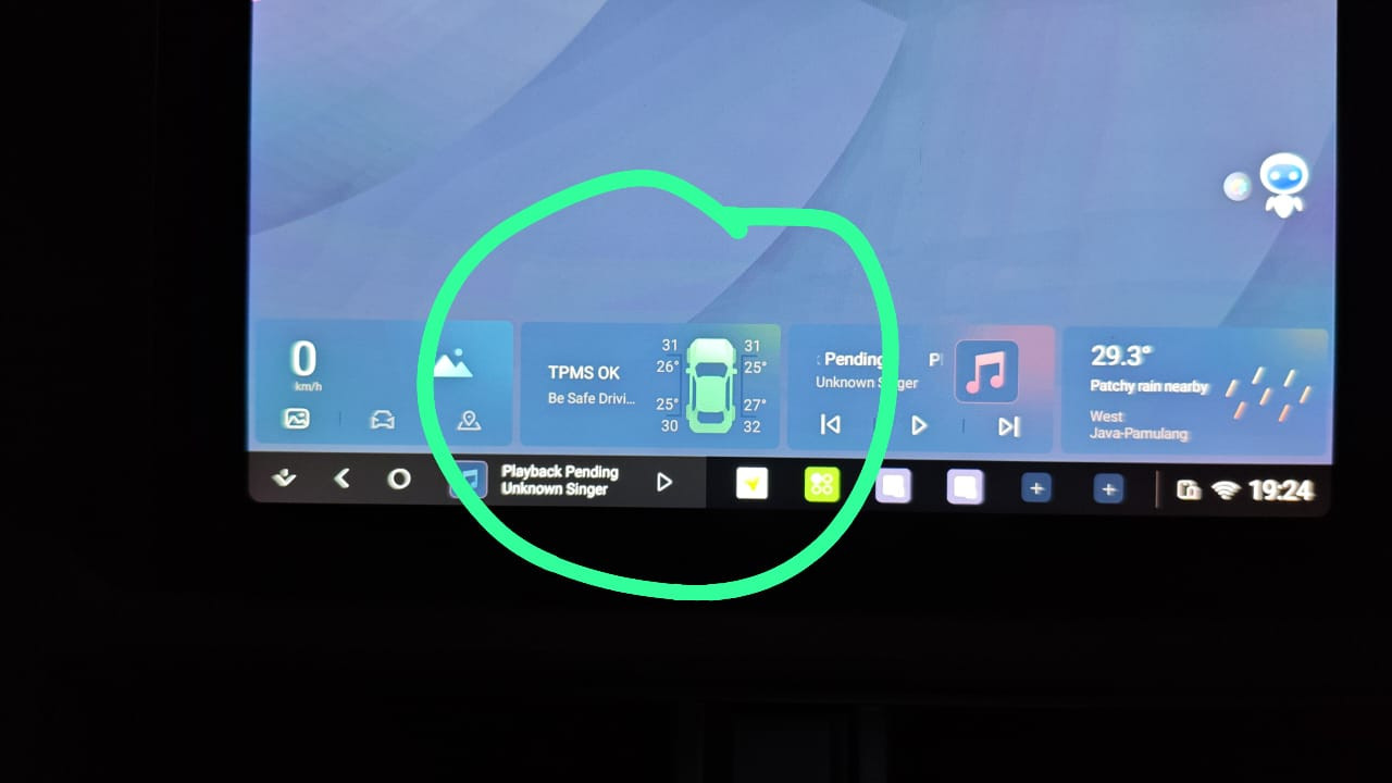

                  i have like this on my dudu7.
                  Does this mean it working?
                    wolf-jr This is Canbus or external TPMS, not OBD2.
                    The data on your second Foto is OBDII or canbus

                        JhonnyD yes i mean the second one, does it mean i successfully connect my dudu7 to OBDII?
