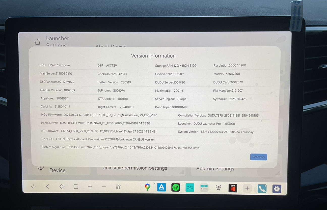

        This is really strange, please take a picture of your system information and upload it.

        1. Please take a picture of your system information and upload it here, Settings - About - Press and hold the picture in the upper left corner.
