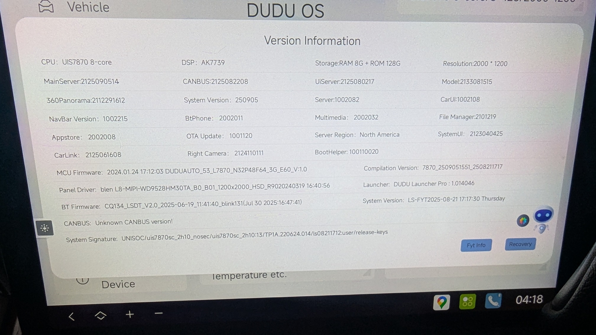

79Red Hi, here is my version info, I hope this helps. Do you need the Ylog too? There is no software bug, just I can't get the display to work.
