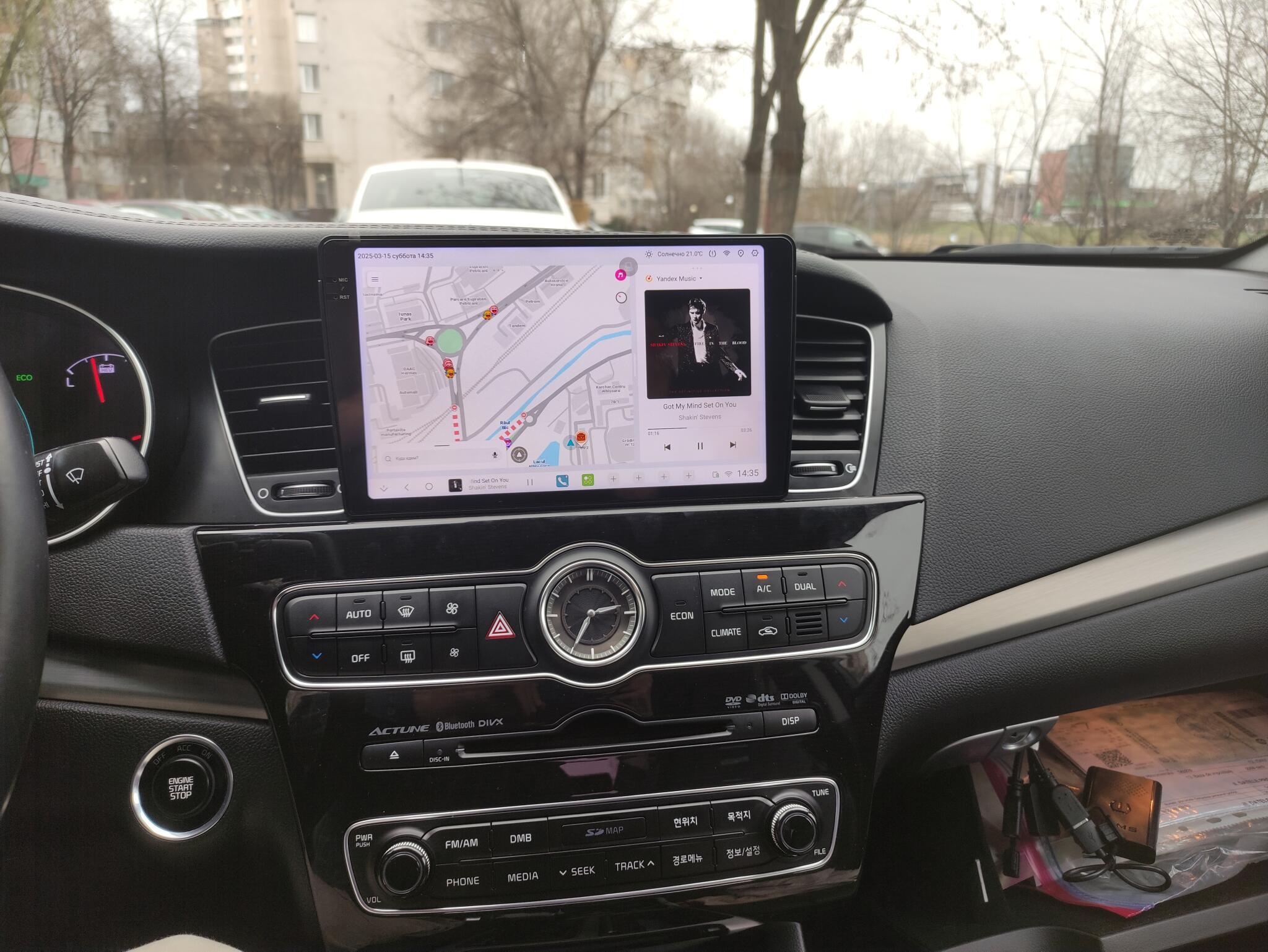

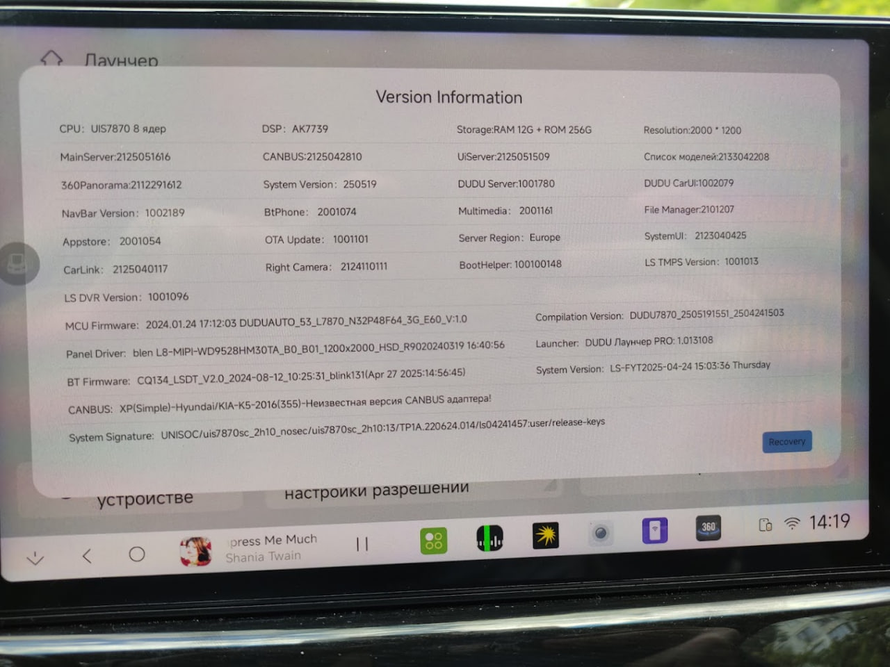

I'm experiencing sound issues — no CANBUS profile works properly with my car's audio system.
Car: Kia K7 (K700) Hybrid, 2016

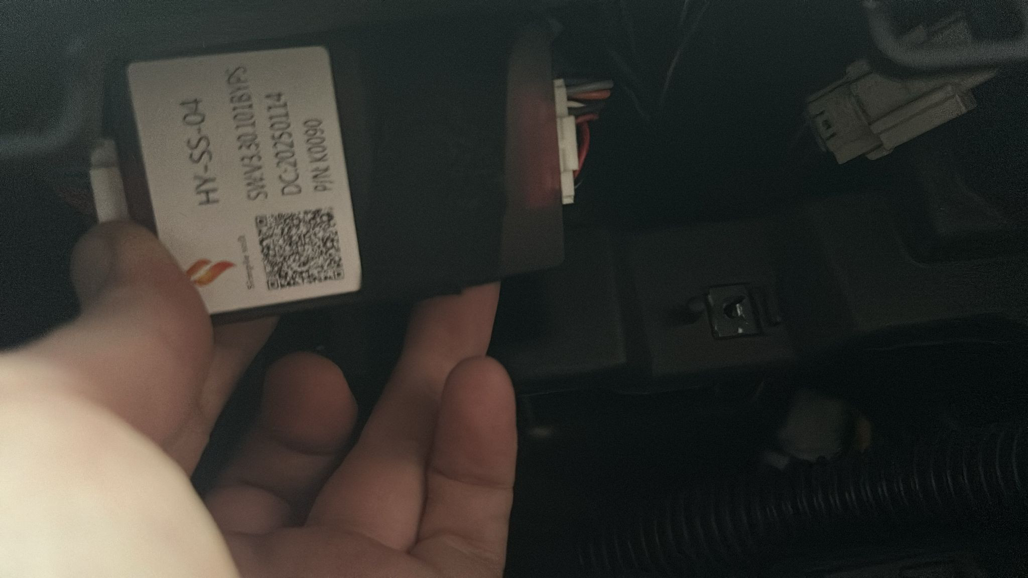

CANBUS module: HY-SS-04

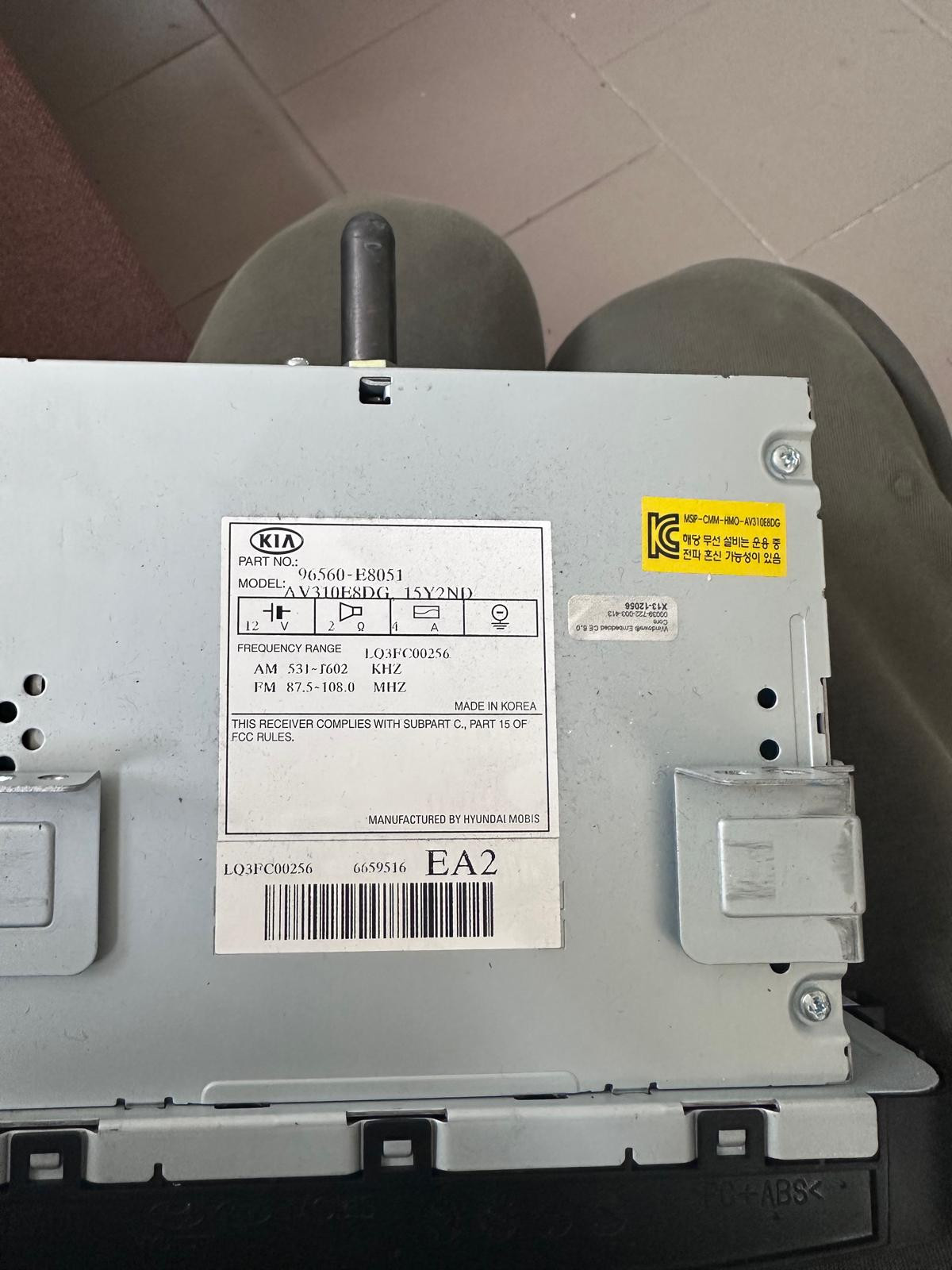

Audio system: Actune

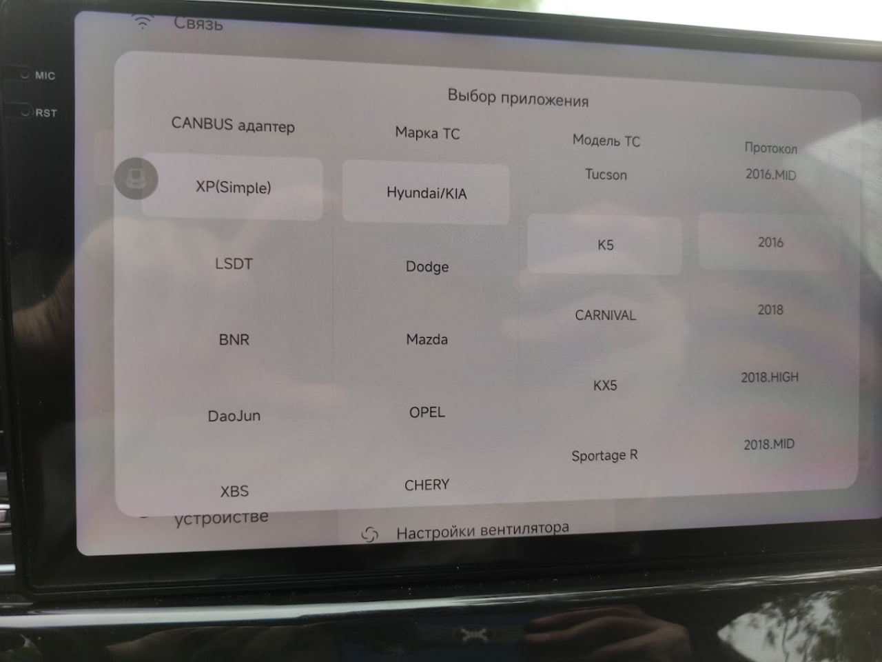

What works fine (only with CANBUS profile: XP(simple) - Hyundai/KIA - K5 - 2016):
→ Steering wheel buttons
→ Door open status
→ Parking sensors
→ Climate control
Main issues:
Profile: XP(simple) - Hyundai/KIA - K5 - 2016
→ Sound is very quiet
→ Either only front or only rear speakers work
→ Strange beeping/pitching noises appear while braking, moving slowly, or reversing

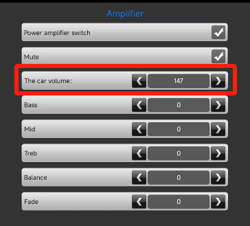

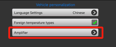

Profile: XP(simple) - Hyundai/KIA - Sonata9 - 2016.HIGH.AMP
→ Sound is almost perfect
→ But volume control does not always work
→ Volume often changes on its own — sometimes too loud, sometimes too quiet

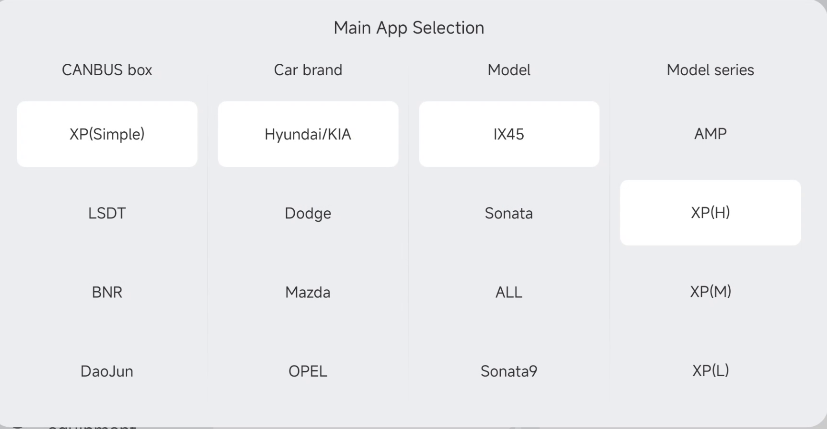

Profiles:
XP(simple) - Hyundai/KIA - Sorento - XP(H)
XP(simple) - Hyundai/KIA - Sorento - XP(AMP-35)
XP(simple) - Hyundai/KIA - IX45 - XP(H)
→ Sound is decent but not as good as with Sonata9 - 2016.HIGH.AMP

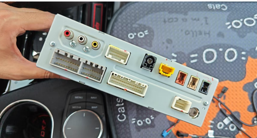

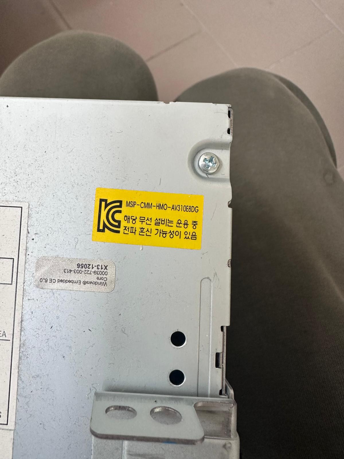

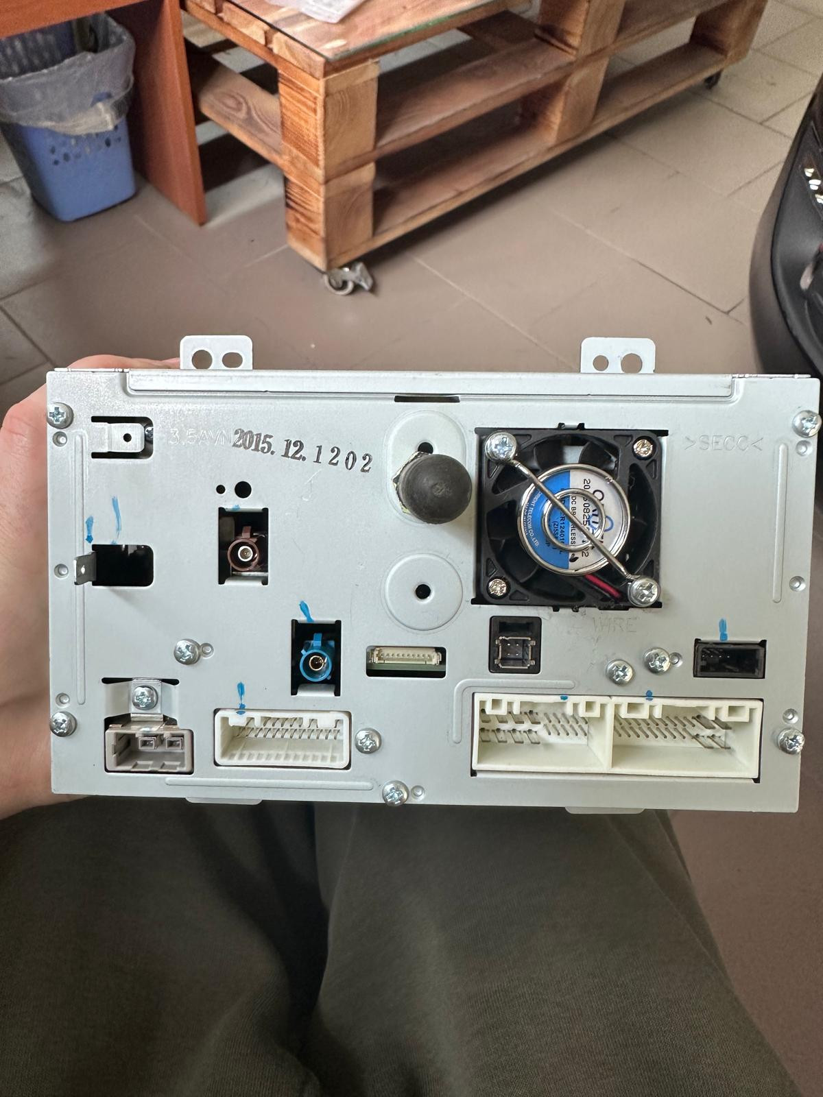

Is it possible to create a custom CANBUS configuration for Kia K7 2016
that uses the audio settings from Sonata9 - 2016.HIGH.AMP,
while retaining all other functions (steering buttons, doors, sensors, climate, etc.) from the K5 - 2016 profile?
I'm ready to provide any required technical data if needed.
