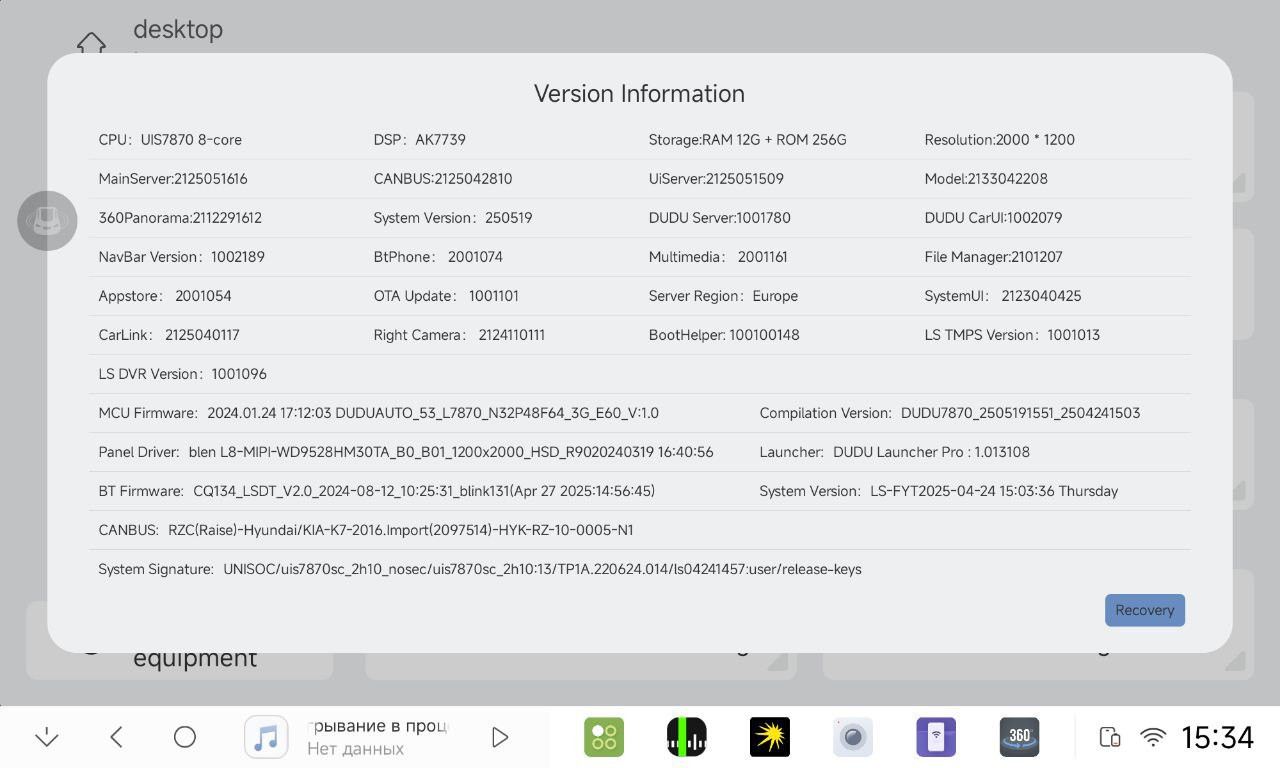

qwertykolea Hello @dudu-lai , Photos that I've attached in previos port is it enough for asking raise engineers about apropriate canbus for my car?
dudu-lai qwertykolea I consulted with Raise engineers and he recommended RZ-HYK-13 and RZ-HYK-14 (AMP)
qwertykolea dudu-lai Hi, I bought another canbus (RZ-HYK-13 and RZ-HYK-14 (AMP)) as you recommended, but noise sound became even louder. In this link: https://we.tl/t-QIH6tRRKxV you will find: URecorder_25062025_151637.m4a - noise sample that I recorded video_2025-06-25_16-15-52.mp4 - how I turn on the canbus logs and choose my car (KIA K7) from the list log_2025-06-25_0.txt - canbus logs
dudu-lai qwertykolea Please try it. If the noise disappears after unplugging the audio RCA, you do not need the RZ-HYK-14 (AMP) box, and connect the original car coaxial audio directly to the coaxial interface of DUDU
qwertykolea solved dudu-lai Hello, I succesufully solved it, as you said and with instructions from your telegram: RZC: https://t.me/duduauto/15845/258919 HY-SS-04: https://t.me/duduauto/15845/258922 Denny7 FYI
