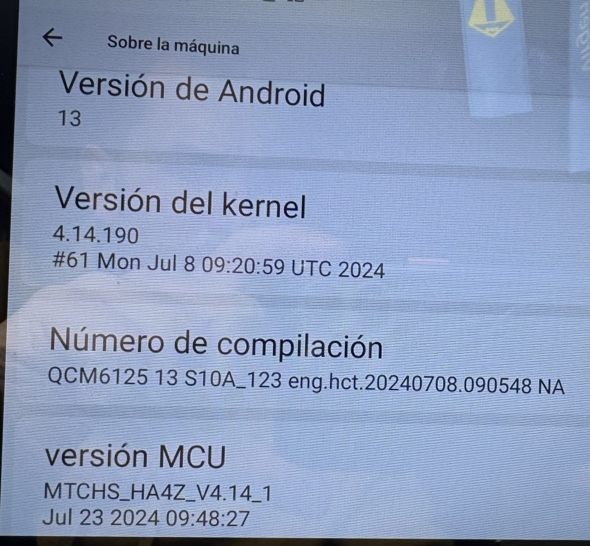

Alber_Chase Hello, I have Android 13, and the PIP doesn't work for me, is there any way to make it work, thank you very much
MihaiFlorin Alber_Chase That version af Android can be easily manipulated. If the producer wants it can show you even android 15. Use the app HWinfo to check the real Android version.
Alber_Chase MihaiFlorin Hello, I have installed the app, and it tells me that it is Android 13, version 13 Tiramisu!

wwest2 Alber_Chase You need to check for the API version through monitoring apps such as Device Info HW.
