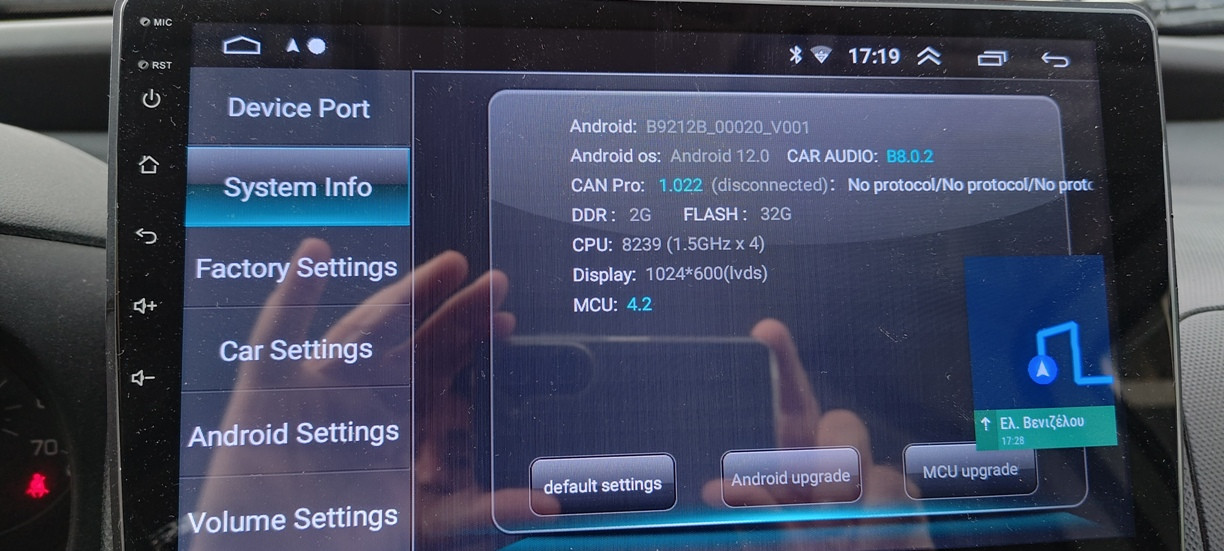

dyvurcz If it's FYT based yes. As long as you don't provide a screenshot/photo with your "about device" info nobody can tell you that.

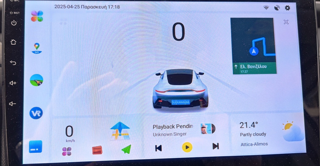

Michalisgk Εχω κανει, αλλα δεν εχει καποια διαφορετικη εκδοση.Μου κανει εγκατασταση την public εκδοση,μετα το firmware update που εκανα, δεν λειτουργει το pip σε χαρτες.Δεν ξερω αν γενικα παιζει αυτο. Θελω pip των google χαρτη μεσα στην εφαρμογη οπως γινεται στο duduauto.
DUDU-Meng It installs the public version for me, after the firmware update I did, pip doesn't work on maps. I don't know if this works in general. I want pip for google maps within the application like it does in duduauto.
avogiatzakis PIP is required to be supported by the system, your system does not support PIP
DUDU-Meng On another Launcher work pip in map, on this one why doesn't it work, since it says work XYAUTO.
avogiatzakis Don't get hung up on this pointless question, the real system of your device is 32-bit Android 6.0 (falsely disguised as 12.0).
You can educate yourself, Android 6.0 doesn't support PIP!
DUDU-Meng Update Firmaware with real android 10. work pip any other app, not work pip in dudu launcher.
avogiatzakis
The PIP displayed in the DUDU desktop is the called system PIP.
There is no way to realize this by APP itself, this can only be supported by the system.
You can download this version, setup/underlayer/choose XYAUTO to test.
If it doesn't work, it only means that your host system doesn't support PIP.
