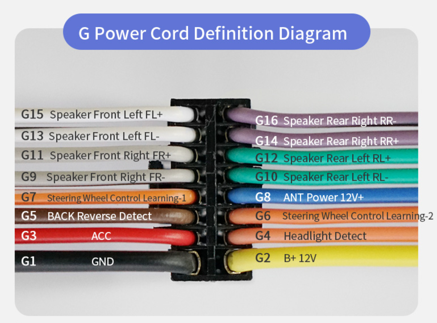

The factory head unit still works fine, and the fuse next to the power connector on the back of the DUDU7 looks fine too. If it's not getting power it would be due to the cable harness. Plugging a device into the USB-c port at the back didn't light up the LED in the device, so no USB power.
Measure G2 and G3 for 12V or more.

        I tested G2 and G3, and found > 12v.
        I then tried again to install the head unit, with the FT02. It actually turned on this time. Sound worked too (although the volume wasn't functioning too well). After 10 mins of setting up things, the screen turned dark again. This time I saw that even though nothing was readable, it didn't turn completely off, it just set the brightness to extremely low, so I could barely tell if it was even on at all.

                    In the video it is visible that G3 is a pair of cables.
                    • One goes to the CANBUS RZ-FT01
                    • Second goes to what seems to be a antenna connector but it the wire is not connected anywhere - it just sits in the connector which does not have anything on the other side (the other male connector coming from the car)
                    So my conclusion is that the G3 signal is coming from the CANBUS RZ-FT01 which I also measured and saw nothing on the meter and expect to see 12 volts when the ignition is on.

                    I started looking closely at the supplied connectors and saw one more black wire pin almost out of its connector. I pushed it back and connected again and for the first time I saw the unit booting. The booting did not finish though - it is now just black screen and I did not see it doing that again. I assume it is in standby now.
                    A new set of cables is sent to my place to fix my current issue of the G3 (ACC red wire) fell out of its connector and I don't know where to put it back. I expect this to be the wire which wakes the head unit up from standby on ignition.
