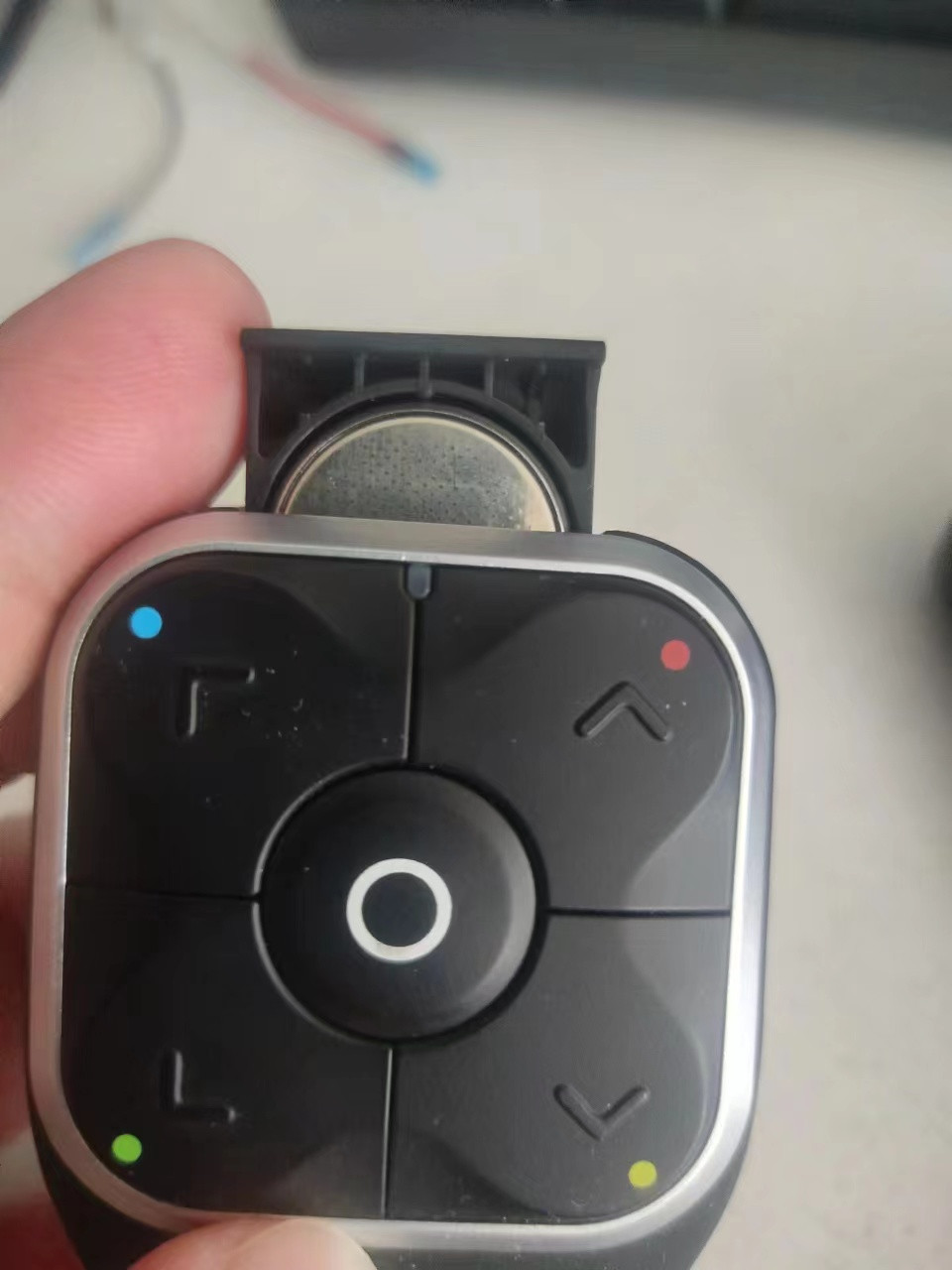

Was this bug resolved? Also have duduauto steering wheel controller with a brand new battery that is not found on my 9.5" 8/128 unit.. I thought it was supposed to just work!
Black6spdZ Can you search for devices with the name ylfk on your phone?
https://wiki.dudu-auto.com/en/%E5%A4%96%E8%AE%BE%E9%93%BE%E6%8E%A5/%E8%93%9D%E7%89%99%E6%96%B9%E6%8E%A7
Phone doesn't see anything either.. No literature explains how to put the damn thing into pairing mode.. Isn't this standard BT connectivity 101?!
found the problem.. a simple one but without ANY documentation it's an easy one to make. The battery was in upside down! I didn't realize it until I finally ran across a post where someone with the same initial problem made note and actually showed a photo of the correct orientation. I double checked the box that the controller came in and besides the fancy cloth bag NO PAPAER instructions at all!..
Black6spdZ After correctly loading the batteries, long press the round button, the indicator will light up
