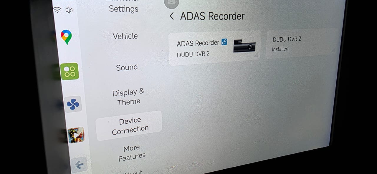

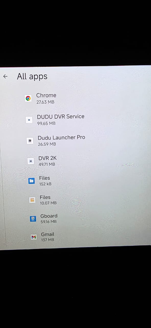

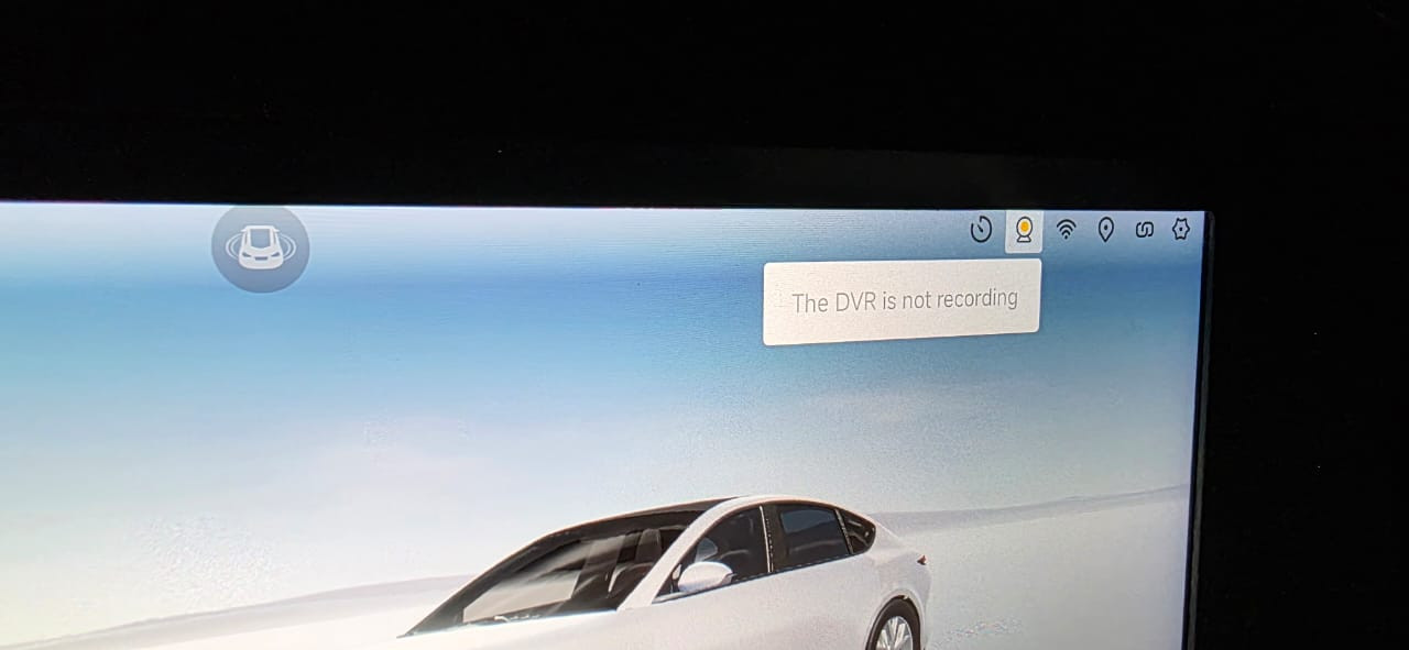

        Just installed the DUDUDVR App with the version 1.001083 and the "coreAdas.apk" (not sure which version)
        If i open the 2k DVR App now it looks like this:
        if open the "DUDU DVR Service" I get this:
        clicking on AR will get me here:
        not sure how to use this app, if usable at all.
