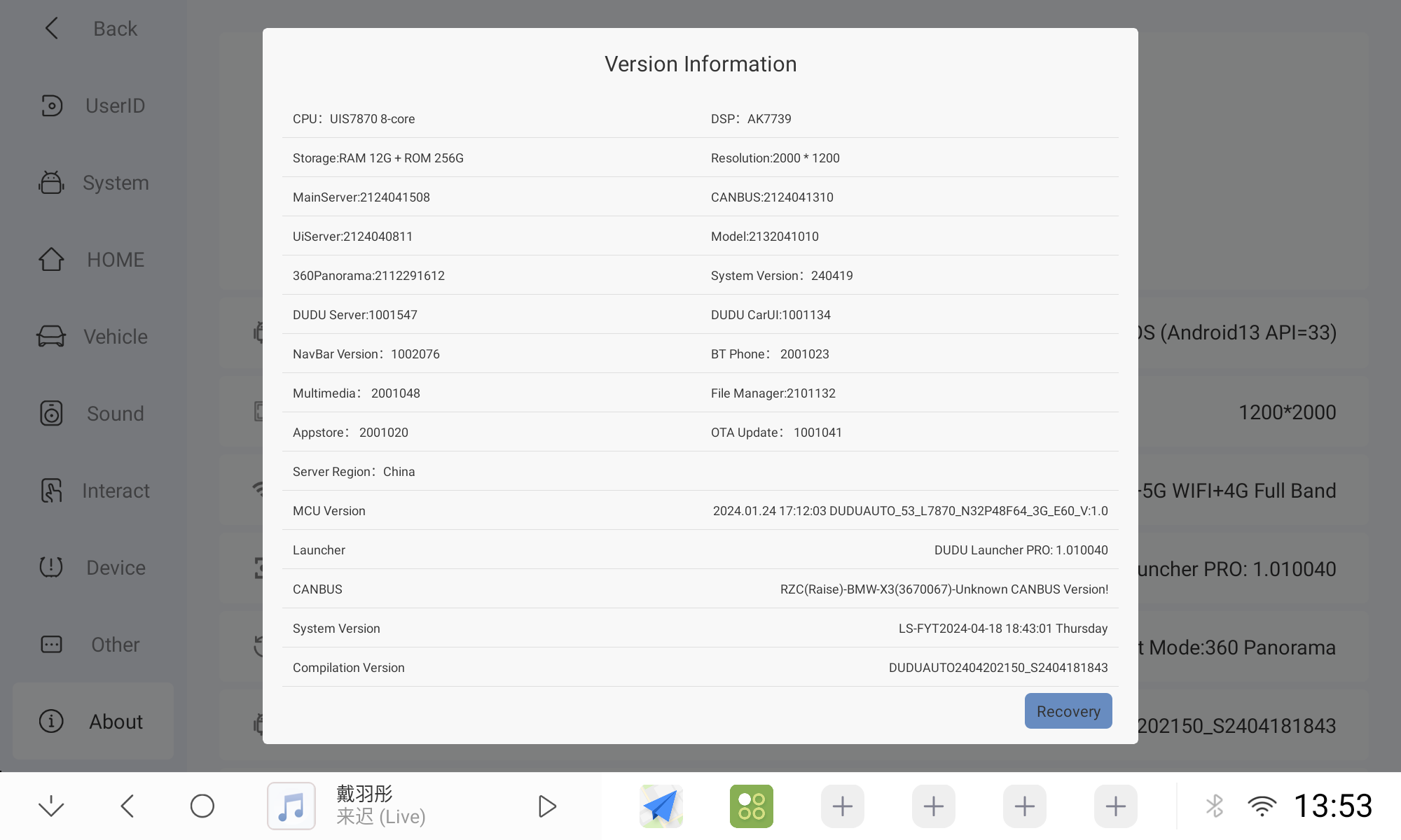

[2] Provide screenshots of system information, in the car settings - about - long press the upper left corner of the picture for 3 seconds, the contents of the pop-up window to take pictures
Version screen and a video showing the problem: https://imgur.com/a/FMClFKN

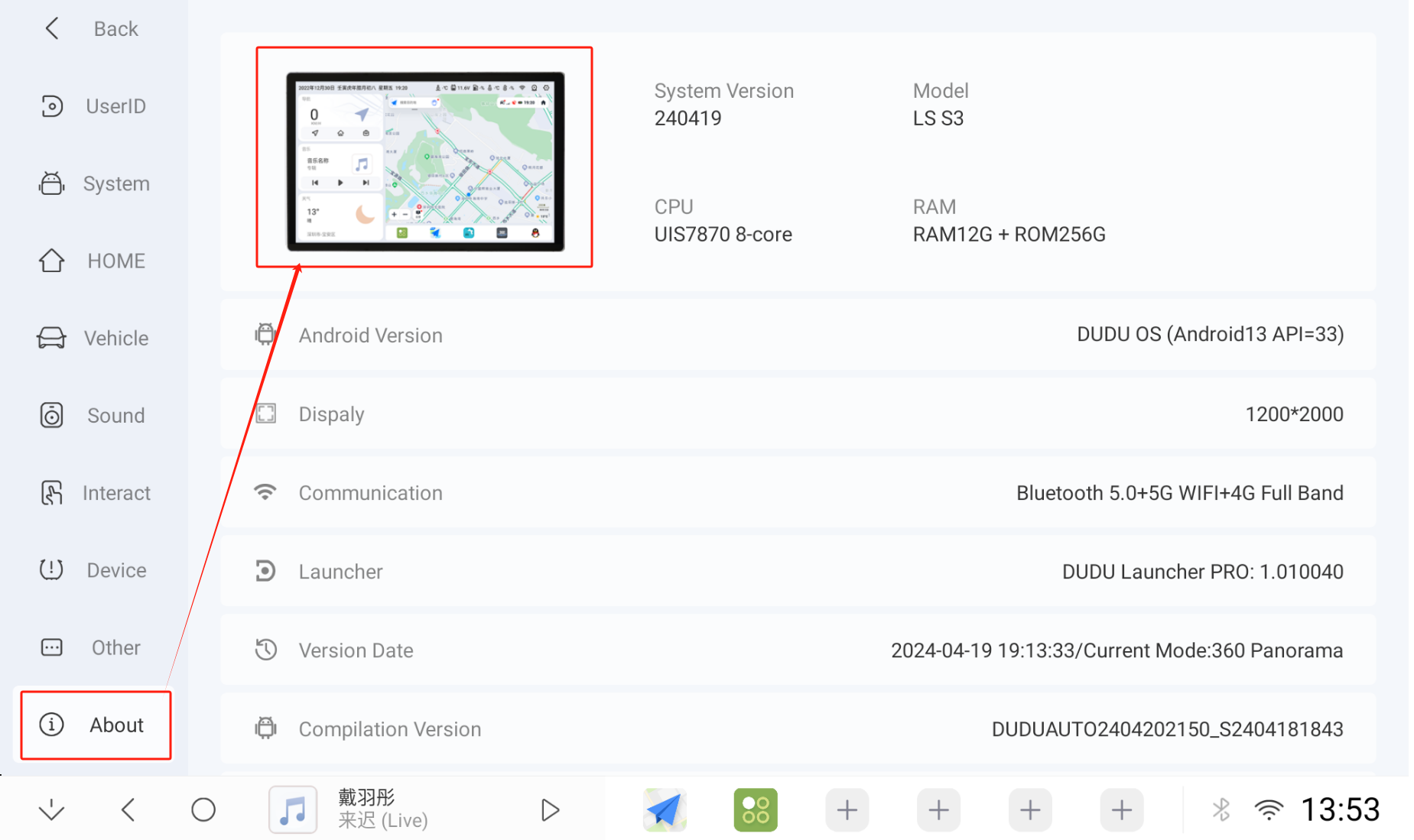

    You need to long press on the small screen so all your device details are shown. With the details provided on your photo, the devs can not do much. In order for them to be able to help you you need this photo.
    To get there just long press on the small display. Like in this photo

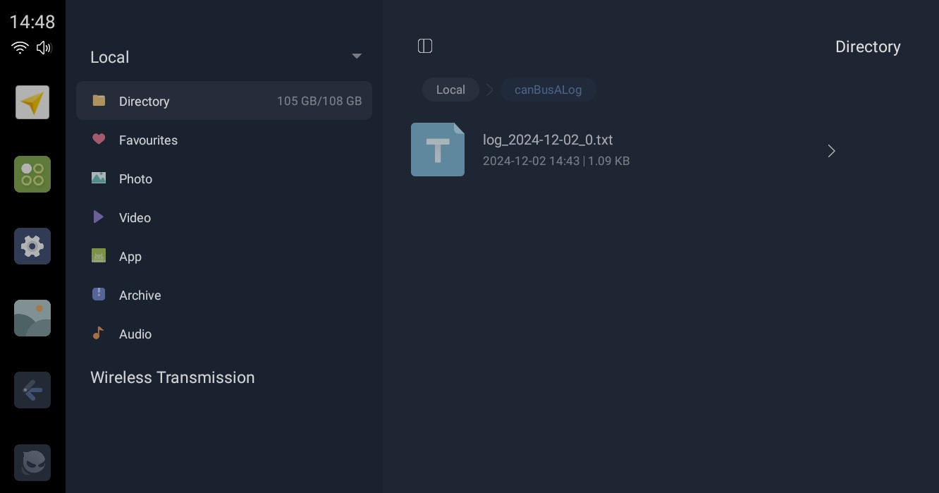

            I've seen a "save CAN log to a file" in the menu. Does anybody know where that log file gets saved? Does it go somewhere on a USB stick, or gets saved somewhere on head unit's internal flash?

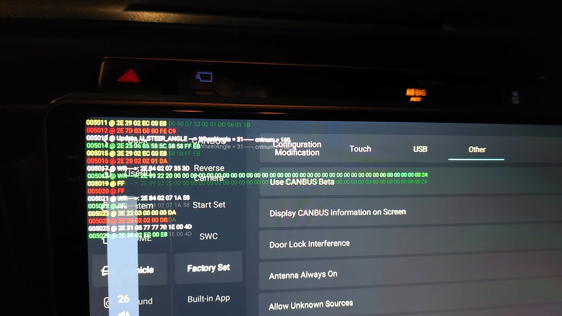

              I think I may be on to something. I've turned on canbus logging on the screen and I immediatelly notice something odd.
              When I press volume control buttons I see the head unit sending two commands back to back:
              @ WR 2e 84 02 07 XX Z1
              @ WR 2e 84 02 07 YY Z2
              @ FF
              According to https://github.com/icarome/VwRaiseCanbox 2e is prefix, 84 is function ID (volume in this case) and 02 is the payload length. 07 is always the same, XX and YY correlate with the volume and Z1/Z2 are checksum values.
              The funny part is that the XX in the first command has the wrong volume value, but YY in the second command always matches the correct value I see on the screen. @FF as far as I can tell is some sort of acknowledgement from the canbox, and that gets us to the interesting part.
              The wrong value sent by the first commend acts rather oddly. At high hanges it decrements by 1, then by two and decrements by 3 at the low volume. That looks as if someone was implementing some sort of non-linear volume control and we somehow ended up trying to set both curves simultaneously. The fact that the canbox usually only acks the last command makes me think that the first command may have been sent unintentionally.
              I wonder why the head unit is writing two commands with a different value back-to-back.

              Below are sample screenshots from the video.

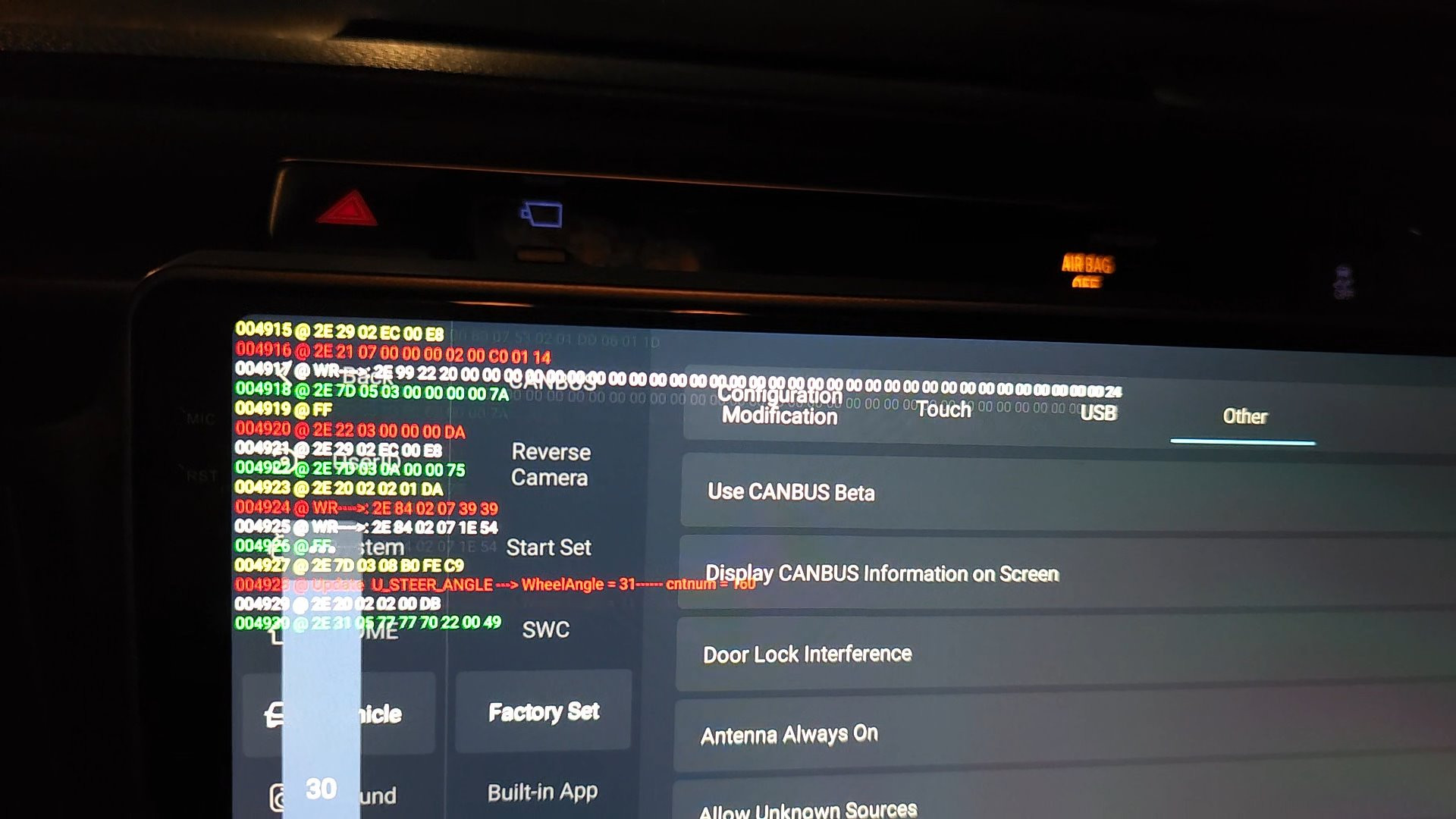

              Normal sequence -- volume=30, two writes with different values, one FF ack:

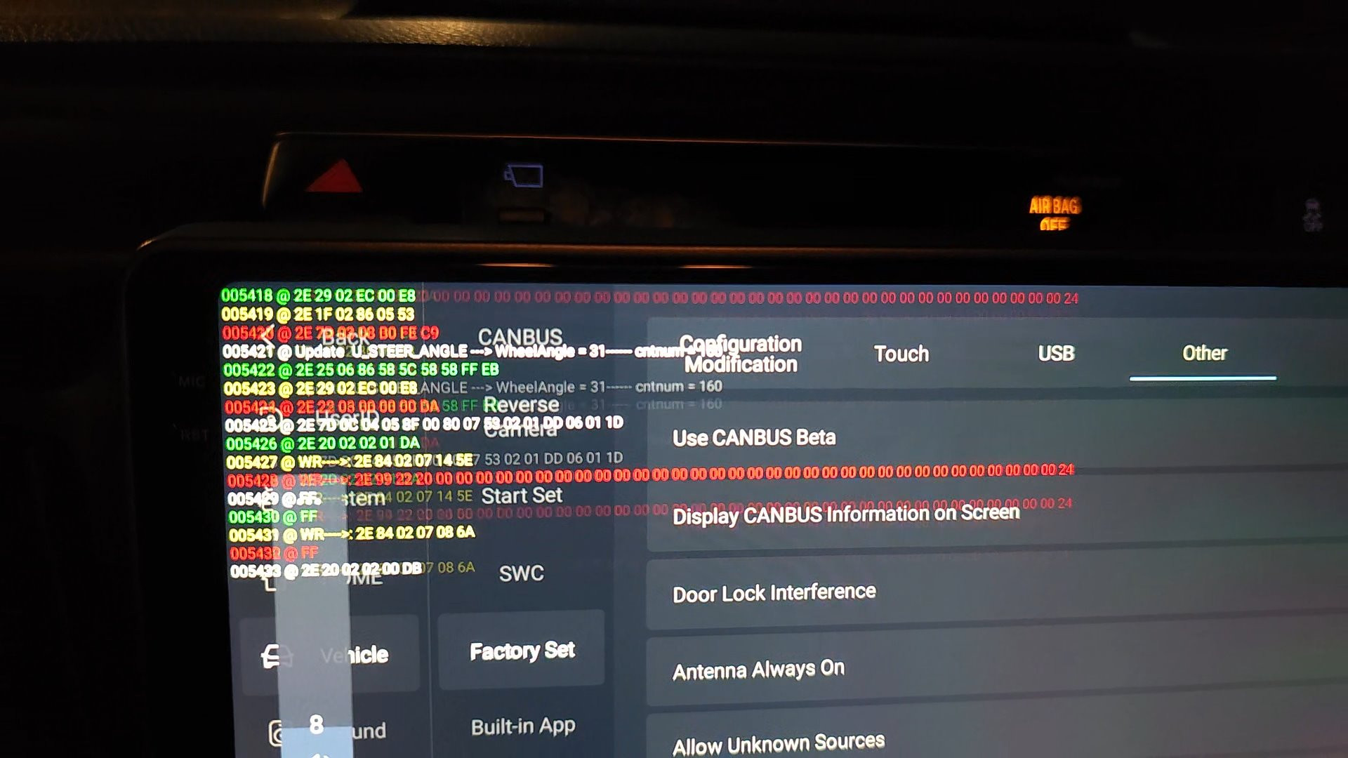

              Volume=26 and volume=8 -- each write gets its own 0xFF ack:
              The good news is that head unit does not seem to be bottlenecked by the communication with the canbox, so my theory that canbox can't keep up with the volume updates was wrong.
              However, that double command sent with different values, and the fact that only one of them is usually acknowledged, suggests that one of them does get lost. Should only one of them be sent?

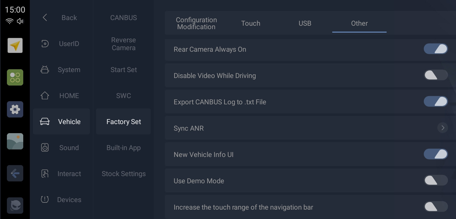

                Open this option Setup>Vehicle>Factory Set>Other>Export CANBUS Log to .txt File
                Adjust the volume and then turn off this option(Be sure to turn off this option when not in use, otherwise it may affect device performance).
                Open the Files app and send the log file from the canBusALog folder in the root directory here.
                Here's the canbus log:
                log-2024-12-03-0.zip

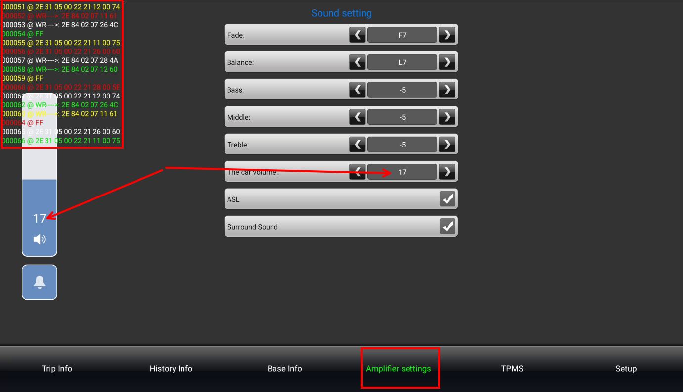

                open the vehicle information-amplifier-original volume, at this time, press the SWC button, when it can be synchronized with the DUDU7
                Even this configuration can be synchronized if I press the keys with a small pause in between (i.e "click, click, click" works OK, but "click, hold" gets out of sync). So, it's not that the currently selected model is always wrong. It works in principle, the head unit sends correct commands, just seems to be unable to keep up if volume changes happen too fast.
                  zzyxy Please go to this screen (Vehicle Information - AMP Settings) and use the steering wheel buttons (click, click, click: one second interval) and (click, long press) to send us the appropriate data. You will need to record the video with your cell phone camera or software and the length of the data should be clearly visible. I submit it to an engineer for analysis
