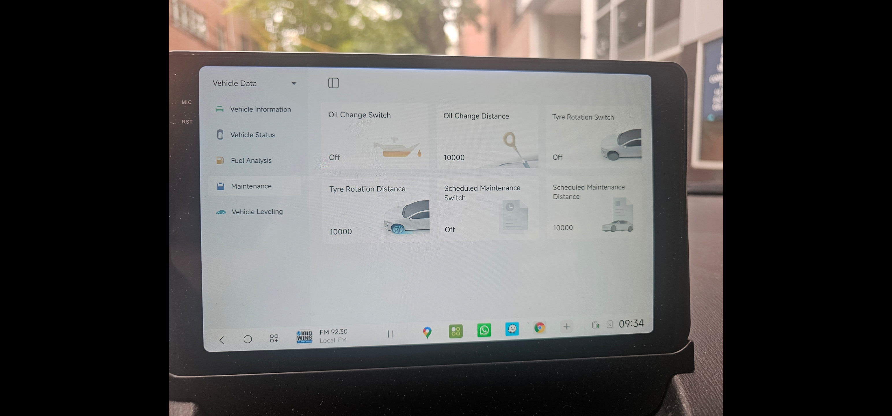

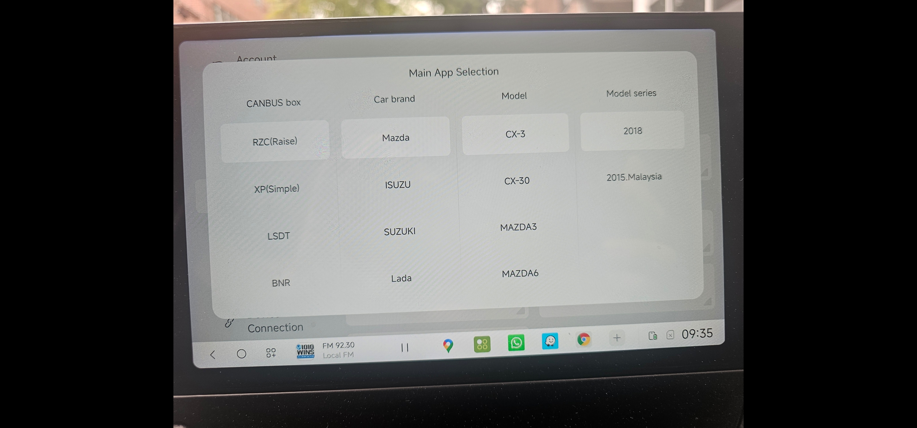

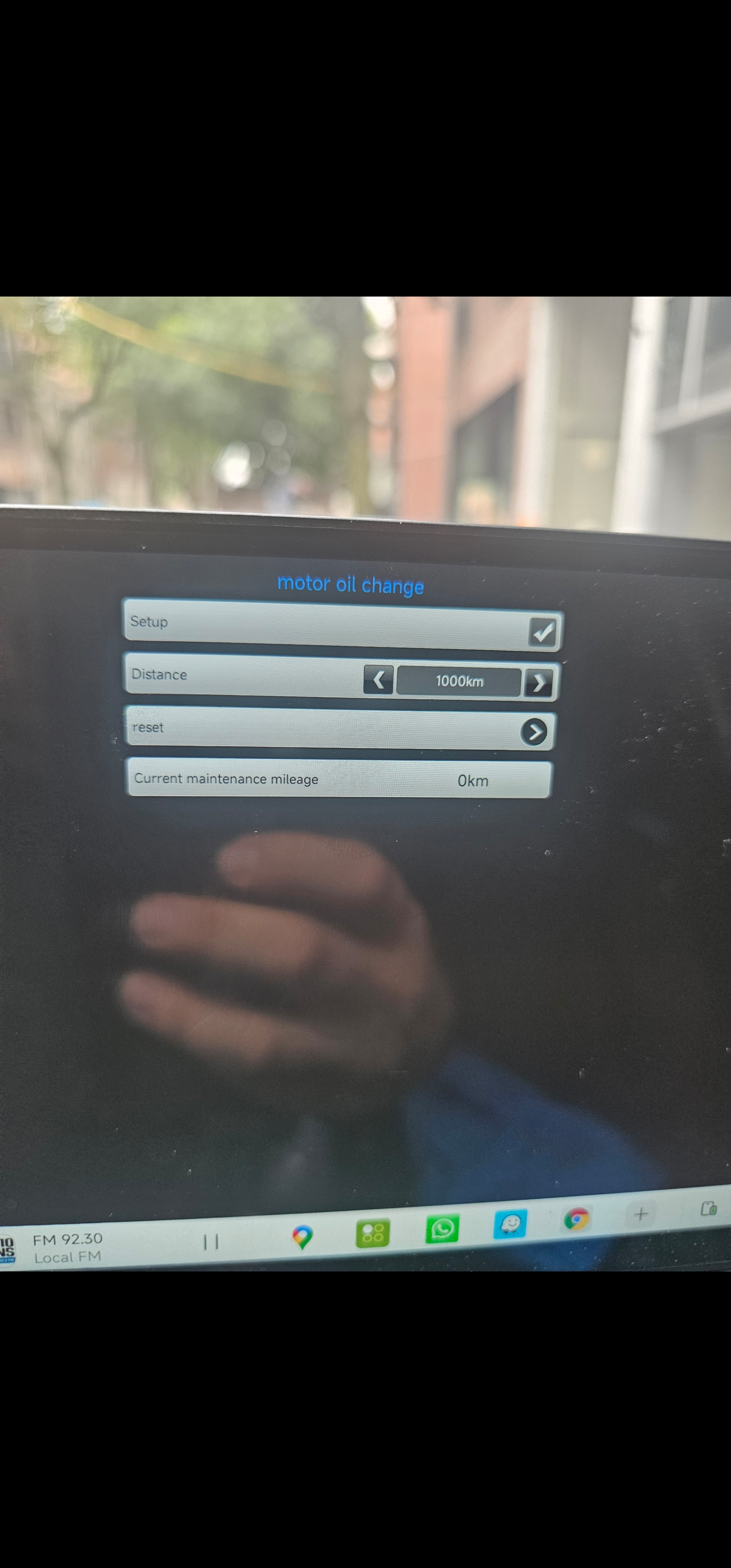

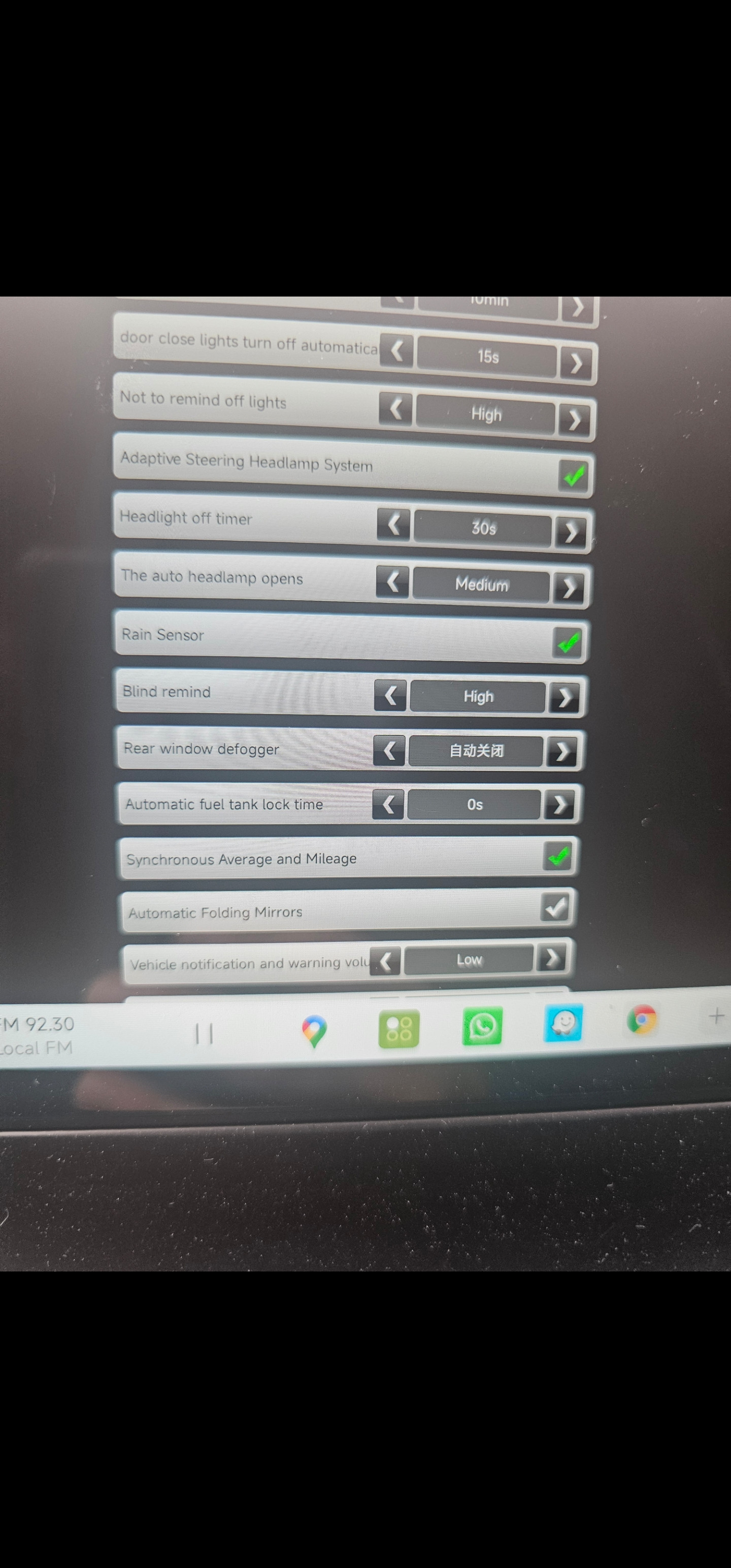

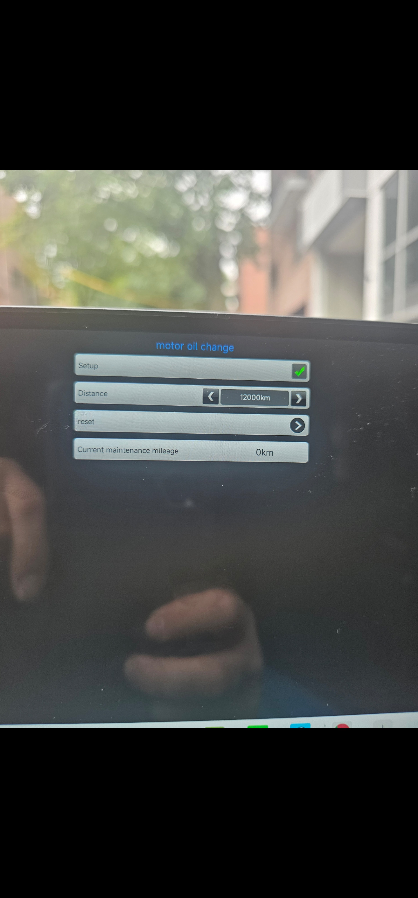

          Hi how can I save the vehicle settings/ vehicle details every time i set it in vehicle settings and turn off the car it resets thanks in advance
          Mazda cx3 2020
            Pickachu47 Do you mean all the settings in the vehicle information? After the settings are completed, if you turn off the engine and restart it, the settings will not be remembered?
            Thanks for the reply not all the settings only the maintenance for oil change and tire change
              Pickachu47 Record a video to demonstrate the problem, upload it to Google Drive, and share it with me for download
