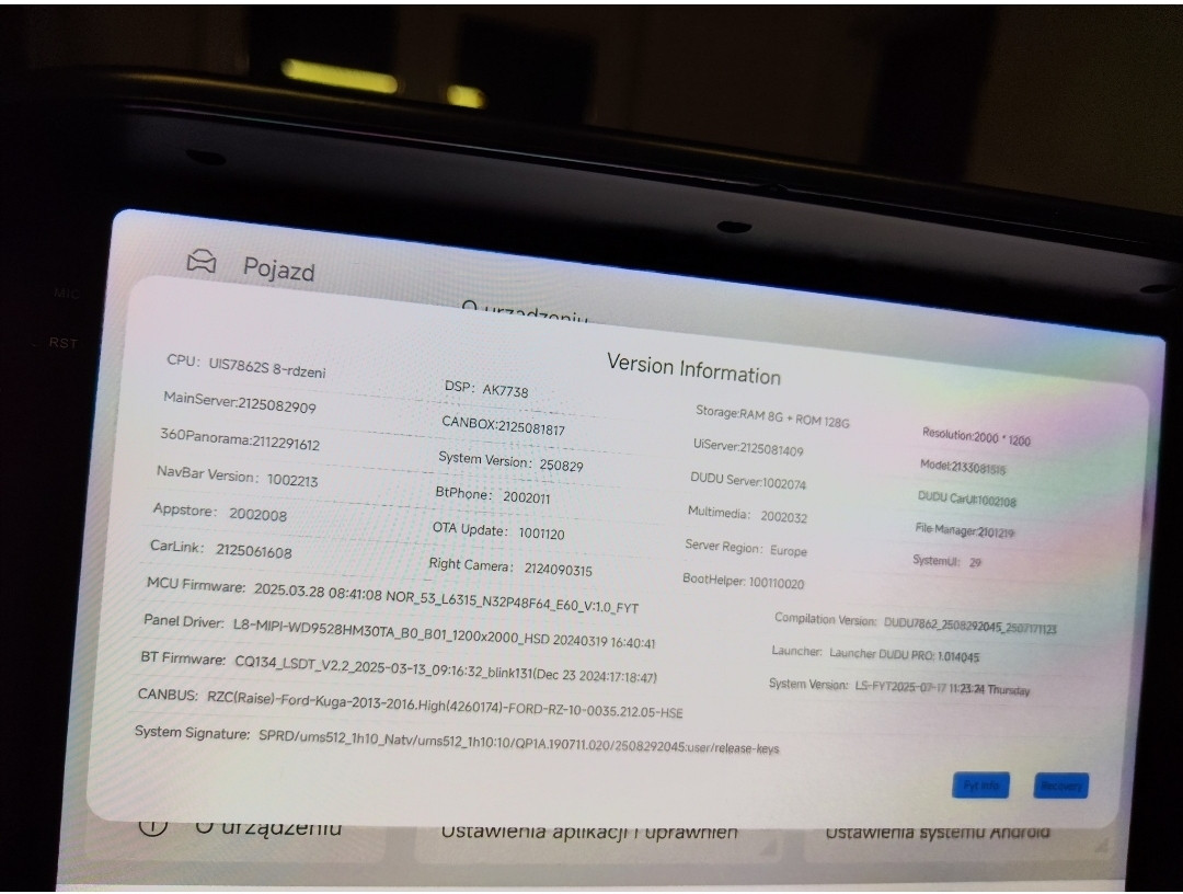

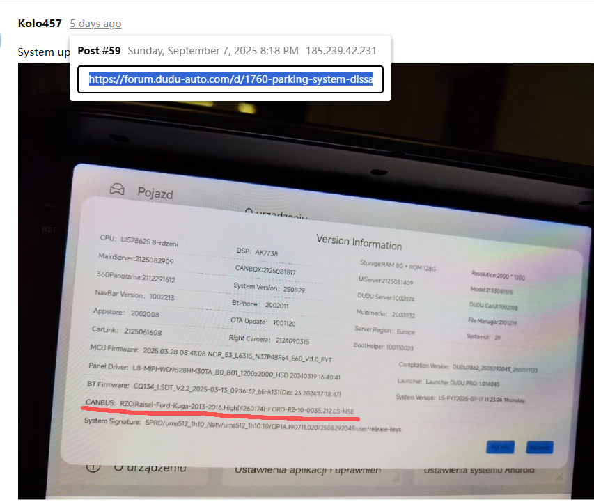

1: The previous animation logic was that if radar data was available but didn't change within 4 seconds, the animation would turn off. When new data became available, the animation would reappear.
2: As you requested, the radar animation logic has been changed to display the animation as long as radar data is available. However, when you manually turn off the radar, the CANBUS box is still sending the last frame of radar data instead of clearing it, causing the animation to persist.
This is an issue with the CANBUS box. I contacted a Raise engineer, and they sent a firmware update. (If the update doesn't resolve the issue, please record the CANBUS log again and upload the video to Google Drive.)
