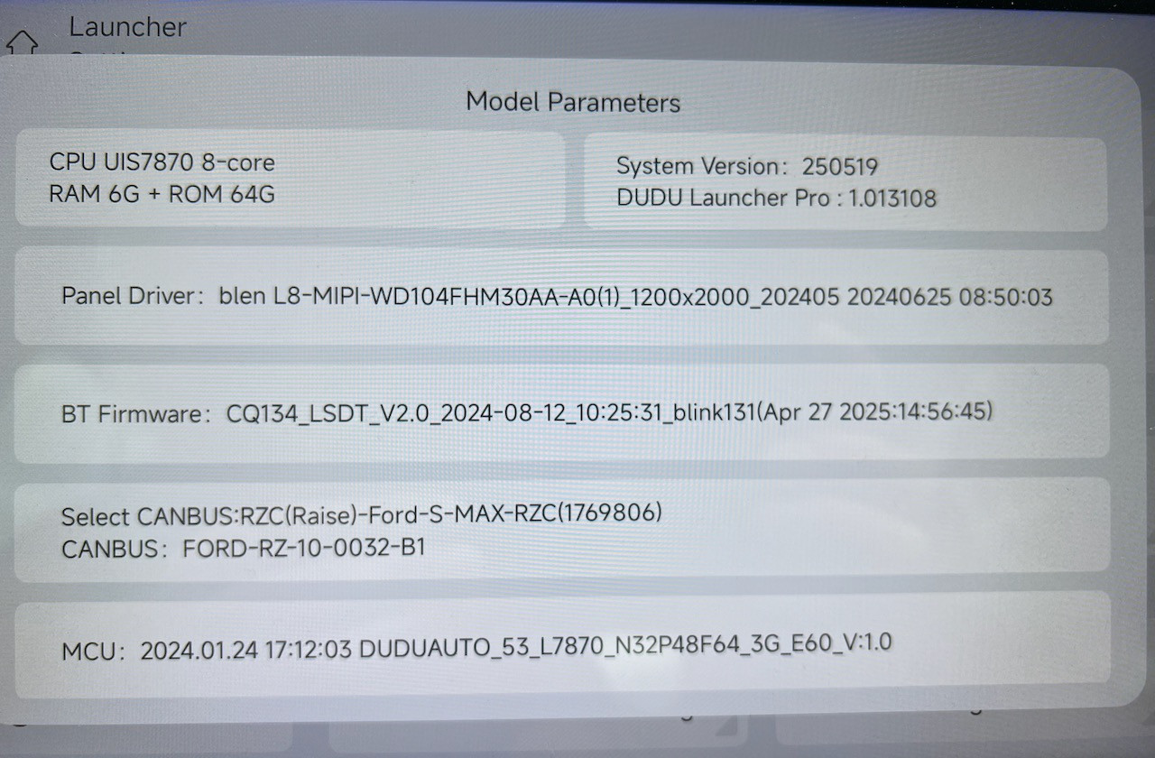

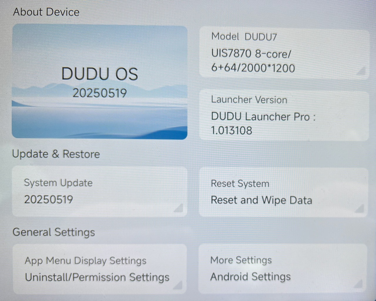

            Please provide a photo of the DUDU system information screen, Settings-About-Hold down the top left picture.
            Also collect model number and IOS version
            Also help catch ylog
