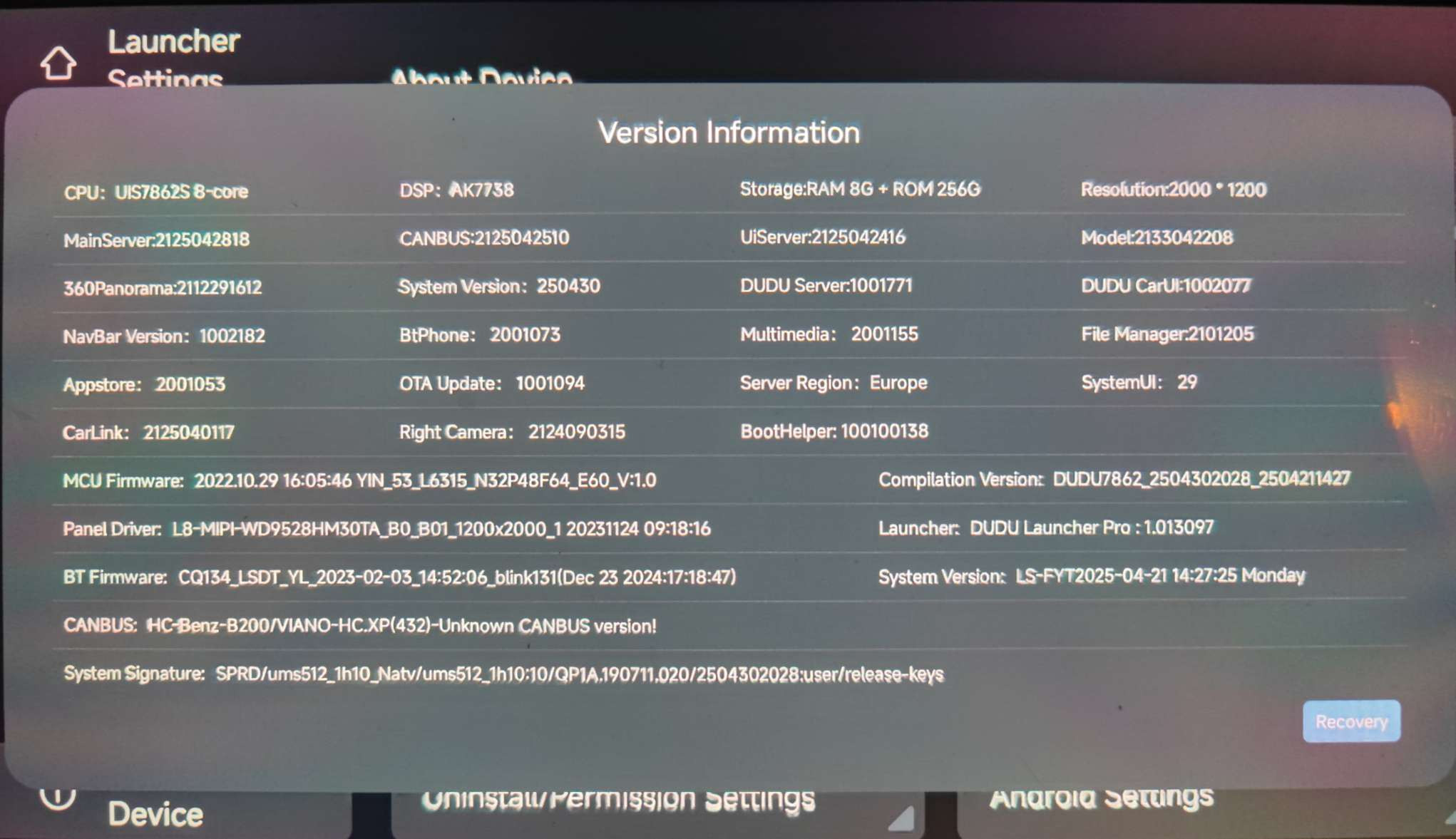

Ryske I updated to lasted dudu OS on a dudu 6 and gps start working whatever the app used doesnt have signsl anymore. While in the previous OS version was working perfectly
DUDU-Meng You are using 250430. The latest official version is 250519. Your question is Are all navigation apps unable to search for satellites?
Ryske DUDU-Meng Yes all navigation app cannot link to any satellite and keep searching. Tried several ones, online or offline doesnt matter no signal. I will try to update then to latest one

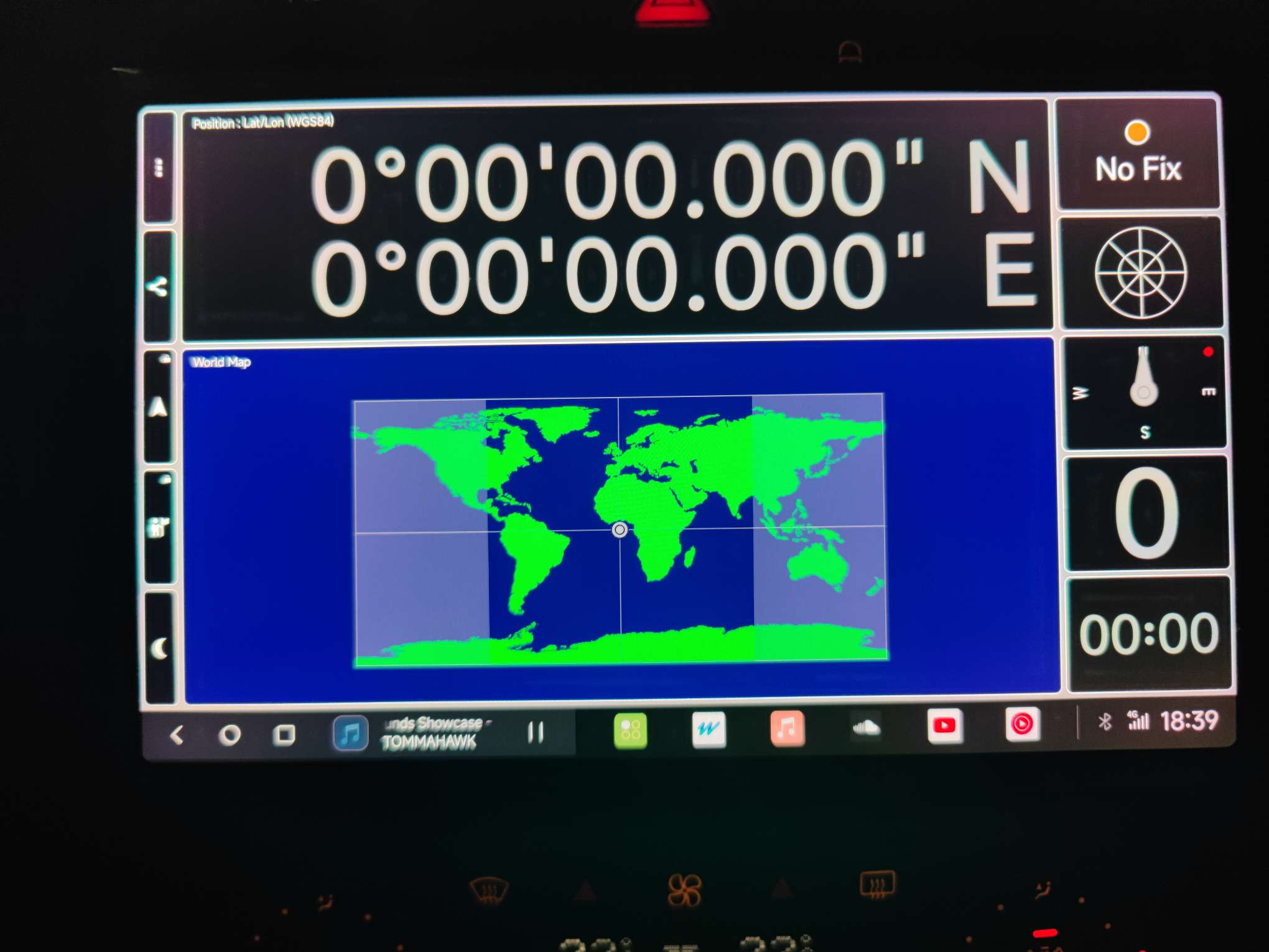

Ryske DUDU-Meng gps signal is off not working. Been like this since update. It goes on for 1 sec when the head unit start then signal off all the time whatever the app. Was also asking if i can downgrade without issue using usb flash methode ? Cause i cant have a head unit without gps
DUDU-Meng Can you tell if the navigation app doesn't have permission to locate, or if the system didn't locate successfully? If you want to downgrade to 3.5, you can do so by flashing a USB flash drive to 3.5.
Ryske There is no satellite menu in factory setting ... I dont understand why it get removed. Therefore with gps test like the image no fixing is made from dudu to any satellite. It doesnt even initiate. All navigation apps same issue. I checked permission all have allowed gps access

DUDU-Meng Ryske I'm very sorry, the logs don't show the problem. Could you please check the GPS antenna, and downgrade test all the time.
