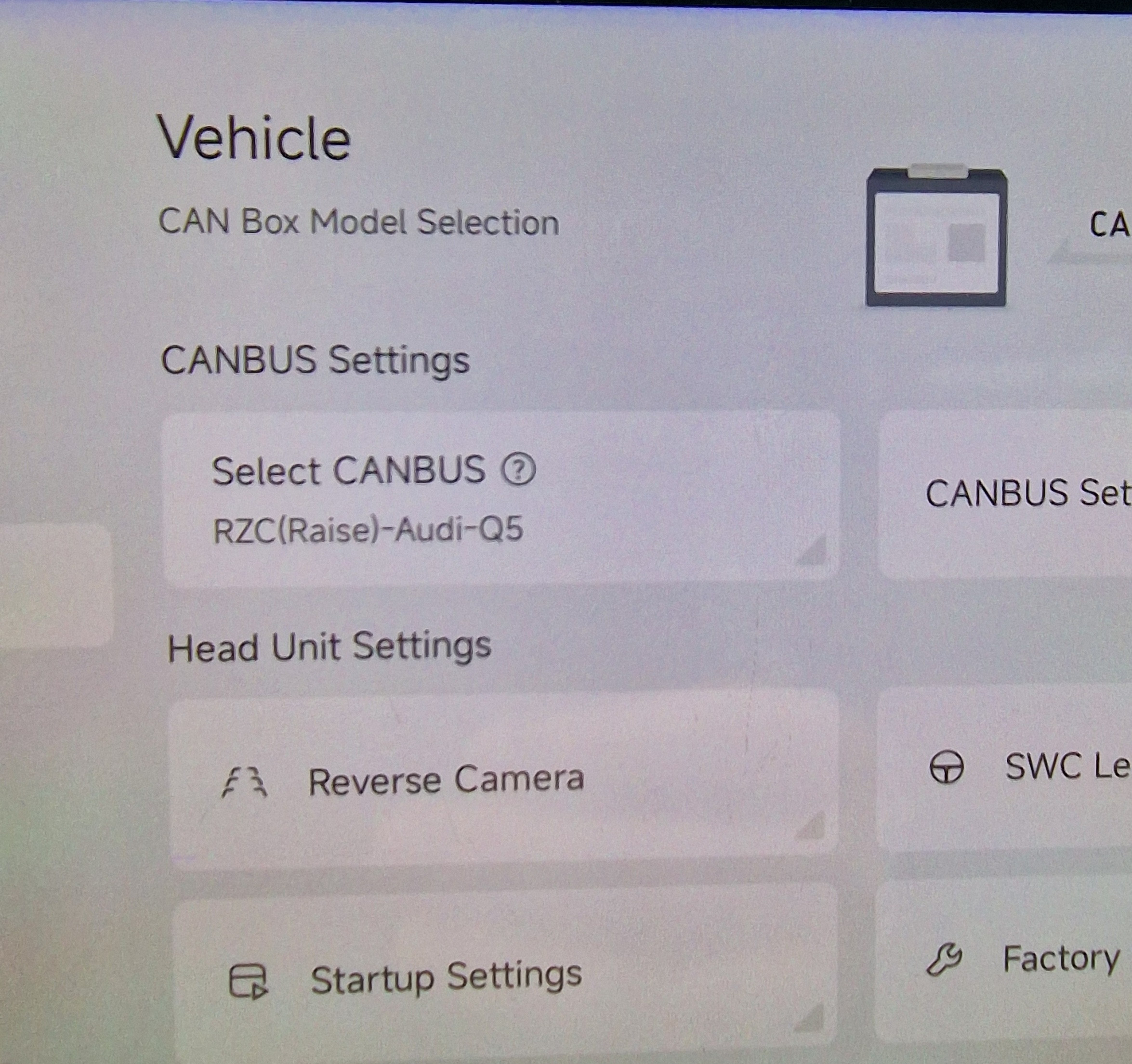

I've attached a screen shot of the modules I've been provided with. I've selected Raise as the module, is that right? The doors are showing as opening and the air conditioning is also showing on screen.

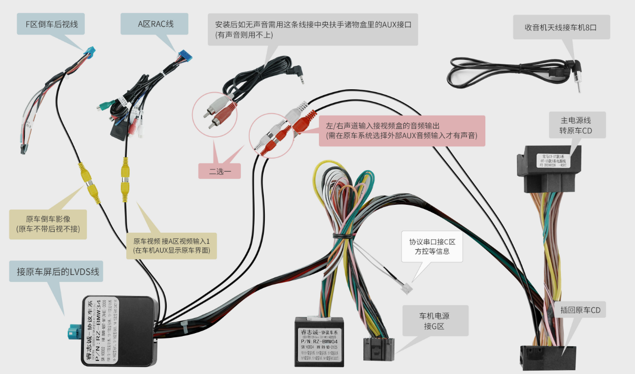

    Stefancapri Display the original vehicle system in the device's AUX application. If it does not display (please check the tulip connector). If the displayed image is incomplete (change the original vehicle screen size and resolution in the settings of the vehicle information application)

      Stefancapri Install external antenna
      Sensor does not display: Which CANBUS is selected?
        18 days later
        Sorry for the delay, I work away. I've done the new os update. No change. The canbus interface is working because I get climate control information.

        Sorry im hoping this will get resolved. Please see photos to what is used.

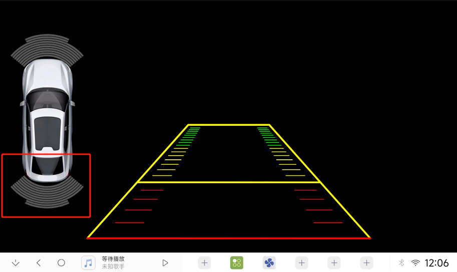

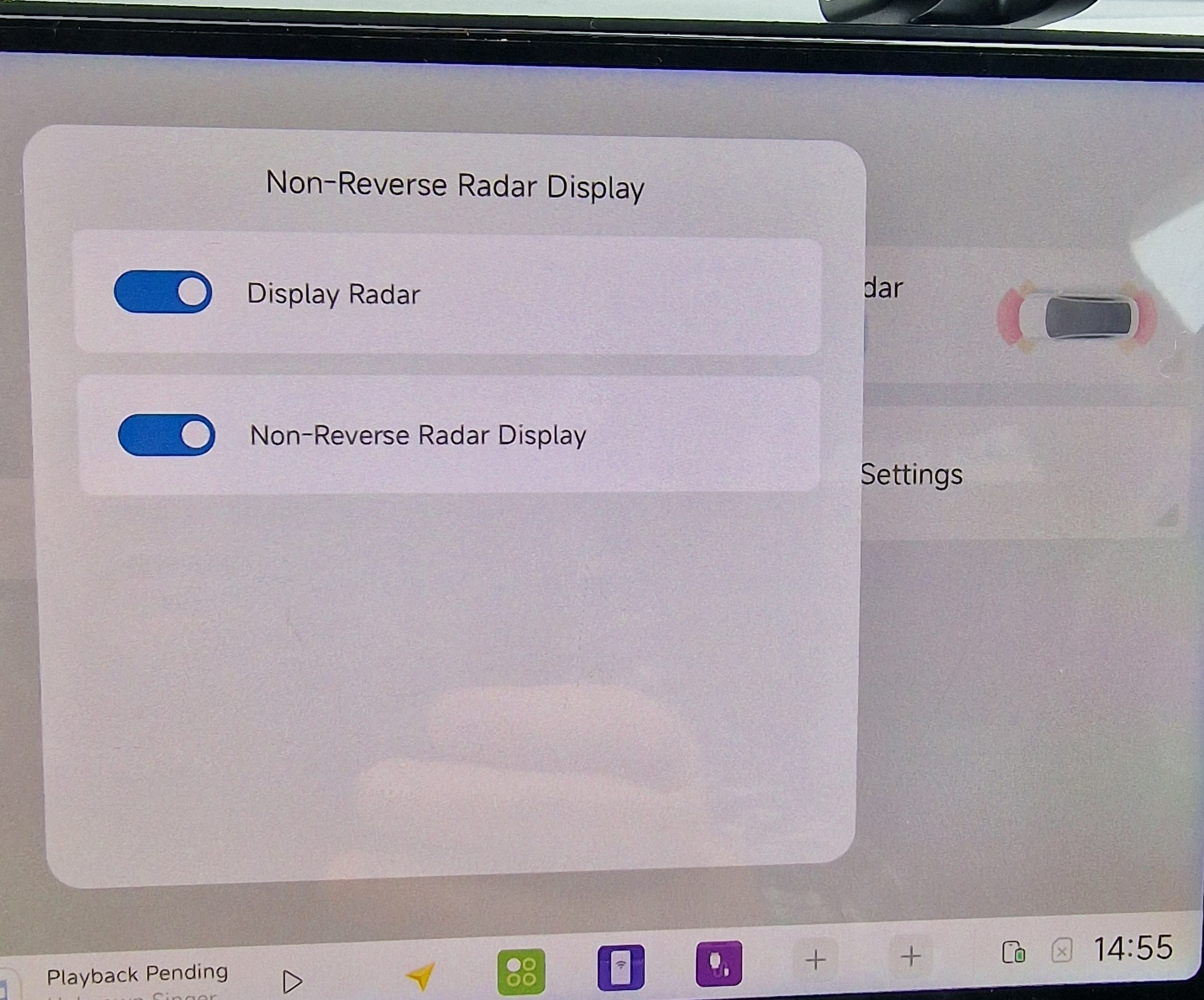

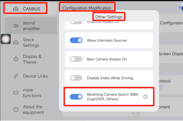

                  Stefancapri In the non-reversing image interface, there is no radar car model when reversing, so the radar information is not displayed.
                  You need to turn on the reversing image screen switch to display the reversing image information here.
                    dudu-lai
                    That setting is selected. It does not notice that reverse gear is selected.

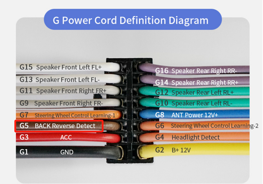

                      Does the G5 have 12V when in reverse?

                        I have checked the reverse wire, I do not get a signal from the canbus box. I've tried un plugging and re plugging it in. In respect to this im assuming its a canbus box issue then? Because the dudu unit has no control of how the box deals with the reverse signal?
                        When i applied the signal to the reverse line it did bring up the reverse camera but still could not see any parking sensor signals. The head unit is definitely seeing the doors opening and the steering angle.
