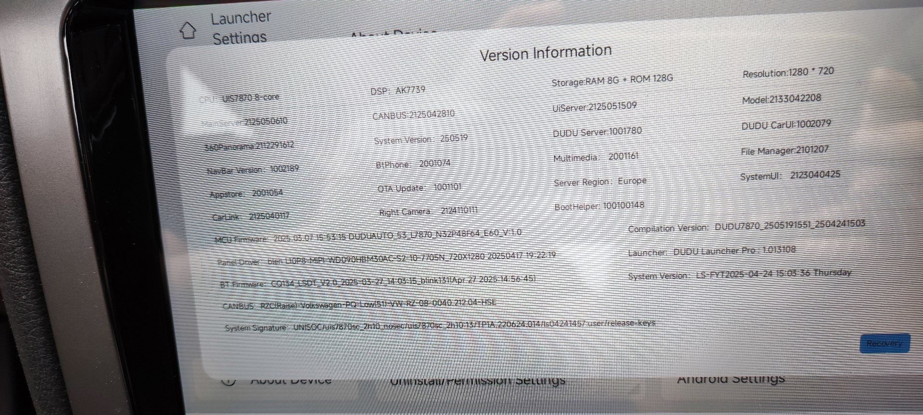

          DUDU-Meng no, I am connected to the internet all the time, I fixed this issue with Rebuild Configuration Parameters , but now it's failed again, so it connect and disconnect all the time, I have attached a video and my system info

              You have selected Europe as your region. Which country are you actually located in?
              It appears to be a network issue.

                  The European service area is in Russia. Switch to North America and try re-registering your account.
                    DUDU-Meng I was changing region to North America and reregister my account, but still the same error,
                    DUDU-Meng Hi, I have found the reason for this fault, I had to change from Norwegian language to English in the Android setting, then the account staying connected, But why is there not possible to have my applications in Norwegian?,

                      Please try installing the latest desktop app manually. If that doesn't work, you can switch the service area to North America and try again.
