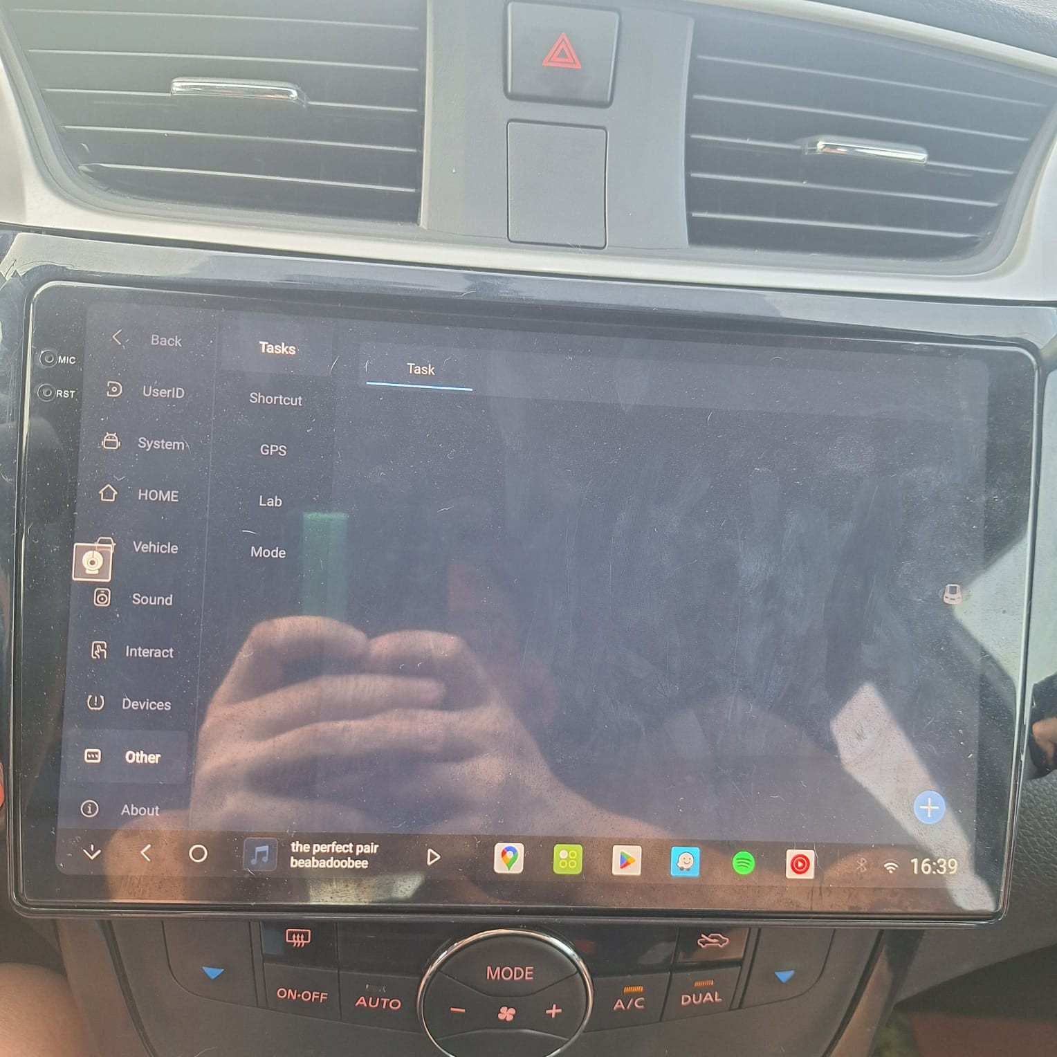

    Setup>More Features>Advanced Settings>Tasks
    What have you set up here?

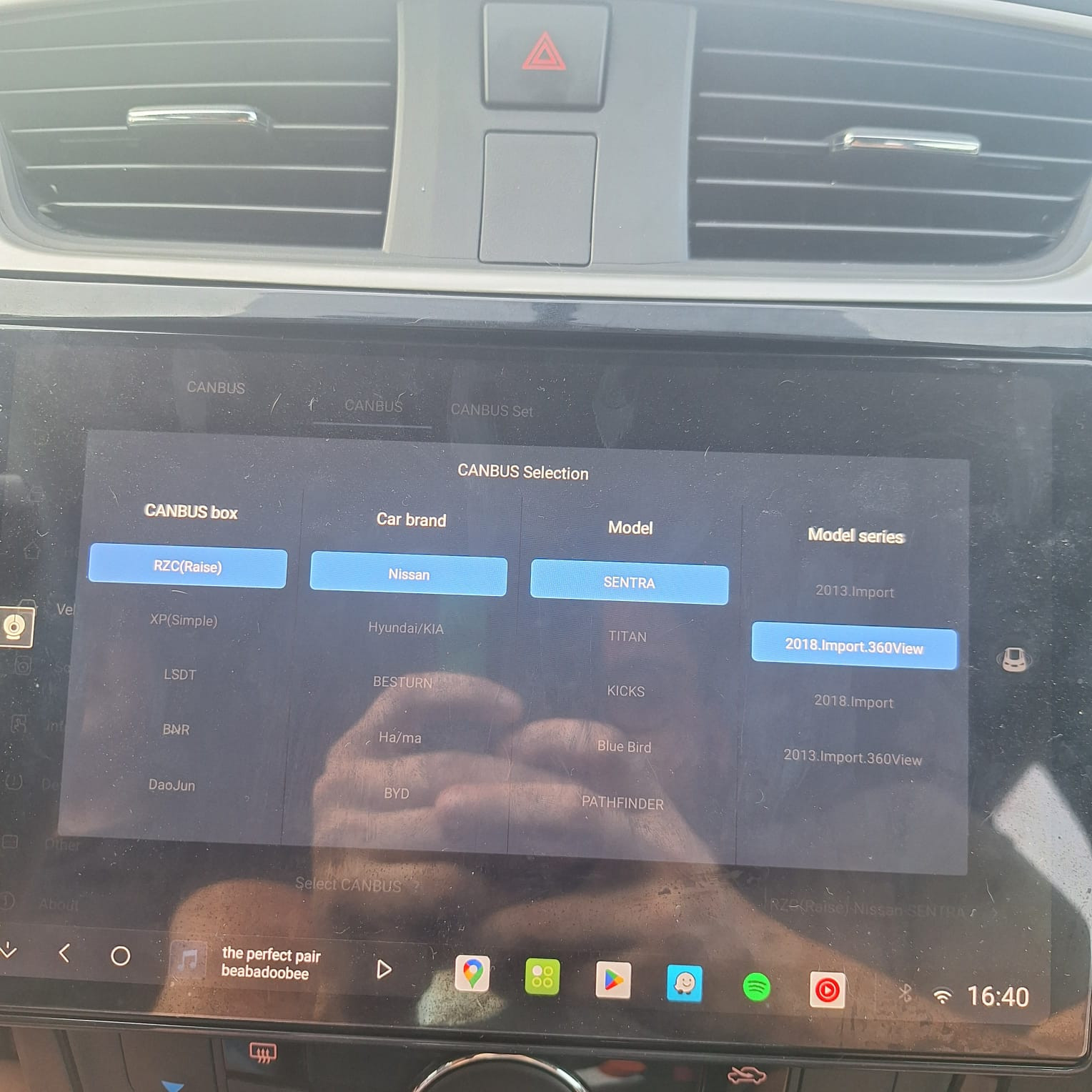

    Theres nothing configured there. I saw someone saying that It could be the CANBUS, that he also have a Nissan, but is not Sylphy/Sentra, my Nissan Sentra is 2017, there are no CANBUS interface available for him in the screen setup. Only 2018 forward or 2013 (Sylphy).
    My SWC does not work, but the rest works fine, 360 camera, door indicator, turn signal.

          Are you using this canbox but have selected RZC?

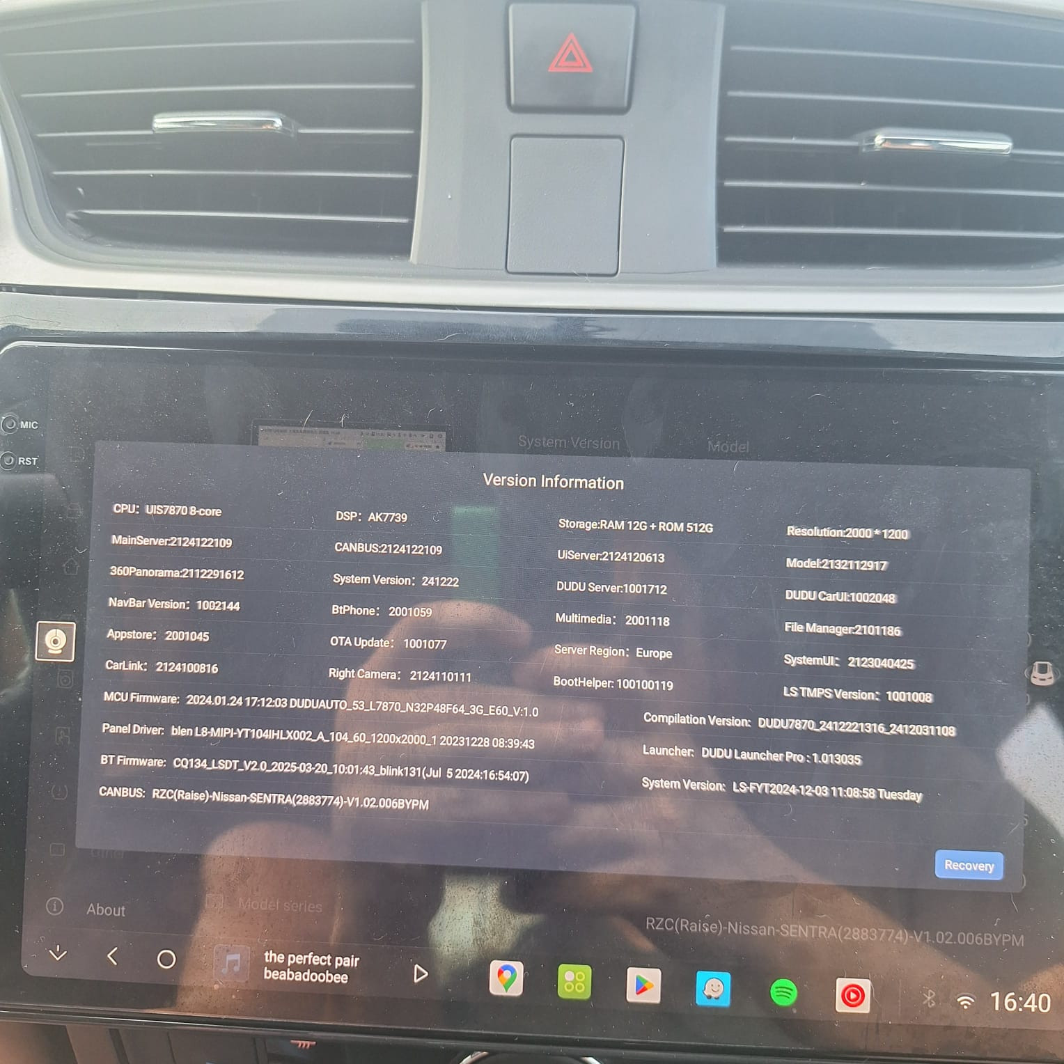

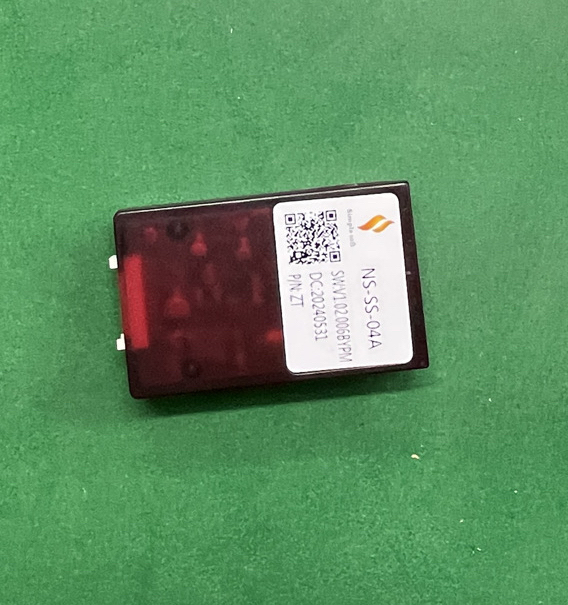

              DUDU-Meng Yes, I thought that was RZC, but looks like is Simple Soft, but I did not find any option for it. Also I tested all options and did not worked.
              DUDU-Meng Do you know what could be the correct option for this canbus? I bought this with the Shenzhen Mekede Technology Co., Ltd. Alibaba store. My car is a Nissan Sentra 2017

                DUDU-Meng Today I tested another Canbox option and the problem with bluetooth was solved. The only issue now is that the SWC is not working.
                There are no issues beyound the SWC not working with this canbox.
                Everything that I know that is comming from this canbus is working fine like:
                Door Open
                Camera (Turn Signal, Door Open, Alert Signal)
                I choose the Simple (Nissan Sylphy 2020 - HIGH) btw.

                  Your CANBUS box hardware is XP (Simple) brand.
                  You should select CANBUS box: XP (Simple), Car barand: Nissan in your device's system.
                  If you want to use CANBUS box: RZC (Rasize) in the system, you can buy an RZC brand CANBUS box hardware.
                  Although the CANBUS box hardware of these two brands can sometimes be used interchangeably, there may be issues in some cases, such as the one we are discussing here.
                  gabrielhcm02 Go to Settings-SWC-SWC button to learn and try
                  I selected the XP (Simple) Nissan Sentra, but there are only 2020 and 2020 HIGH options available, I also tried the SWC-learn, nothing happens. Is worth to tell that my car version is 2017.
