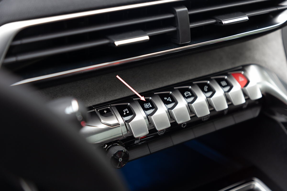

        Hi,
        Peugeot 3008 2016, Raize canbus box.
        On Beta 4, when i press A/C command button on my dashboard, the "old style" A/C control panel show correctly.
        In Beta 5, when i press A/C command button, nothing show, i have to go searching the new A/C control panel manually in app drawer.

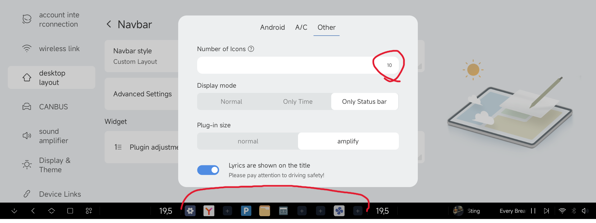

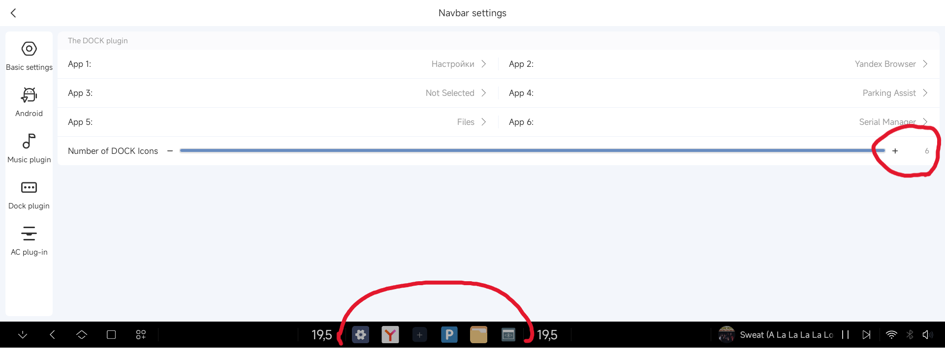

            Хотелось бы чтоб и там и здесь можно было выбрать 10 приложений. 🙂
            А то потом вспоминать приходится где это удавалось выбрать 10 😃

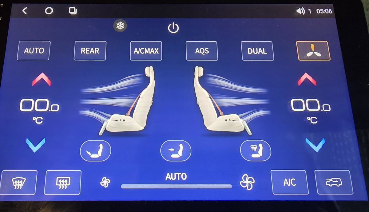

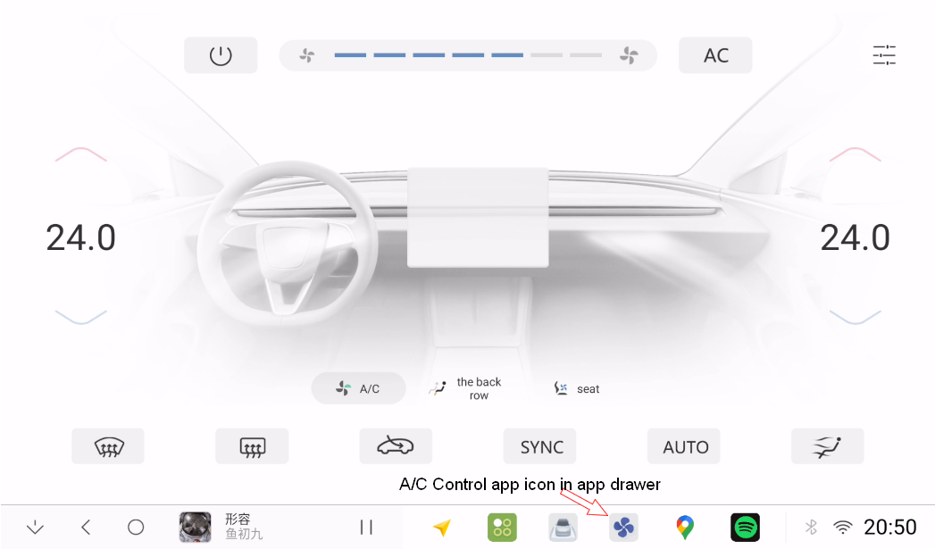

            Hi,
            I can't make videos for moment, but i can describe more precisely.
            In my peugeot 3008, i have this button to set A/C Temp:
            Before Beta 4 and 5, when i press this button, it open the "old style" A/C control panel (picture for example):
            Now, with Beta 5, this button does nothing, i have to go in app drawer to search after A/C Control app to show the new interface:
            The new interface work well, good canbus protocol selected (RCZ, 3008, i've tried all), but pressing button not showing A/C panel ...
            I hope my description was clear.
            If you'd still want a video, I'll do my best to send one to you.
            Regards
