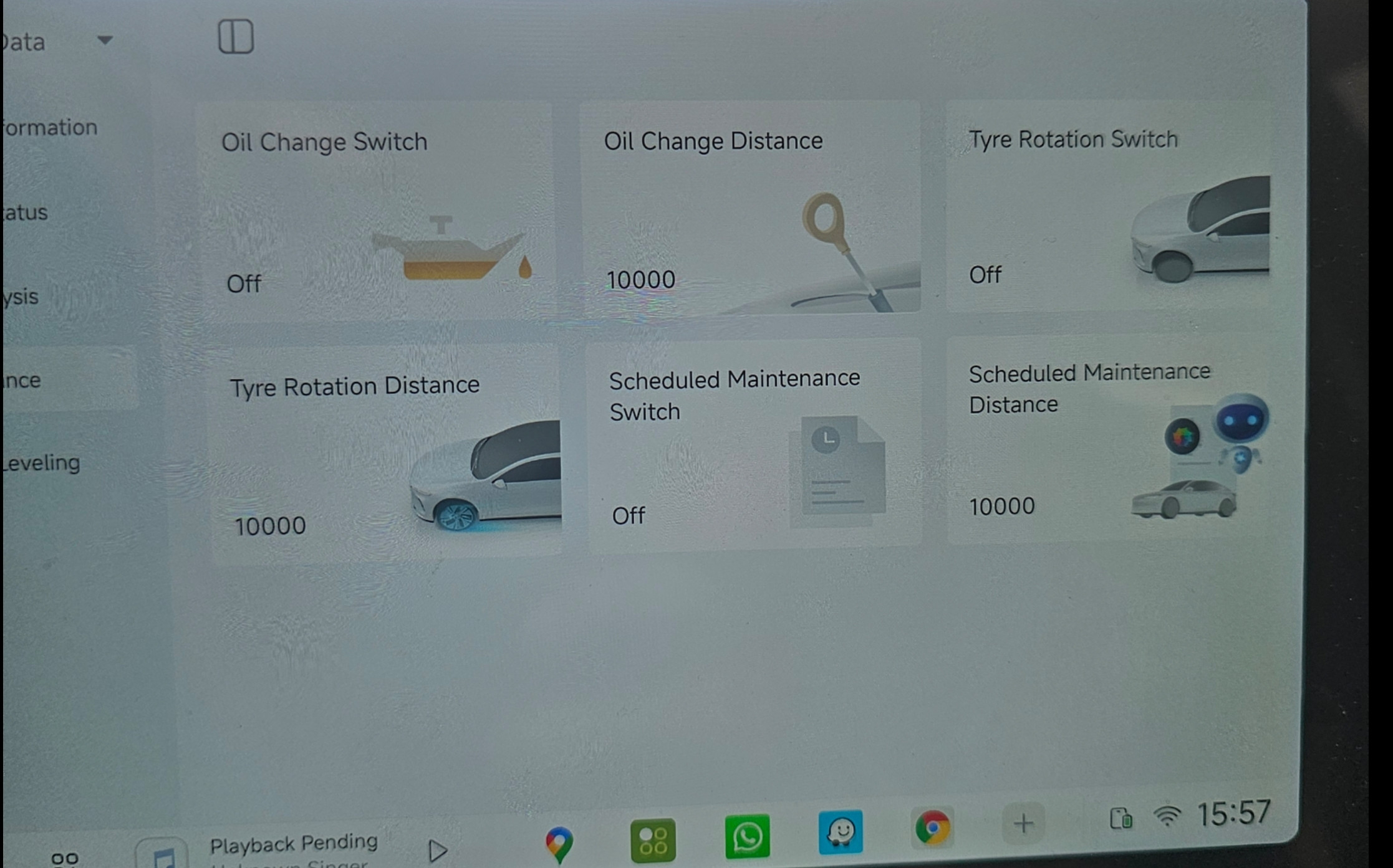

        I updated to the new version I have a mazda cx3 2020 how do I turn on or off the oil change and how do I reset the mileage thanks

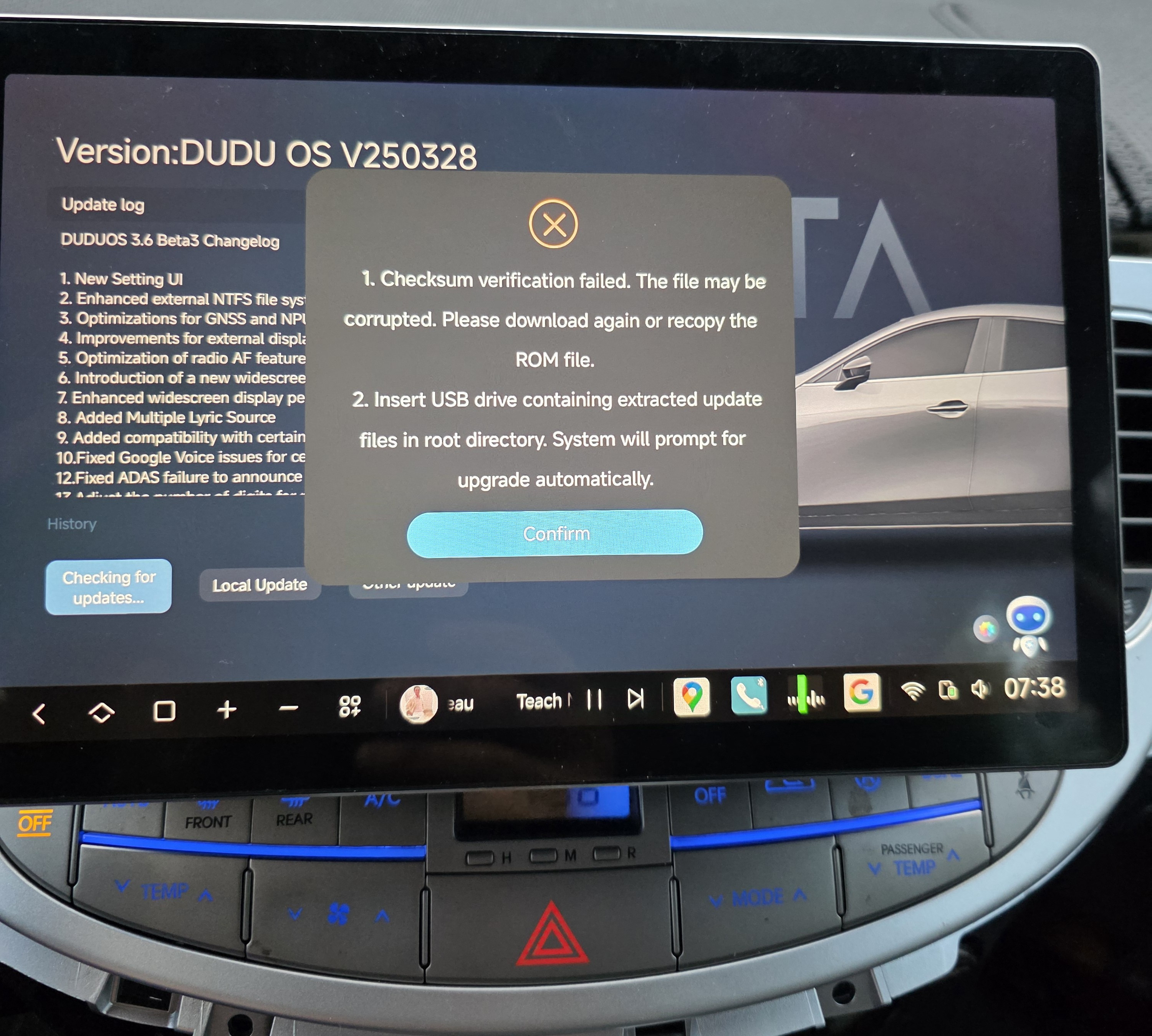

          Having trouble installing DUDUOS 3.6 Beta4 coming from Beta3.
          I have tried:
          • Used 3 different USB drives
          • Downloaded 4 different times
          • Downloaded from GDrive and YDisk
          • Used both USB ports on the US7870 8-Core, 12G+256G, 11.5 2K Head Unit
          • Used my home WIFI and Phone Hotspot
          • I also reset and wiped all data
          • Tried all three regions
          I get this error:
          1. Checksum verification failed. The file may be corrupted. Please download again or recopy the ROM file.
          2. Insert USB drive containing extracted update files in root directory. System will prompt for upgrade automatically.
            Confirm
          Can you help?
          Thanks
          Ernie
          Efectivamente,es el mismo problema que estoy sufriendo yo , no consigo instalar la beta 4
            erniemon As it says in the description: Beta versions neither support OTA nor updating offline using the intact 7z file. So do as point 2 of the popup states: unpack the 7z to the root directory of a FAT32 formatted USB stick and plug that and wait for the prompt.
