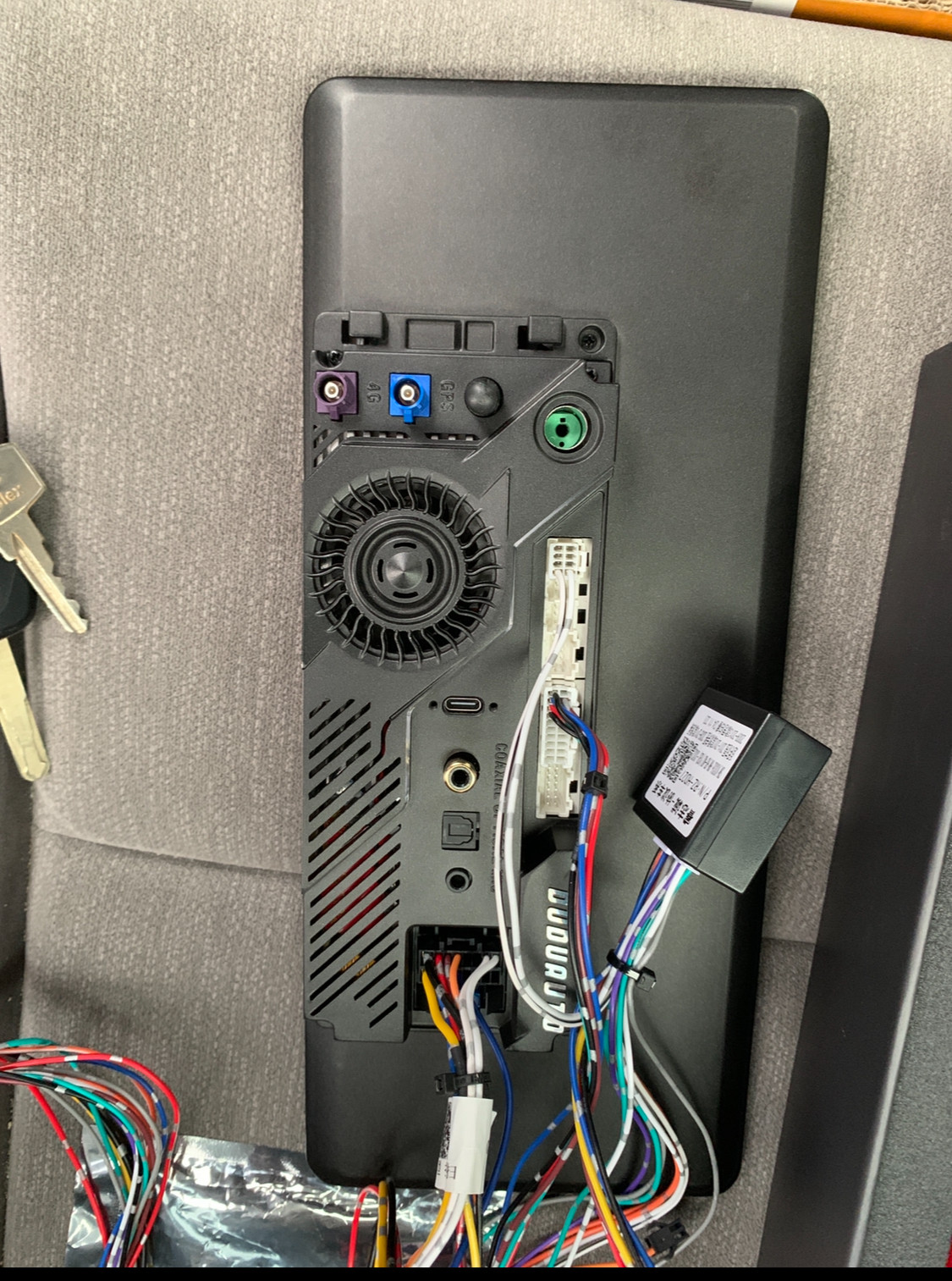

I have purchased DUDU 7 for my Honda Accord 2008 and it cames with canbus ( Raise RZ-HD27).
The only function that seem to respond is the steering wheel command for volume adjustment. Unfortunately, other features such as the reverse camera, ACC control, temperature adjustment, and door sensors remain non-functional. Any advice or suggestions on resolving these issues would be highly appreciated.

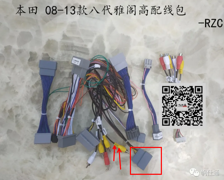

My car has no factory camera so I purchased the dudu camera

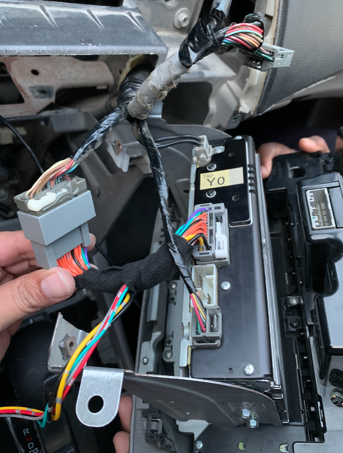

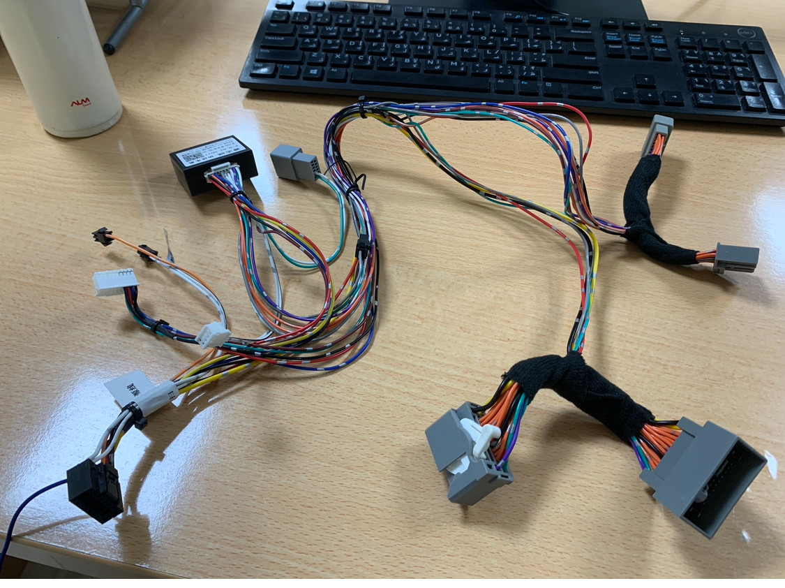

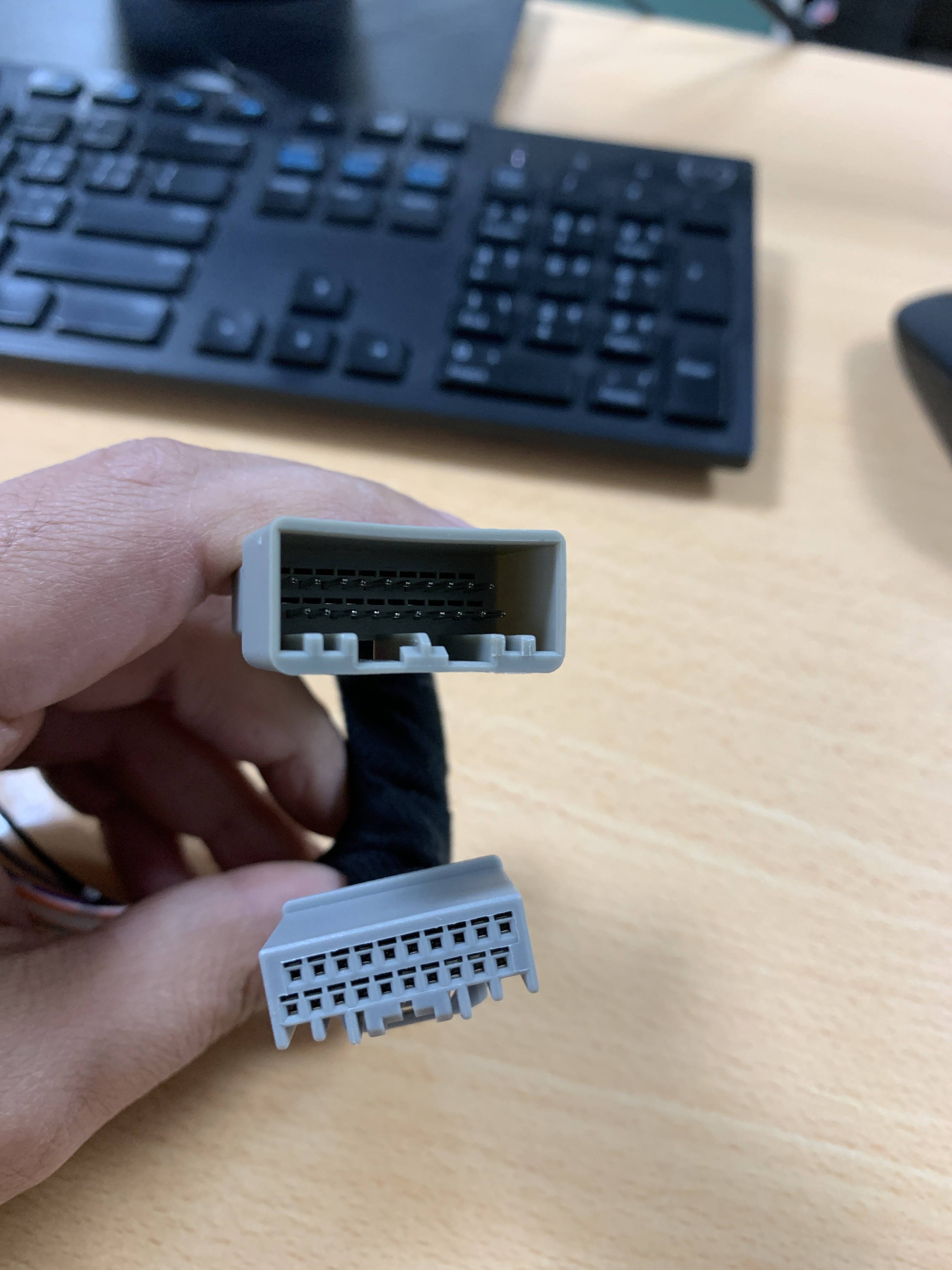

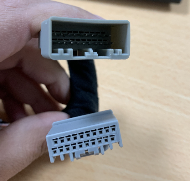

And this is cable that I got
This harness not fit in my car radio at all and I noticed that there are 6 wires form the canbus connected to this harness

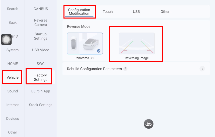

DUDU reversing camera connection tutorial
https://wiki.dudu-auto.com/en/installation/reverse-camera
You also need to switch to reverse camera mode in the settings

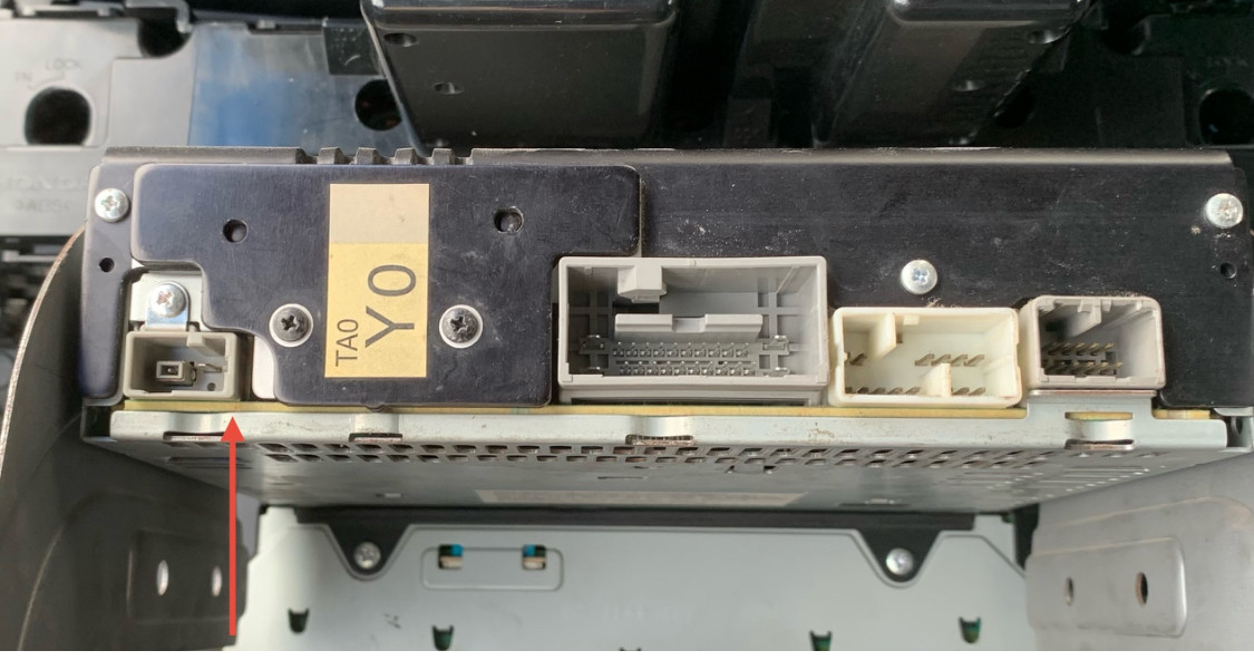

I believe yes 12 pin

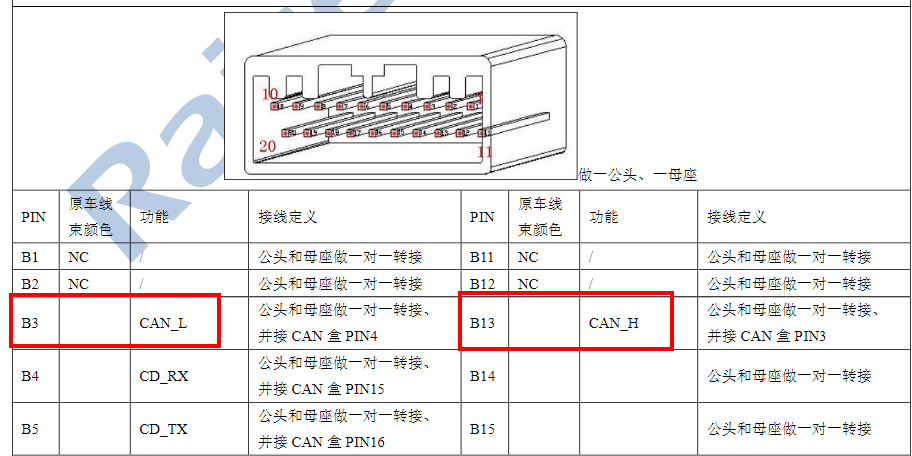

This connector contains the CANBUS cable, if the original host does not have this connector, there is no CANBUS cable (and therefore no door information,).

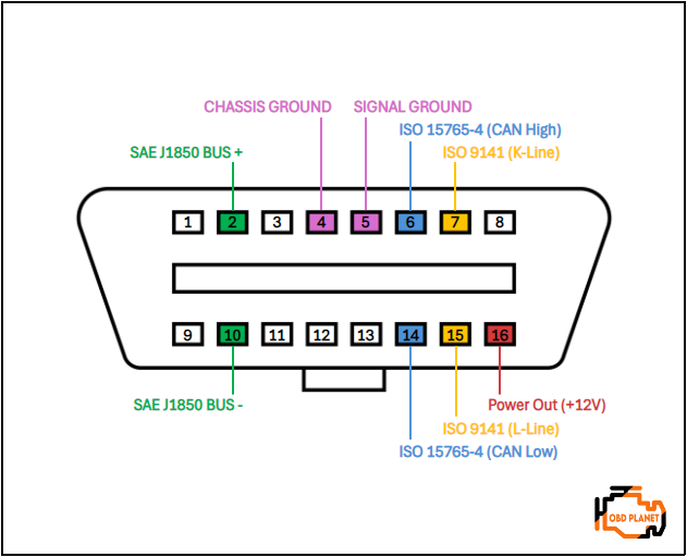

ok, is it possible to connect the CAN-L & CAN-H wires from the canbus to the ODB port to get this information

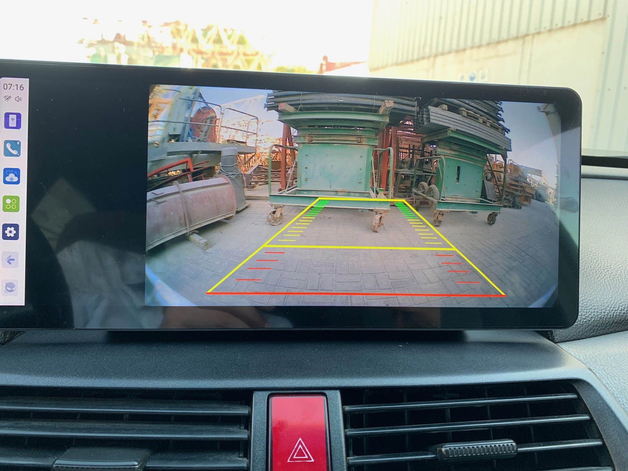

Hi,
This is the dudu AHD 1080P camera, as you can see the resolution is really bad.
is there setting to be configure?
