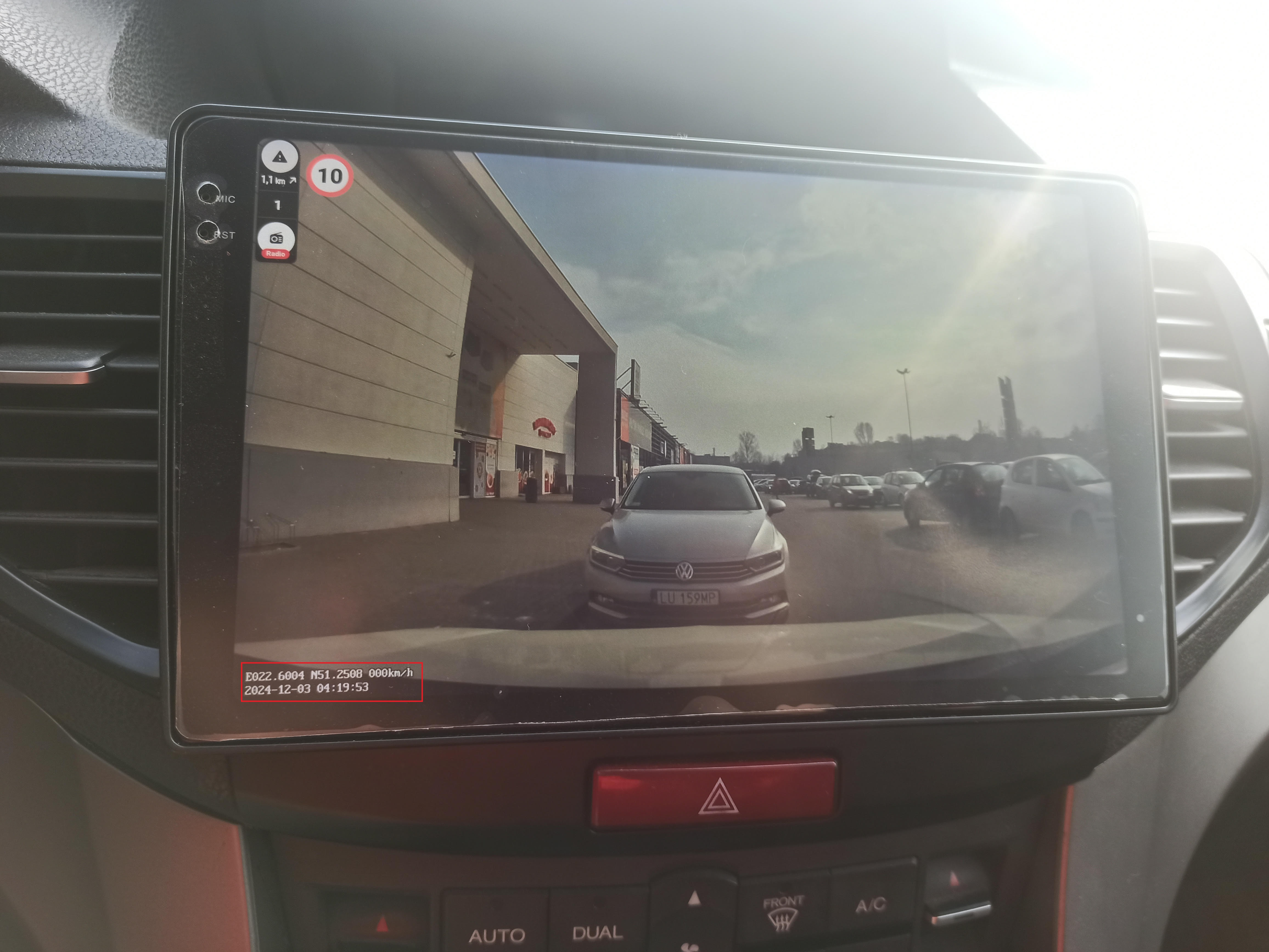

I made a photo of a problem.
Sometimes coordinates and gps speed as well as date is not working.
On this photo there are coordinates and gps speed but date and time is not ok.
This happens when i start car and radio when im in garage and there is no gps signal.
When i drive out and get gps signal, coordinates and speed starts working but date doesnt.
I have to restart radio when im outside with gps signal to ge it work.
Any idea why?
It doesnt refresh gps info or something?
Anything can be done with it?

The logger hardware does not have an autonomous GPS search function.
Speed and time are read from the car system, after the car system sleeps and wakes up, the system time will be updated from GPS only when the GPS position is successful.

It is kinda annoying that I have restart unit or unplug and plug recorder again to make it work when I start with no gps.
Like I said I start car in garage and obviously there is no gps indoor.
