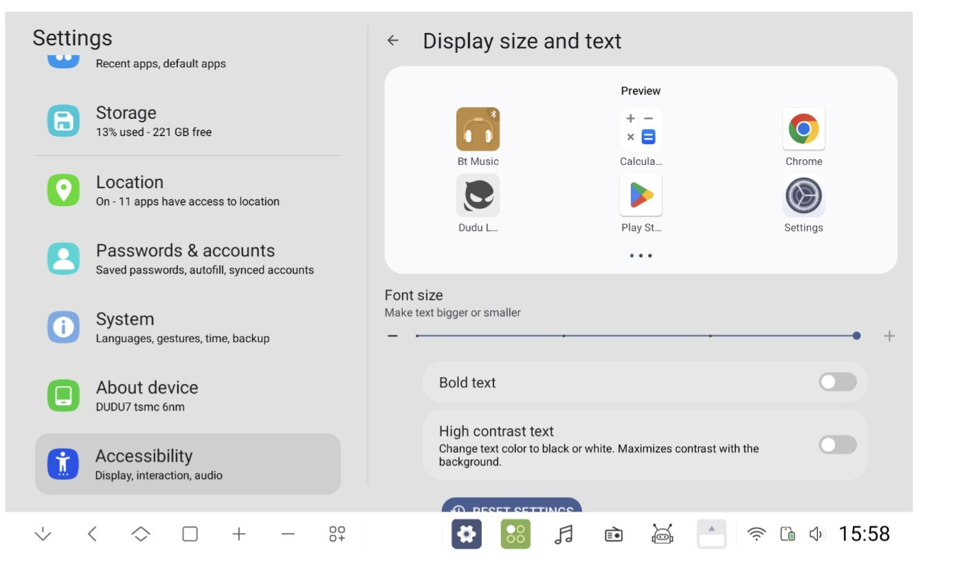

Previously, it was possible to set the screen size and the font size on this interface. After the update, only the font size can be changed minimally, which is not enough, since the letters on the 10-inch head unit are smaller than on a 6.5-inch phone (e.g. Waze, Sygic). Where can you adjust the screen size, because this is unacceptable???

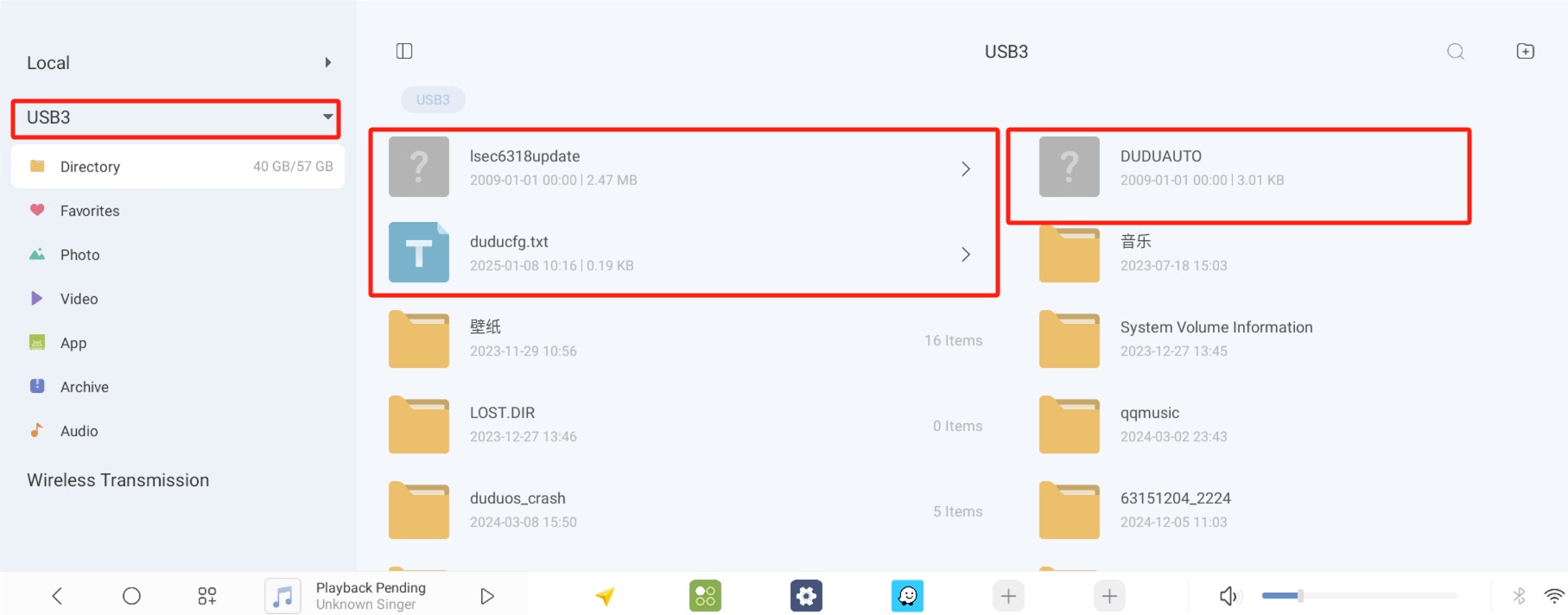

          Ojika
          Extract the files in the 7Z zip package to a USB flash drive, and insert the USB flash drive into the USB drive for automatic flashing.

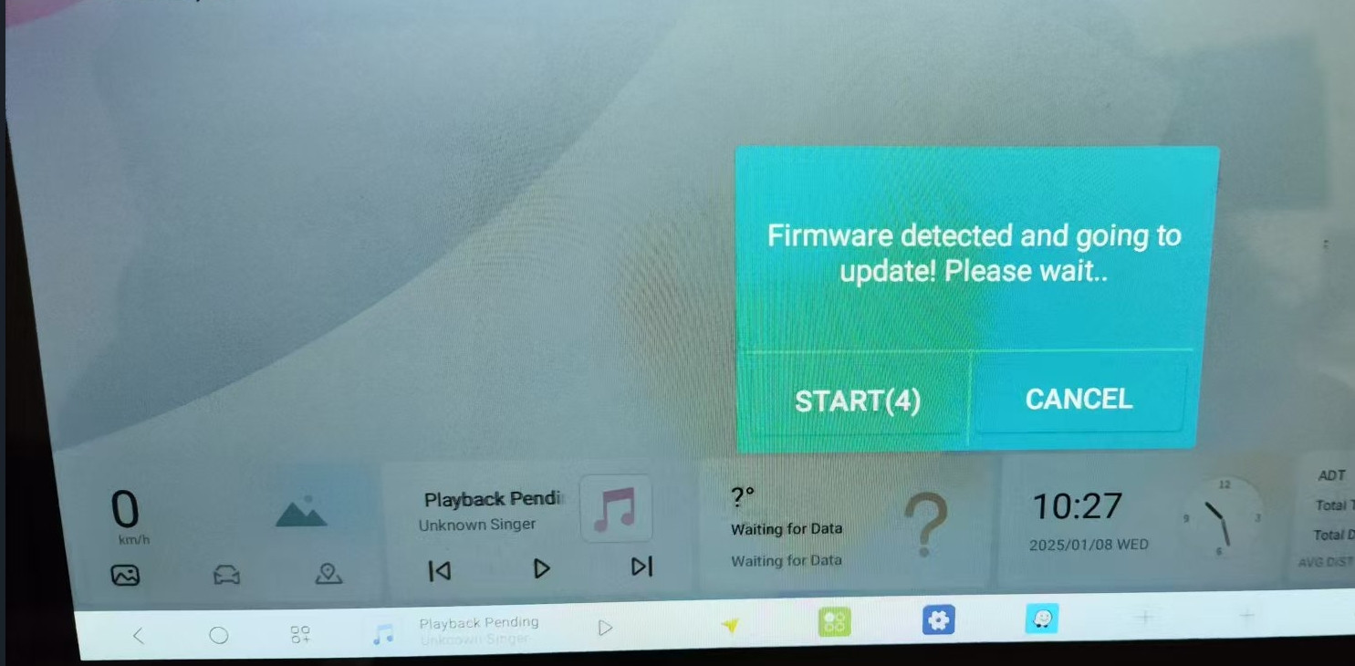

          Unfortunately, the screen resizing still failed. I really miss that after updating to 3.0, 3.5 doesn't support this, they just dropped this option. When I bought the Dudu7 head unit, I praised the product to many of my acquaintances and friends, who followed my example and bought one for their car. Together with me, they are now annoyed because the font size of the navigation is very small compared to the size of the screen. I also tried resetting the head unit to factory settings, but I couldn't restore the 3.0 version, I still can't change the screen size and resolution. I unpacked the zip file I received, tried to scan it from USB, but nothing happens. Why? Is it possible for the developers to correct this with a software update? I'm asking for advice that works because I have to use Waze navigation every day and I'm already thinking about putting my phone back in the car because the letters on it are bigger.
            Won't the flash drive automatically reboot and refresh after scanning?

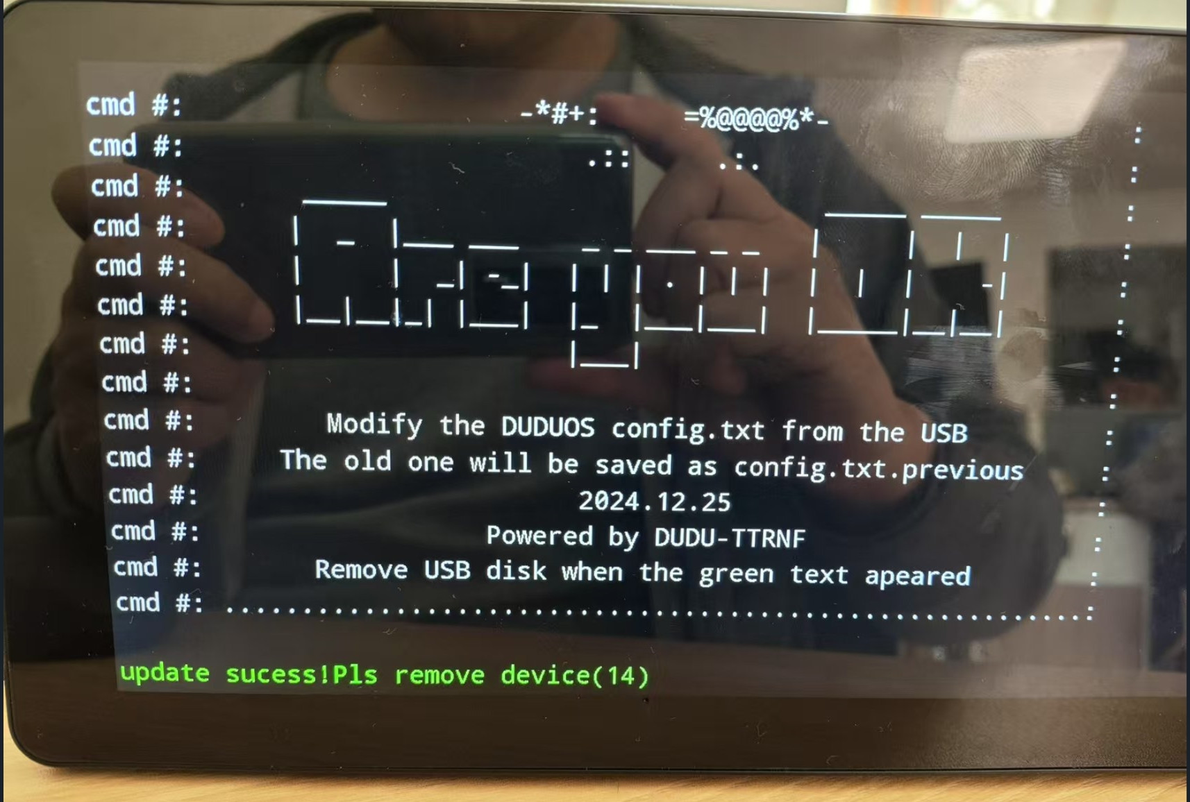

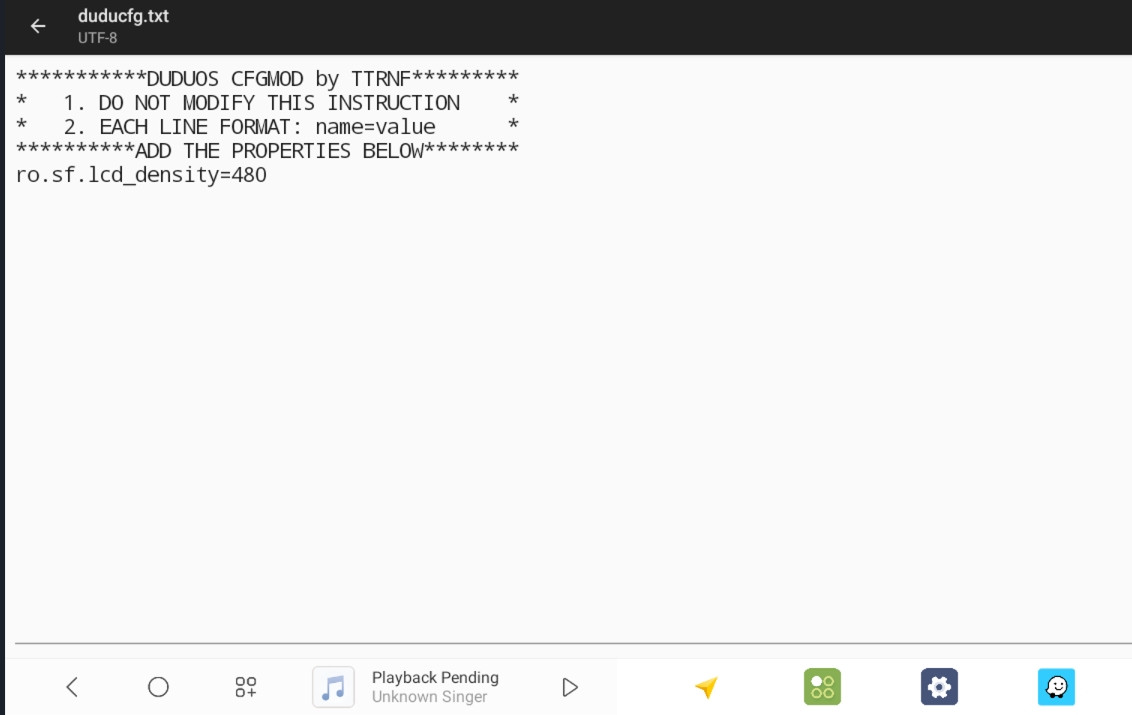

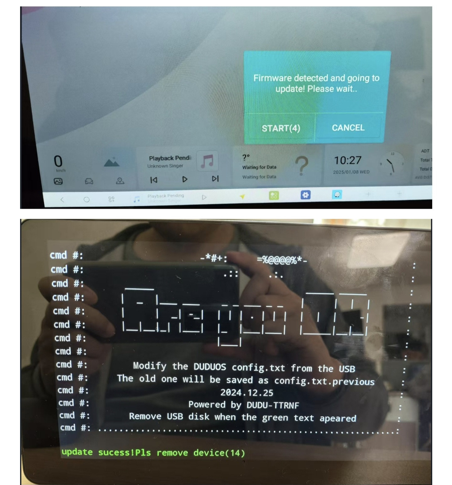

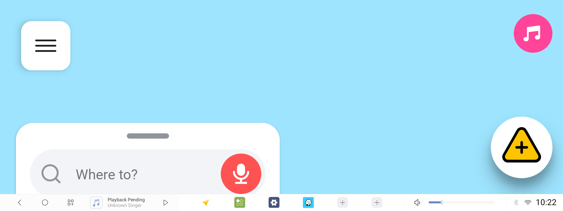

            Thanks for the useful information and photos. I replaced the usb drive and the installation was successful with the new device. I first tried 240 dpi, then 320 dpi, and finally 480 dpi, but the screen did not change, the small letters remained. I am sending photos of my head unit. What should I set the screen resolution to so that the font size is acceptable to me?

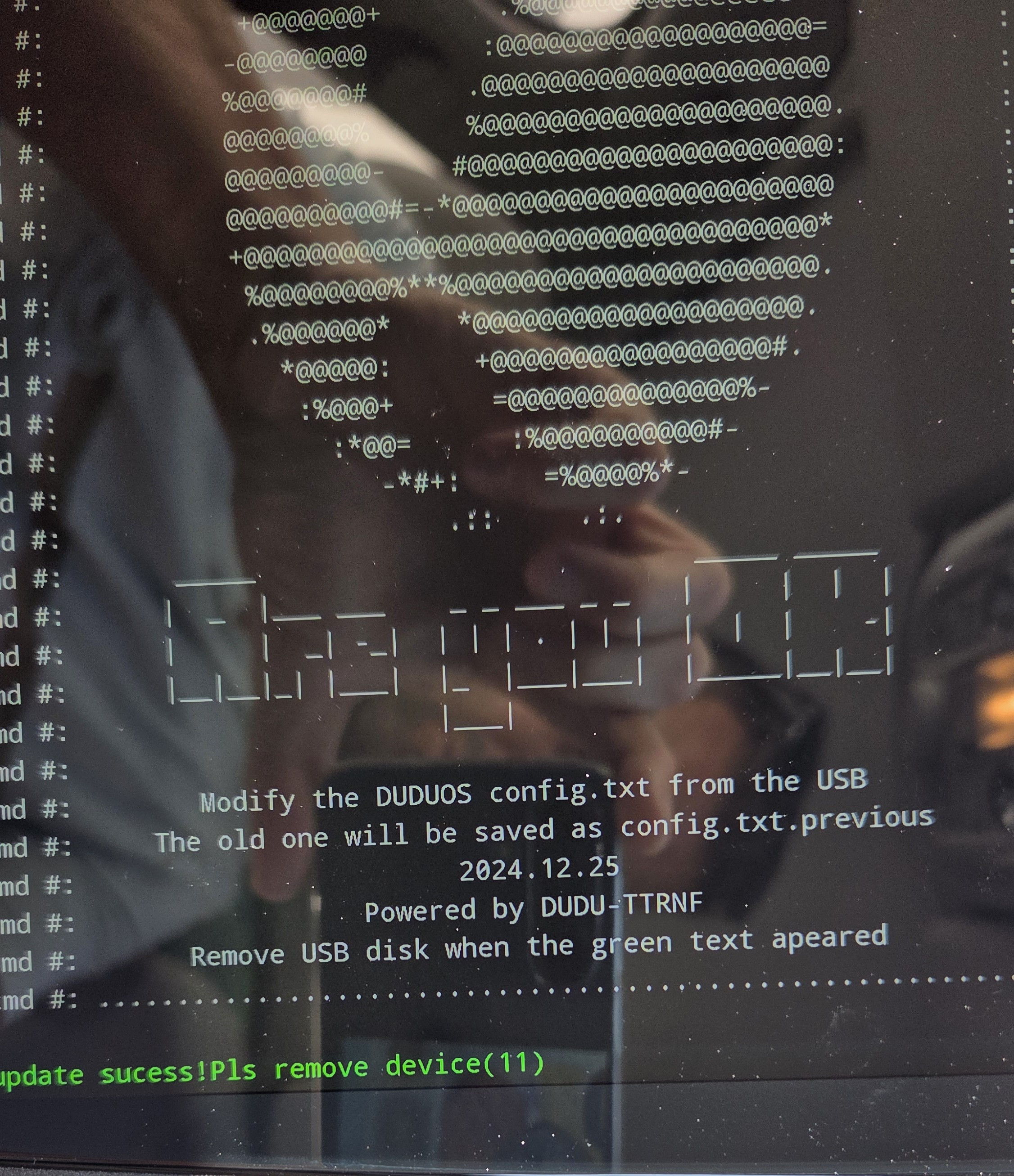

              After the flash drive is flashed, it will automatically backup the old (config.txt.previous) in the machine and open it with text to check the DPI value.
                DUDU-Meng
                I did not notice such a message. Copy this backup to USB? Where can I check? What dpi setting do you recommend for my head unit for larger font size?

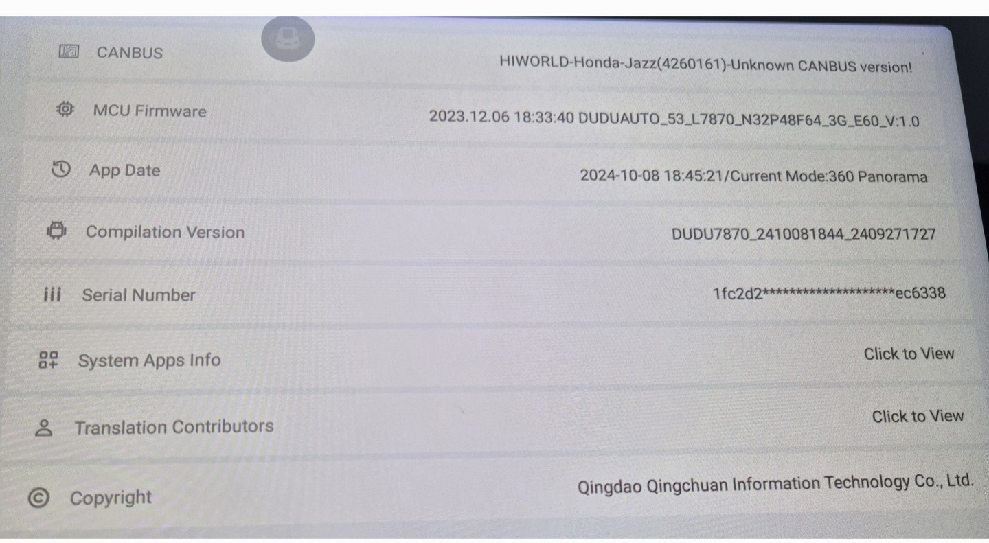

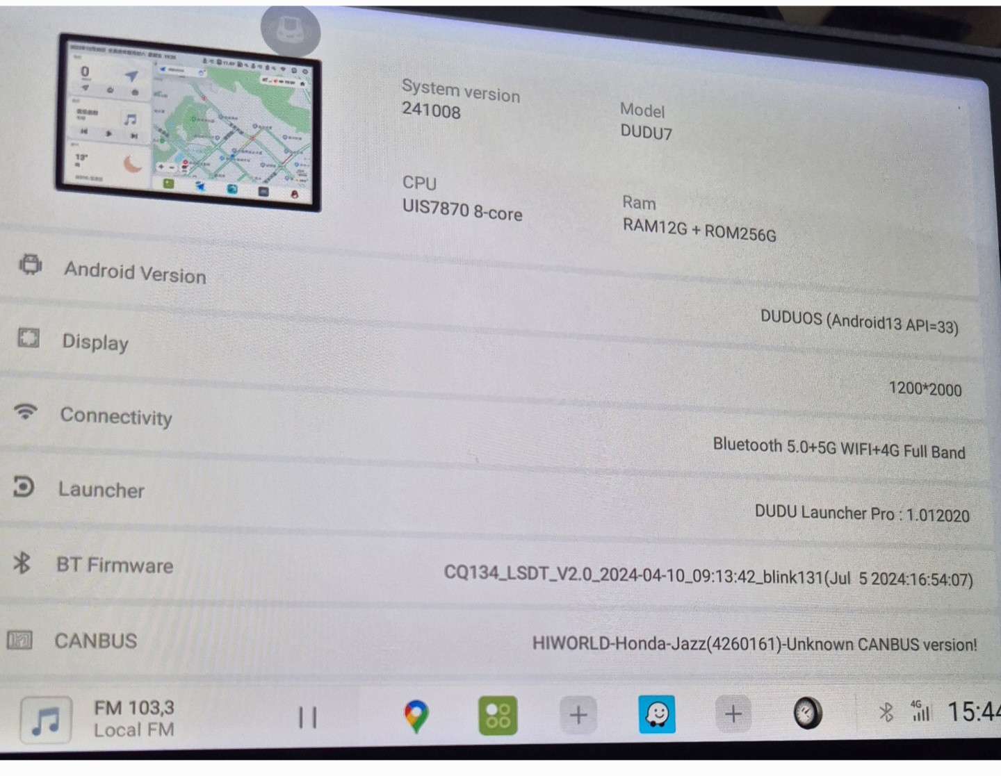

                  Ojika The version of the system in your unit is 241008?
                  This image was taken from OS 3.0 and has since been updated to OS 3.5. If it's important, I'll take fresh photos.

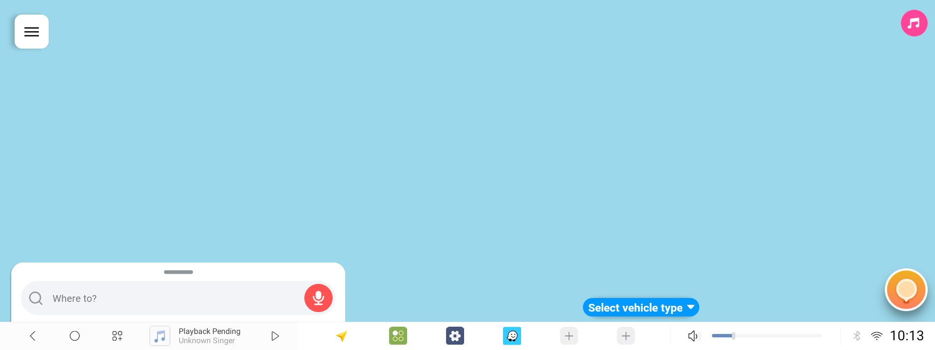

                  When I used version 3.0, after increasing the screen size, Waze's font size in the full-screen application was at least double that of the current one. I'm still using the navigation in full screen view, but the font size remains the original small size.

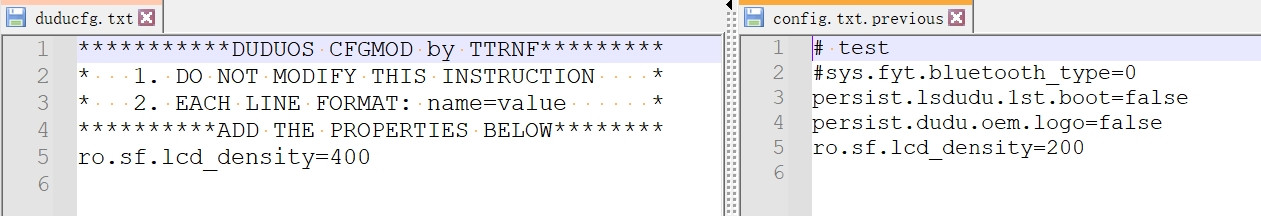

                    ro.sf.lcd_density
                    The default value for this attribute on my device is 200, but when I set it to 400, The DPI of the Waze has undergone significant changes
                    (The process of changing ro.sf.cd_density will generate a file named 'config. txt. previous', which stores the last value of ro.sf.lcd.density.)
                    The default value of this attribute on your device may be different from mine.
                    You can take a look at the values in the file config. txt. previous.
                    You can set the value of ro.sf.cd_density to be larger, and then try setting the DPI again through the above process.
