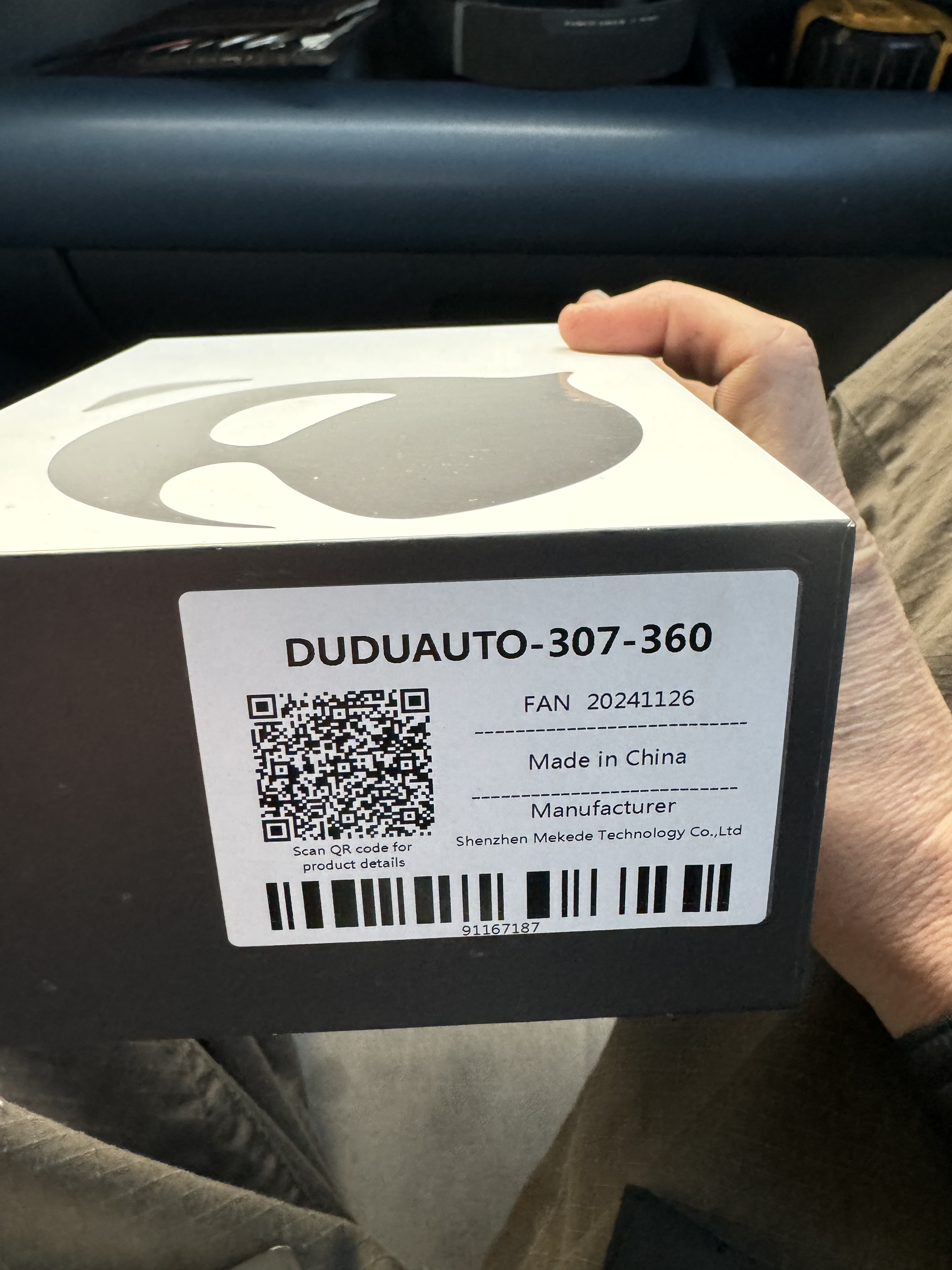

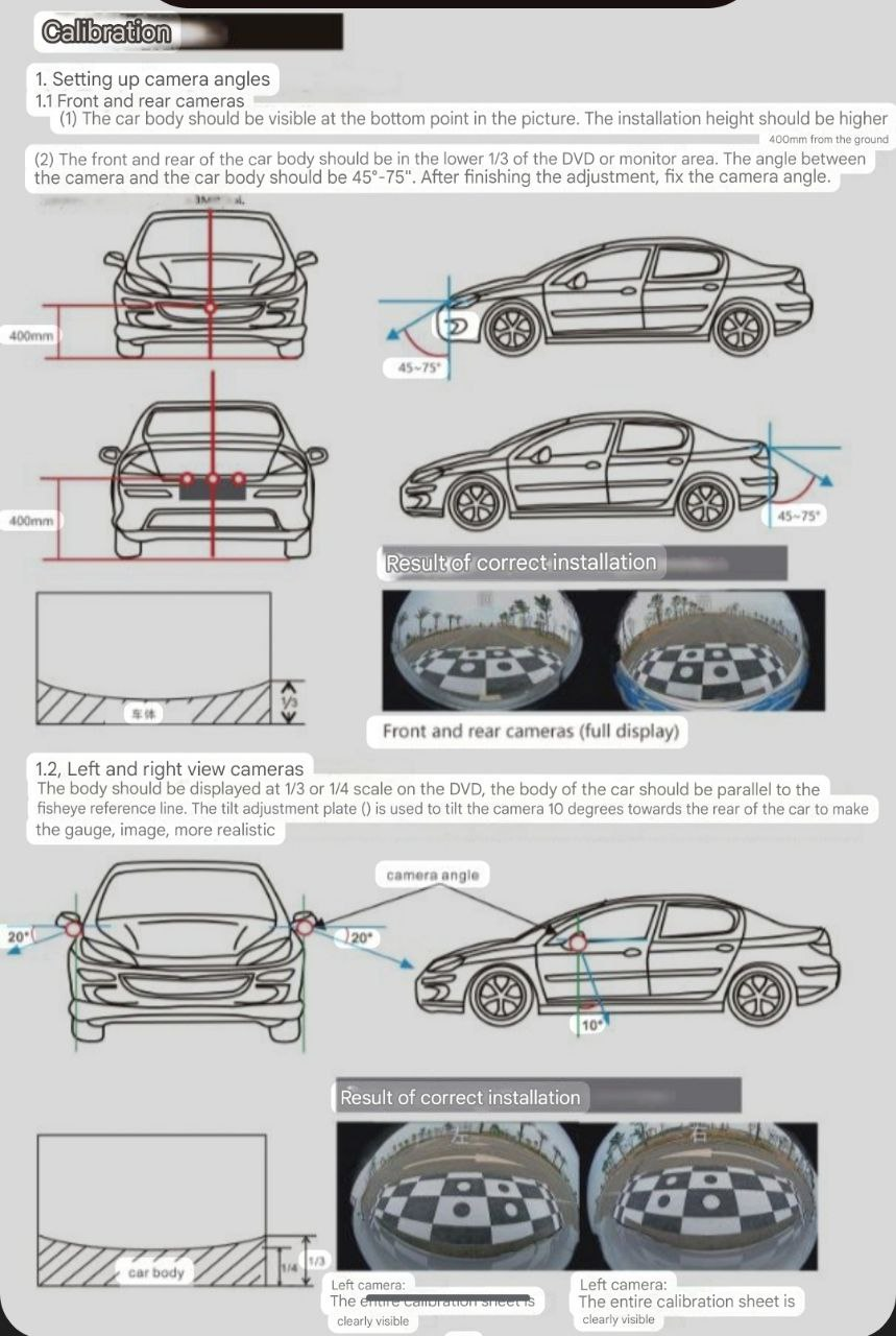

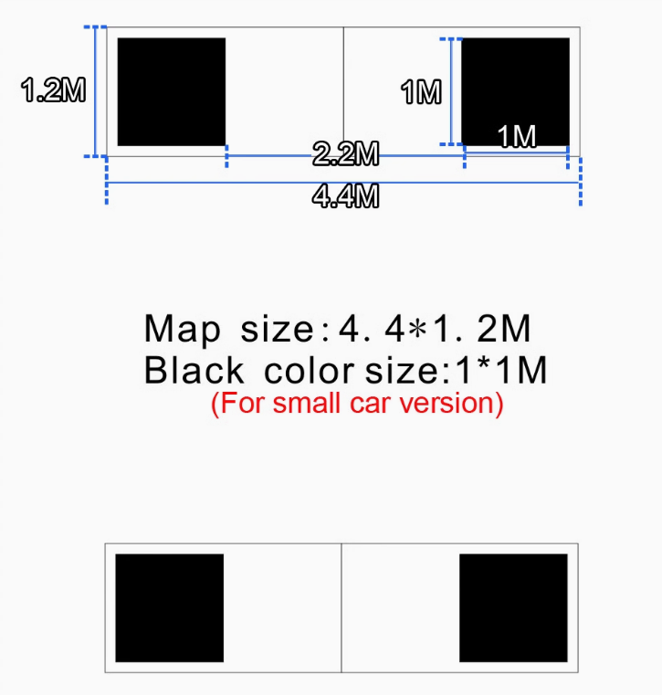

Alright I have the cameras mounted and fired up. Missing the calibration cloth. Which calibration cloth is best? Why isn’t this included with 360 cameras?🤨
