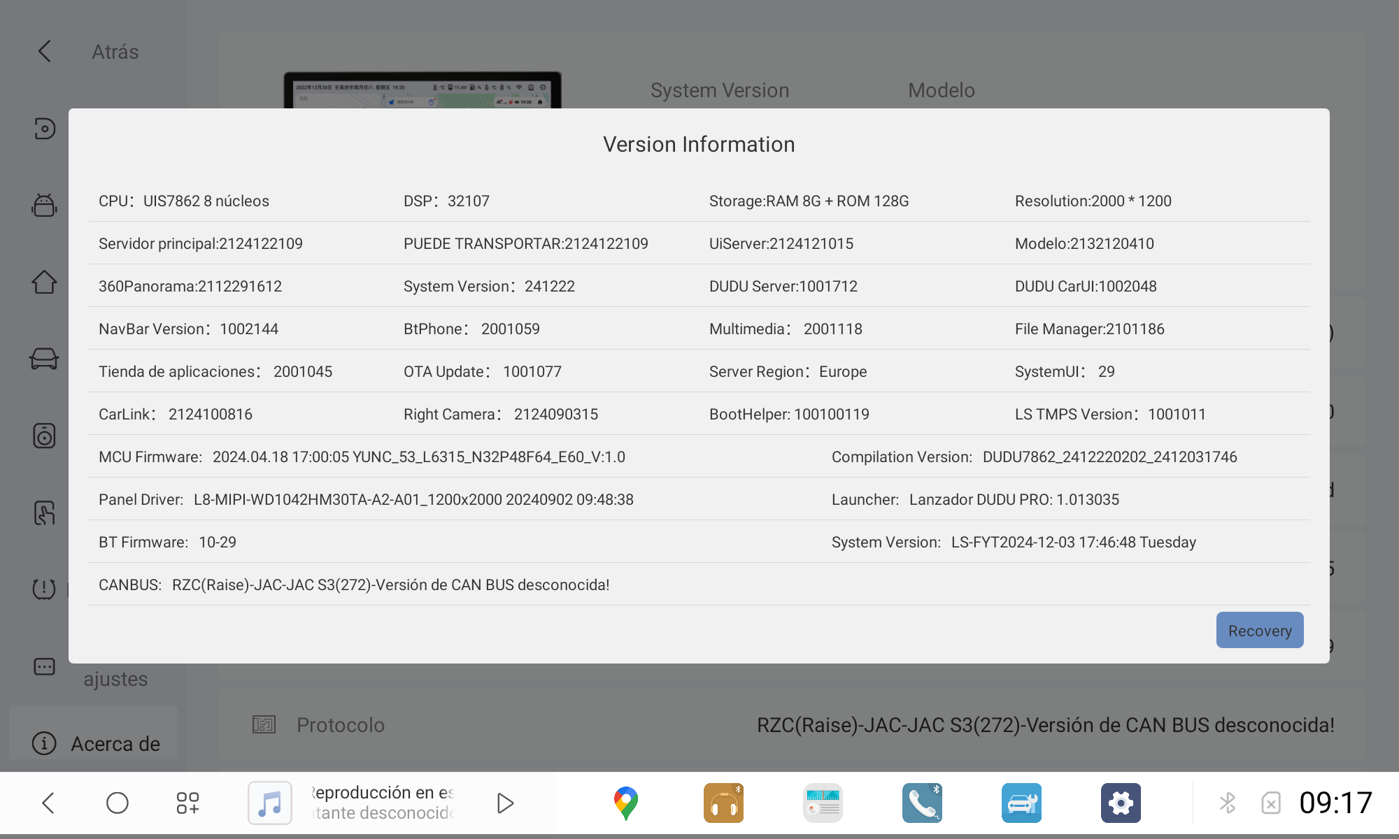

[2] Provide a screenshot of the system information and take a picture of the system information in the pop-up window by long-pressing on the top-left image for 3 seconds in “Car Settings”-“About”.
[3] Is it possible to reproduce the error and what are the steps to reproduce the error?
Yeah renaming the BT name on other Android settings... and testing turning off and on the vehicle
    surfer63
    sorry, this are my specs
