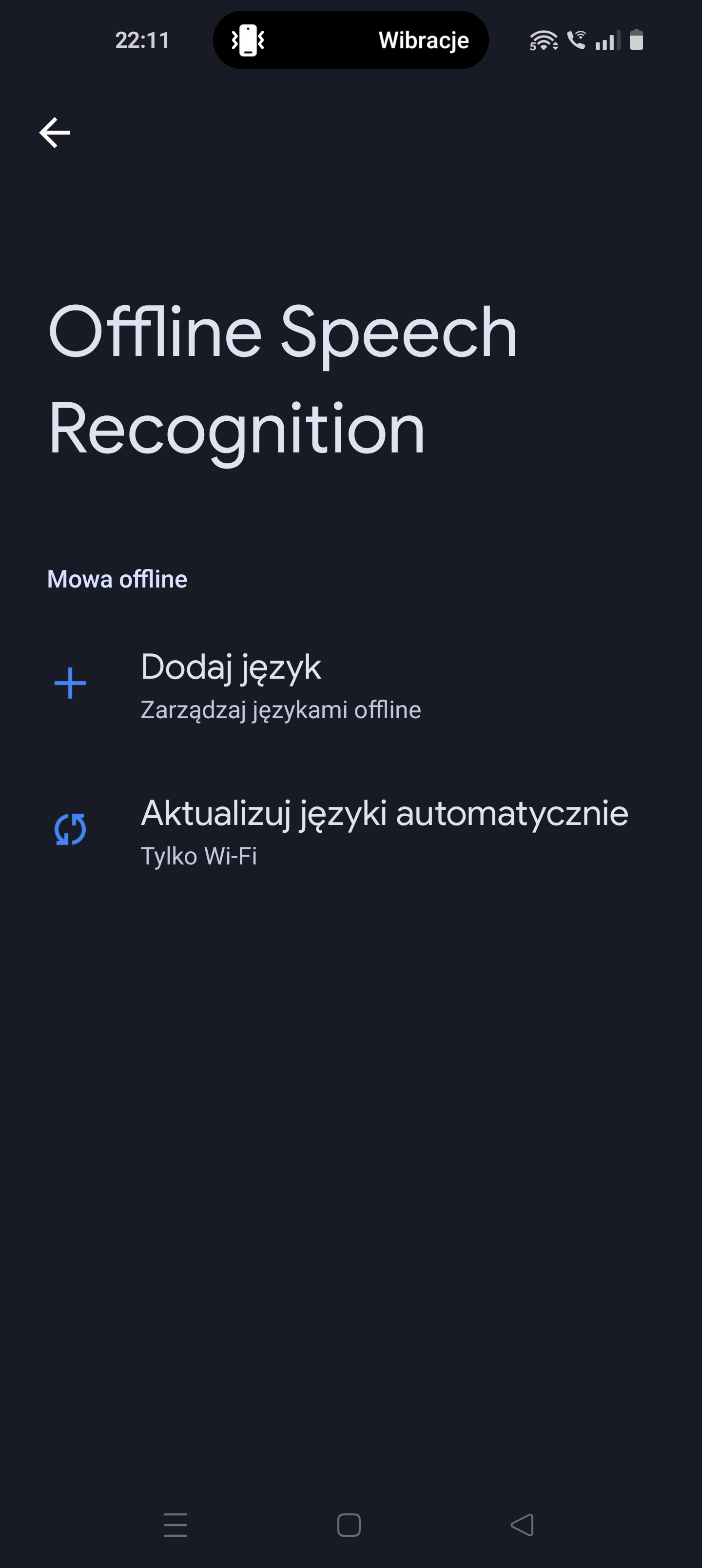

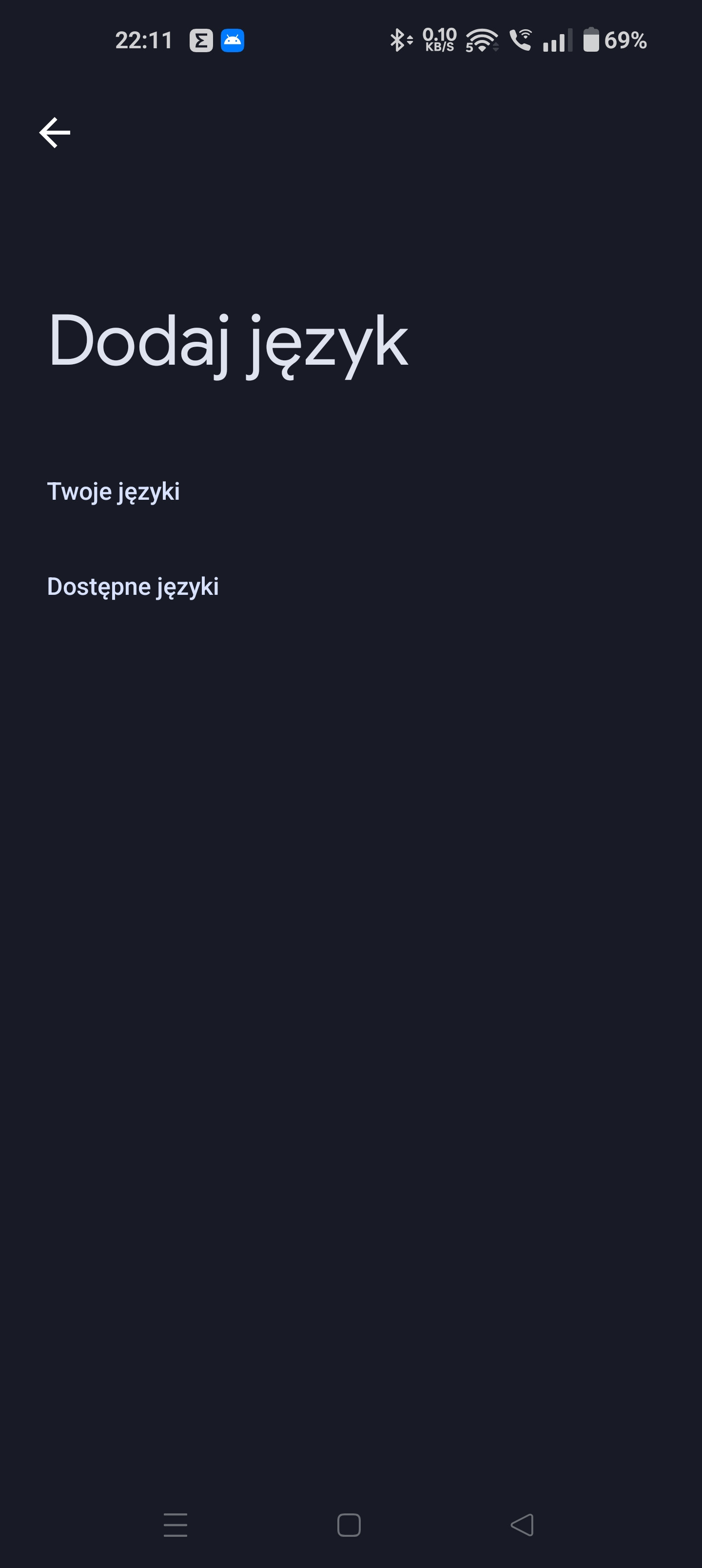

        I think I found the reason for the incorrect voice search. In maps, as I wrote after a factory data reset, the operation was correct, i.e. the system language is used. In the Google application as well. The problem remained in the Google Play Store. While browsing Google settings, I looked into Speech Recognition & Synthesis. In the downloaded offline languages, there is only English (US) and you can't download any other language, like on my phone. I decided to update the Speech Recognition & Synthesis application and after that, the Google Maps search in PIP was again in English. Then I uninstalled all Speech Recognition updates and I am again happy with searching in the default system language, even in the Google Play Store. Try it on your own and let me know. I did not install Google Assistant at all, after testing I only added Gemini.
        I think, that deeveloper should delete pre-installed English (US) offline language - this will be solution for everyone.

            Yes, on Dudu7 I only uninstalled the "Speech Recognition and Synthesis" app updates, that's all. Of course I checked the update of this application again, again during voice search in maps or in the Google Play Store the English (United States) language was used, which is the one integrated with DuduOS. I do not understand why this particular application makes a difference, because the problem is the English (US) language installed in the operating system visible in the Offline Speech Recognition settings, I also do not understand why the developers added this language, it cannot be uninstalled, and this should solve the problem for every device regardless of the version 7870 or 7862 etc.. I compared it with my smartphone, which does not have any preinstalled language and everything works as I set it. I want Polish - I have Polish, I want English - I have English or any other. As I wrote earlier, English (US) should not be implemented in the operating system, it should be removed in the new version. I hope that DuduOS developers look at these entries and fix this problem
